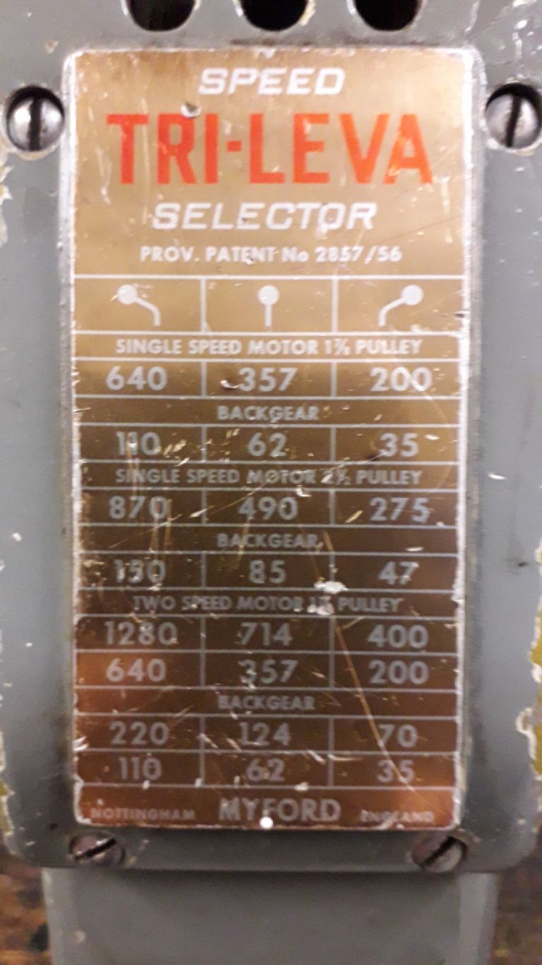

                                              The Tri Lever with the two speed motor seems to have a top speed of 1280rpm as detailed on the speed plate.
                                              Mike

                                                  Daren't comment on top speeds I use in case I get a visit from the 1000rpm Police.
                                                  However, this what Myford sold.
