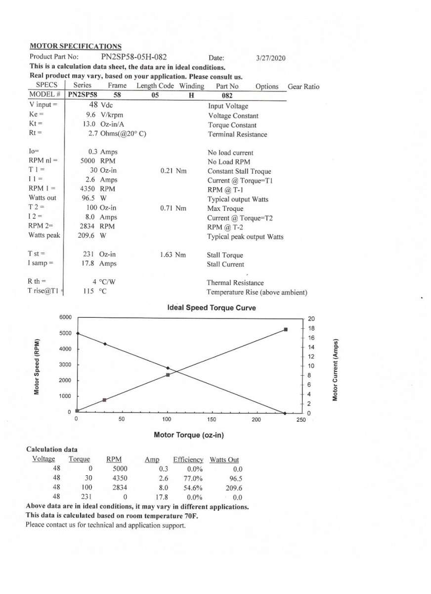

      I’m considering buying a Torkmotion brushed DC motor but I’m concerned about the spec sheet listed 115C temperature rise. I asked about this and was told, based on the specs, “the motor can cope with a continuous (ie all day long) current of 2.6A but it will get hot (115° above ambient), the speed at which you make it pull those 2.6A doesn’t really matter, be it 435 or 4350rpm. However, at 4350rpm and 2.6A (0.21Nm) your motor will put out 96W of mechanical power and produce (2.6*2.6*2.7=18W) of heat. At 435 rpm and 2.6A your motor will put out 9.6W of mechanical power but STILL produce (2.6*2.6*2.7=18W) of heat.”
      I like all the motor parameters except for the high heat and don’t understand the (2.6*2.6*2.7=18W) formula, but I would buy it if the temp. rise was lower, so I found an online watts to temp. calculator (https://calculator.academy/watts-to-temperature-calculator/) and entered the spec sheet thermal resistance 4C/W and 18W from the calculation above. The result was a temp. rise of 70C and I can live with that. Is the calculator appropriate for this application and do the results seem to be valid?
      torkmotion 48V

        Terminal resistance is 2.7 ohms. 2.6 squared times 2.7 gives power dissipated.
        #835876

          #835887
          Robert Atkinson 2
            @robertatkinson2
            There are multiple losses in a brushed DC motor. The resistance is the simplest to understand and is basically proportional to current. DC electrical power is voltage times amps. For this type of  motor the there are two voltages, the terminal voltage and the internally generated back EMF withis opposes it. The Back EMF if proportional t speed being zero at 0 speed and close to the applied voltage at full rated speed. It is not easy to separate the two voltages. Fortunatly the voltage across  a resistance is proportional to the current so we can determine the power in the motor resistance by multiplying the current squared by the resistance (i.e. multiplying the current by resistance once to give the voltage and a second time to give the power).
            Taking the given motor specification wih an applied voltage of 7V the motor will deliver full torque (230 oz/in) at stall (zero mechanical power)  and dissipate 18.25 W and reach a temperature of 73 degrees above ambient.
            At full input voltage, speed and torque (209.6 W mechanical power) the resistance will dissipate  the same 18.25 W . The dathseet says it will get to 115 degrees hotter than ambient. This implies 28.75 watts dissipation (115W / 4deg/W).
            This leaves a “missing” 10.5W.This is accounted for by other losses. Mainly magnetic “eddy current” losess but also mechanical e.g. bearings, brush friction etc.
            The data sheet is comprehesive as it’s servo rated motor.Srrvos will sit at full torque and zero speed in a lot of positioning applications which is why this is important data.
            It will only get that hot at full current and it is unlikey that you will be running full current all the time.
            Robert.

                      A thanks to all for the info. And I gather that the calculator I used and the results are valid. It seems to be a good match for a watchmakers lathe so I will buy it.
                      #836044
                        It is a good match.  The motor is rated at 96W continuous, which is all you need to know.
                        The 115°C figure refers to the hottest part of the motor, which is the copper windings inside, not the outer case.  As modern enamelled wire is good for between 180°C and 240°C, maybe more, the table quantifies the motor’s thermal safety factor, which is fine.   It will confidently deliver 96W out continuously without damaging itself.
                        Remember manual lathes never run continuously.  They have a “duty cycle”, which is the ratio between time spent working and time stopped. Idling also allows the motor to cool.  So it won’t get hot if the machinist drives the lathe moderately in short bursts.  Short of abuse or a major fault, unlikely the outer case of this motor will get anything like hot enough to boil water.  If it does, something is horribly wrong. The case is more likely to feel warm rather than hot unless a lot of metal is cut quickly,  Unlikely to get too hot to touch when driven by a watchmaker. A watchmaker’s lathe is a precision tool, not a chop saw.
                        Big lathes often work much harder for longer than small ones. Hard continuous work heats the motor and they don’t get much time to cool. Worth fitting a fan.
                        Good to apply due diligence when buying a motor, but specs are most valuable when the requirement is known.  That is, how much work is the lathe expected to do in what time? I’m guessing a watchmaker’s lathe will do watchmaker’s work at watchmaker’s rates.  If that’s wrong, ask again!

                          This is from the 3rd reply “Taking the given motor specification with an applied voltage of 7V the motor will deliver full torque (230 oz/in) at stall (zero mechanical power)  and dissipate 18.25 W and reach a temperature of 73 degrees above ambient.”
                          The spec lists V input = 48V. What is the formula to calculate applied voltage, that resulted in applied voltage of 7V?Thanks

                                Sorry I wasn’t clear,  Perhaps I should have put increase twice:
                                So at 115 degree increase by 45% to 3.9 ohms. This is a power increase of 18W at 2.7A. Note the motor current is 2.6A and resistance is 2.7 ohms
                                Robert.

                                  Noting the discussion around resistance change with temperature the 7 volts comes from Ohms law
                                  2.7 ohms times 2.6 amps = 7 volts. That is the voltage required to pass 2.6 amps. WITH THE MOTOR STALLLED.
                                  If the motor is running you have to add the back EMF (“generated” voltage) which is proportional to speed. This is designated Ke with a value 9.6V per 1000RPM (from datasheet).
                                  48V -7V = 41V 41/9.6 =  4270 RPM
                                  This is slightly different from the datasheet no load RPM (4350) as I’ve not allowed for the no load current and other minor details)
                                  Robert.

                                    It is the “at 115 degree increase by 45% to 3.9 ohms” that I don’t understand. How do arrive at that?
                                    Most metals resistance increases with temperature “temperature coefficient of resistance”
                                    The temperature coefficient of resistance of copper is + 0.393 percent per degree C change.
                                    The motor winding resistance at 20 deg.C is 2.7 ohms (from datasheet).
                                    Temperature increase is 115 deg.C (from datasheet)
                                    0.393 x 115 = 45.2% increase. 2.7 x 1.452 = 3.92 ohms.
