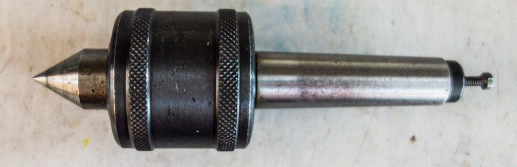

              Not quite your problem maybe but my rotating centre was too short to be ejected by my S7 tailstock.
              The small bolt loctited into the end works just fine.
              Ejecting short taper
