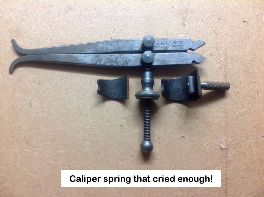

                          OuBallie
                            @ouballie
                            Stub Mandrel Neil,
                            Snap!
                            Had this happen after cleaning using molasses then paraffin. As yours, a gentle 'ping' and it fell apart.
                            Inside caliper
                            Snap again!
                            My welding would do far more damage than fix.
                            Geoff – Feeling so much better after 40 winks in armchair. What can I say!
                            #159403
                            Peter Tucker
                              @petertucker86088
                              Hi Geoff,
                              Don't even think of welding that spring. I had a similar break and fashioned a replacement from some hi-tensile steel pipe which, when hardened, proved to be perfectly adequate.
                              Good luck.
                              Peter.

                                #159436
                                OuBallie
                                  @ouballie
                                  Fear not Peter, I have absolutely no intention of welding it, not even with TIG.
                                  The parts are with the other tools that went 'ping' as well.
                                  What piping are you refereing to?
                                  I don't need the caliper, but it would be my first attempt at making a spring of this shape.

                                    Paul Tummers
                                      @paultummers57940
                                      When you have a piece of high tensile steel pipe that matches the dimensions of that spring, I do not see any difficulty in making one, before heat treating it can be turned, filed and drilled without any problems.
                                      Only thing is, make sure, there are no scratches left in the inner/outer surface because that is asking for breaking, I got some experience with this in gunlock springssad.

                                                  Peter Tucker
                                                    @petertucker86088
                                                    Hi Geoff,
                                                    I have some scraps (all my material is scrap) of galvanised hi-tensile steel tube (looks similar to but thinner wall than galv. water pipe) salvaged from when I was building plastic clad green houses. I realise this material may not be readily available to many people but is worth wile looking out for to use in some small demanding jobs.
                                                    My apologies to all for off topic posts.
                                                    Peter.
