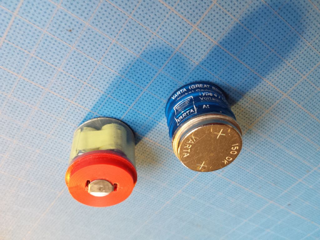

                          Hope, somebody will have an answer for me; I already mailed Moore & Wright about this but got no answer.
                          I happen to have one of those old digital Micro 2000 micrometers, the battery needs to be replaced, who can help me out with a source for this?

                                      #159221
                                      Paul Tummers
                                        @paultummers57940
                                        The battery are 2 stacked coin cells, each stack is built-up from 2 coin cells in crimp-foil. On the foil is printed HW1 70K2L, 2.4V , 170 MAH.
                                        #159222

                                                  Ian P
                                                    @ianp
                                                    I have a M&W 2000 micrometer in perfect working order apart from the battery.
                                                    Batteries are a difficult problem to solve for this device, The original size of NiCad (or NiMh) button cells are no no longer manufactured. Because of the housing construction there is no room for anything larger in diameter, its one of those cases where you can't just squeeze something even a little bit bigger in!
                                                    Off hand I don't remember the exact diameter (22.6mm maybe) or the A/h rating but using much smaller diameter button cells will probably mean the existing charger is too high a current to leave connected.
                                                    I made a replacement battery pack using four cylindrical cells that I removed from a rechargeable PP3 battery. Again I don't remember what rating the PP3 was but it does work in my micrometer. Because the PP3 I used was old (and not been kept charged up for more than 8 years!) it will only power the micrometer for about one hour. I intend to purchase a new PP3 and rebuild the pack.
                                                    You can just make out the 4 cells in the bit of plastic packaging I used to make the casing. I have no idea why the picture is head over heels (its fine on my PC and I've done this image the same as all others I upload) but I assume it this site software!
                                                    Ian
