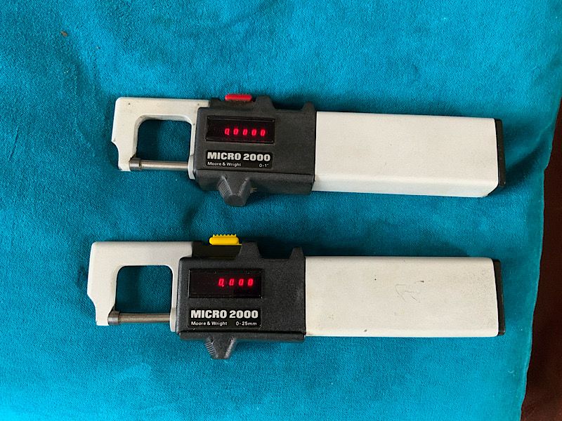

        Update; This morning I received the batteries . I simply could slide off the plastic sleeved frem them, remove the pins were necessary- left one pin at the + and one at the – and bent those backward and the package slid without problems into the battery holder of my Micro 2000. switched it on and it worked!
        Next thing is to find out about reloading them when empty, perhaps the with the micrometer supplied charger will work?

            What I have bought are 2 VARTA ,Ni-MH ,2/V250H ,+2,4V cells.There is a green hard plastic cover around the 2-cell packs that easily slides off in one direction. With the cover on, the diameter is slightly too large.

                I just received 2 new batteries today from “all batteries” for my 2 micro 2000’s
                these are a direct replacement but lithium ion
                cost £20.30 for 2 delivered
                anyone any idea how long I should charge for and is it ok to keep plugged in when not using?

                  If anyone needs new batteries they are
                  Varta
                  4/v250H
                  4.8v 250mah
