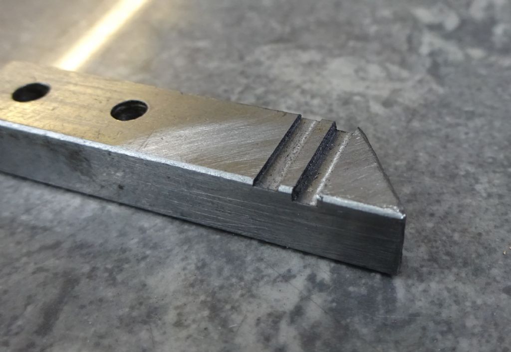

                          That's another reason I don't bother with charts – you are not stuffed if the size you want isn't on the chart. Anyway with no speed readout on my X3 it's all a bit finger in the windsmile p
                          Thought I'd give it a go for you, used ketan's SX2.7 as that has a speed readout. Speeds and feeds as I said above but did not have a 2-flute so this is with a 3-flute, two you could up the speed and or lower the feed to keep a similar loading per tooth. Feed screw is 2mm pitch if you want to work out exact feed from my hand movements.
                          Not too shabby, single pass on left, two passes on right.
                          If your cutter is a 50p Bangood special then all bets are off.

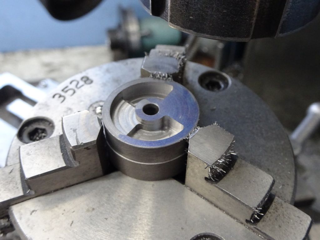

                                  Just so happened to use the 2mm cutter last night on some cast iron, similar sort of speed but 1.0mm DOC, feed a bit of an unknown as cuts were on the R/T. Deep pockets are 4mm.
