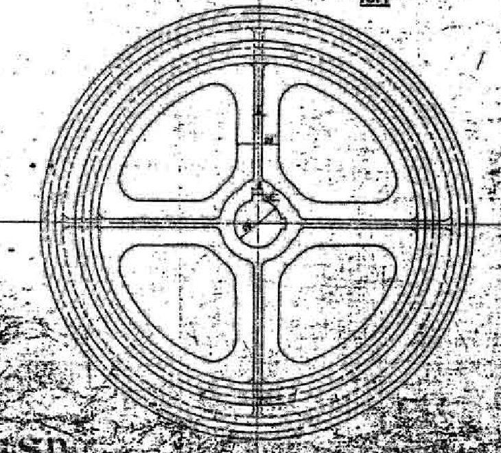

        Hi, does anyone know how a flywheel would have been retained in place on a full sized compound marine engine. Keyed yes, but how was it held in position laterally.
        Any help or knowledge would be most appreciated but I'm afraid in this instance a grub or set screw simply won't do wink
        Thanks in advance – Tug

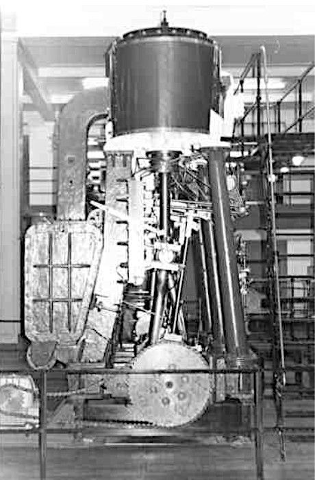

                    This is the crankshaft end of the triple expansion engine from the TS Glen Strathallan. Long time since I was a cadet on board and can't remember what went where but the flange is there. The picture is in the Science Museum where the engine ended up so they have used the flange with a chain wheel to provide a drive for the display. Cant say I'm impressed by the chain tension!

                            Flywheels were also fitted with 2 taper keys, spaced at 90 degrees to each other on on some early steam engines to give a more secure mounting.
                            Paul.

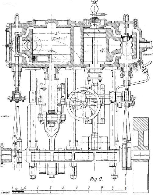

                                  Ramon, a tapered key and mating keyway would be one way to keep it on the shaft. Text does mention two tapped holes into the end of the (slightly shorter? ) crankshaft and a disc to retain the flywheel. Whether that was usual practice I don't know.
                                  Hard to know if the original may have had a flange and it was just omitted to save having to make split eccentrics as you can't slide them onto the shaft if there is a flange in the way
                                  This is the engine in question for those not familiar with the design, full size was about 8ft tall and 5ft long.

                                              In the end it may well come down to what is going to allow the model to tick over smoothly on air as you will not have a prop and shaft and presumably a thrust box to smooth things out. There is also the lack of expansion from running the compound on air to further complicate things.
                                              Prestons has a few engines over six pages of similar size that may be worth a look through , this Thornycroft on the last page is probably the clearest flange mounted flywheel and also about the largest diameter though it is quite narrow. There are quite a few more engines with more compact ones complete with barring holes.
                                              If all else fails Ramon you could keep the flywheel in place with your favourite JBWelddevil

                                                Had a look at my American Marine Engineering Book circa 1945.
                                                Volume 1 describes the US Maritime Commission Engine of 1940 in considerable detail. Quite interesting – it's the Triple Expansion Steam engine used to power Liberty Ships. Rationale almost engineering firm could make them, and reliable simplicity, not high-performance or fuel economy. Goes on to describe Woolf Engines, Lentz Engines, Steam Turbines and Maritime Diesels. None of these engines have flywheels.
                                                However, Volume 2 has a section on vibration, and mentions flywheels as a way of controlling it. My idea of a flywheel is a hefty beast designed to store a lot of energy to deal with varying loads. Not how this book sees them. Small, if used at all, and intended to deal with resonances.
                                                Looking at the engine plans in Volume 1, although they don't have separate flywheels, they do have heavily weighted cranks. Although the main purpose of the weights is balance, they would also have a flywheel effect, maybe sufficient to not need a separate flywheel at all. There are also features like the engine / propeller-shaft couplings that must act as small flywheels. The reduction gearbox on a steam turbine looks like a hefty flywheel – might take a turbine ship a few miles to stop!
                                                Mill engines and pumps see varying loads and for them a big flywheel must be very helpful. Maritime engines don't have the same need for a flywheel because they deliver power into a steady load for weeks on end. I suppose a ship engine's worst nightmare is when the propeller dips in and out of the sea during a storm.

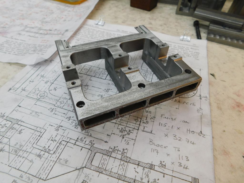

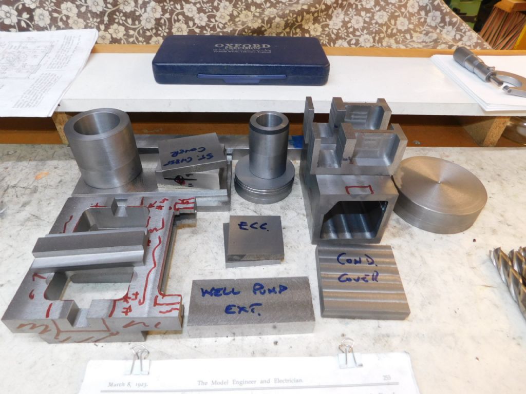

                                                      It is my intention to have a thrust bearing installed and possibly a stub shaft with a propeller fitted but that's a long way off as yet.
                                                      The engine parts are being machined from cast iron bar stock and like the double ten cylinder done some time ago will be of composite construction using JB Weld to hopefully create the effect of castings. Here's the major parts roughed out ready to go
                                                      I made a start this week beginning with the base – from a solid slab of cast this was after yesterday's session
                                                      There's a fair bit of swarf come off of there so far and still some to come!
