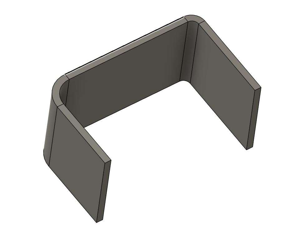

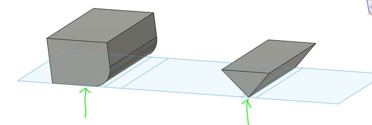

              The free version of F360 places a line in the middle of the bend which is where you would place the middle of the Vee knife on a press break. It will work out all the various allowances etc for whatever bend radii you want.
              The U shape below with one bend using the material thickness (2mm) as the radius for one bend and the other at 6mm. It is 50 x 30 overall but as you can see the material is not 110mm. If I wanted I could place a dimension at the start of the 6mm radius bend which would be better if bending over a former. So position is really determined by how you intend to bend the part.
              fold1
              fold2
              fold3
              #840731
                One more to illustrate position depending on how you are bending. For the 6mm if you had a suitable radius on your press you would then use the ctr line not the start of the bend
                fold4
                So to answer the question:
                The ctr line is used if bending with a press as you will then get an equal amount of radius either side
                The start is used if bending over a former as you will then get all the radius to the side of where you start

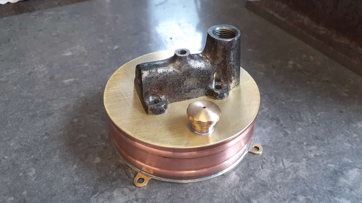

                              As an example the rectangular water hopper sitting ontop of this hit & miss engine cylinder had the top, sides and bottom bent from a piece of 20swg CZ108 brass, joint centrally at the bottom. End plates were from 3/16″ CZ121 rebated to form a spigot to hold them in place during silver soldering. Top ring and lower neck soft soldered.
                              I don’t have a 3in1 type folder so started my bends at teh edge of the allowance using two pieces of angle iron, one having the required internal radius filed on teh corner. Pushed down with a block of wood rather than hammered.

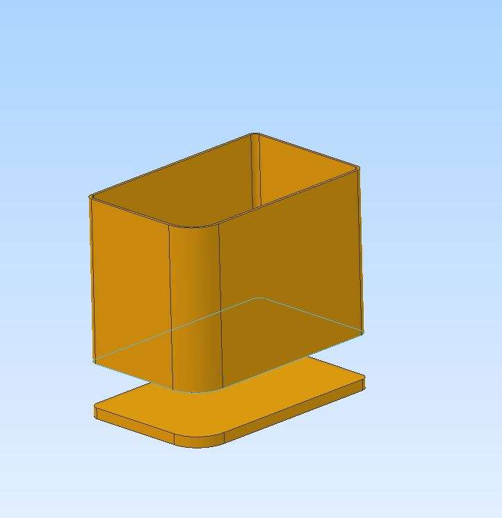

                                  Ah, I was not allowing for so much thread drift. Silly me looking at the title of “Box” and then reading the sizes did not bring aero to mind. The stated 2mm thickness of the tank bottom also tends to eliminate the OP’s need for lightness.

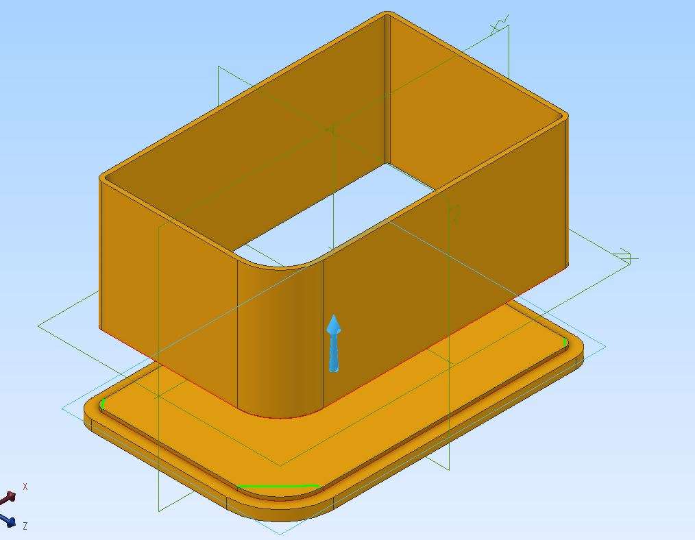

                                  Assumed height but something like this is what I understand the OP wants. Probably a top plate too.

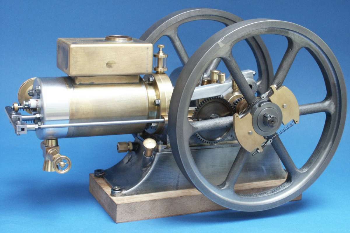

                                    Jason your drawing is spot on.  It is for a stationary engine, Jan Ridders Flame Licker and whilst there are easier methods to create a fuel tank that would serve the purpose, I wished to try and challenge my skills and learn something new.  The brass strip I have is 0.64mm or 0.81mm thick (can’t check at the moment).  And will check type of brass – I have a number so at least some practice material.
                                    #840897
                                      So a bit shorter than I drew and with protruding top & bottom plates, the tank in question for anyone not familiar with it.
                                      https://www.ridders.nu/Webpaginas/pagina_happer_inw_schuif/inw_schuif_frameset.htm
