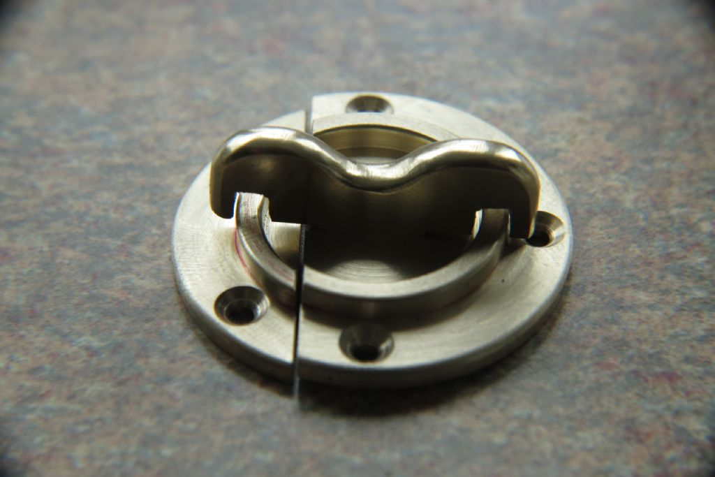

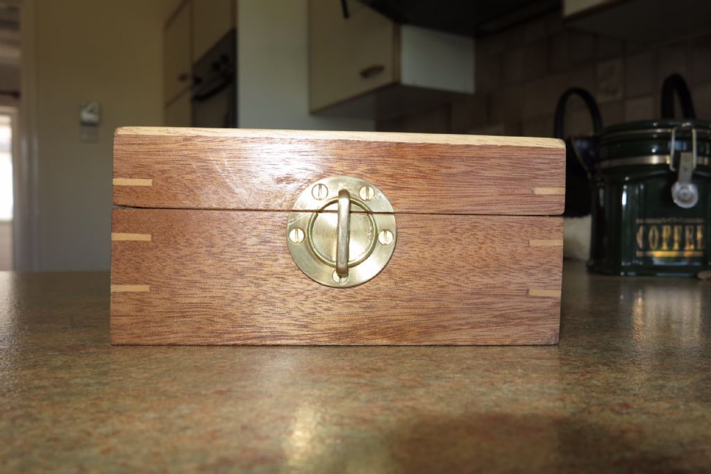

                    Try this one,I have made Guys catches but find them a bit of a PITA.

                      Sorry the phots have disappeared, will have another go
