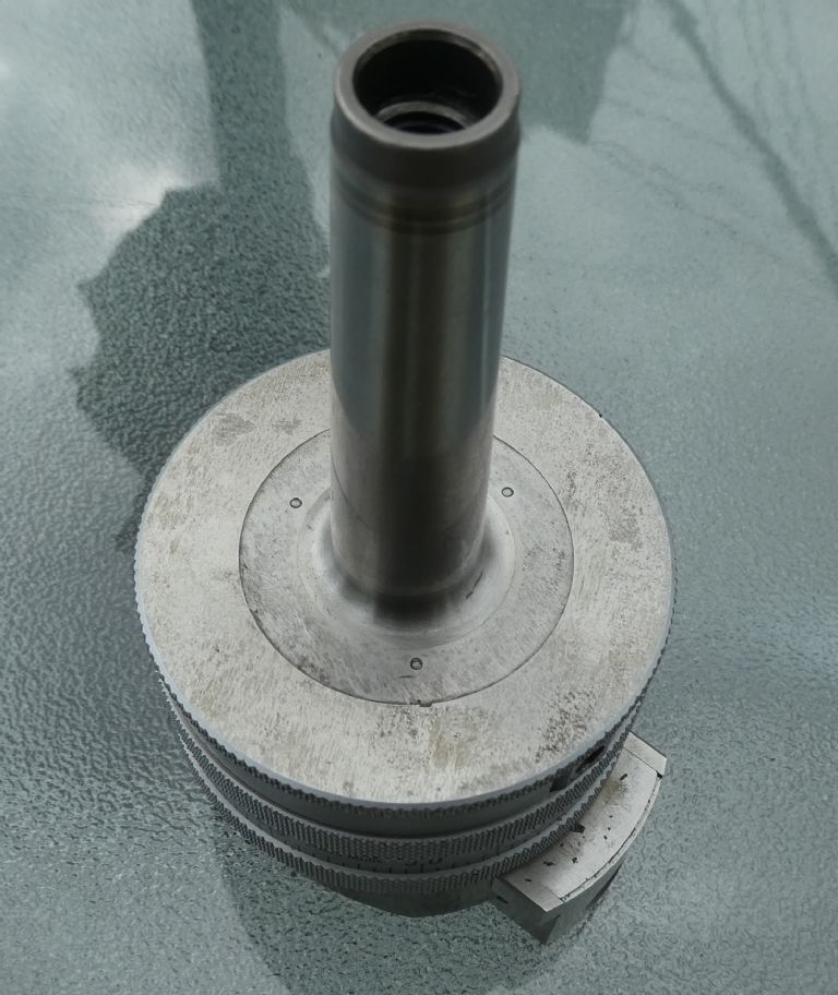

        Good evening all!
        Magpie that I am, I was unable to leave this on the shelf of a junk shop some while ago, and it's sat on a shelf in my (junk) shop ever since, gathering dust as you can see. I've never used it, but only because I've got nothing with a corresponding socket, and can't quite bring myself to modify it.
        The threaded portion is M16 x 2.0, and the register just to its left is 17.94 dia. The minor dia of the taper is 19.24 and the major dia is 25.58 (all in mm). The length of the taper along the centre axis is approx. 24.8 mm as near as I can measure it.
        What does it fit into?
        Thanks, as ever, for assistance!
        Best rgds Simon

          The male screwed part isn't (well shouldn't be) part of the plug. You should find it is screwed into the taper. The short parallel bit makes it an ISO or INT taper rather than the BT version though they all have the same angle. It looks like an INT30 but the widest part of that taper is 31mm. Is here some more 'inside'? It would possibly bottom out as is. The taper length is 47 so you are well short.
          There is an INT20 size but it is infinitely rare, I've only heard of it being on one grinder head. I happen to have one example owing to it being incorrectly described on ebay. #

                    Simon, used these quite a bit in the 60's 70's and Mose had a detachable taper screwed into the body so the business end could be fitted to whatever taper the customer required.
                    Look carefully befor attempting to remove the taper but I think it will be removable, they are very difficult to see and join. I have a very small one and my son has two different larger ones all have removable taper fittings.

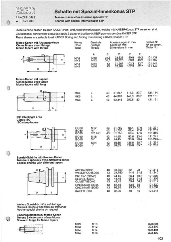

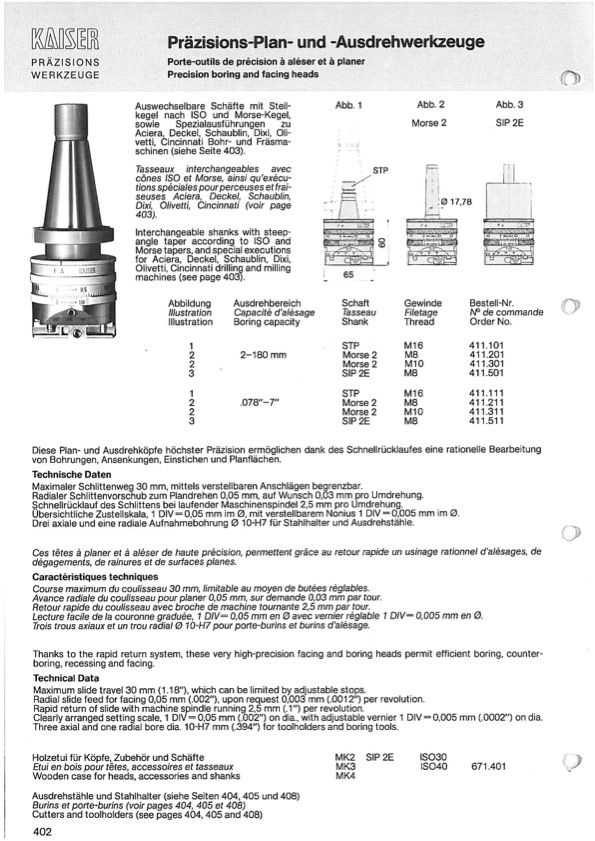

                            The head is screwed into the arbor clockwise so boring anticlockwise could result in some interesting times. I have a Kaiser Piccolo boring head in pdf format but i dont know how to attach it to this thread.
                            #557359
                            Terry Chandler
                              @terrychandler21294

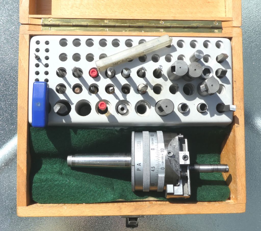

                                Simon – Hope you can make use of it. I have the Model PA with an MT2 shank which I bought for peanuts. A superb piece of tooling and always a pleasure to use.
                                Rik

                                  Hi Rik, that is indeed a beautiful piece of kit. Can you tell if the MT2 shank is fixed to the head or if it is a removeable arbor. I believe the heads came in both metric and imperial and the accessories were optional. I'm still looking for all the accessories, if you happen to come across these, i'd be glad to hear from you.kaiser piccolo acc.jpg

                                    Terry – I think the MT shank MIGHT be removable but I am a bit windy about trying. The reason I say MIGHT is that the shank "foot" has a different finish to the main body. Also if you look at the photo you should see three pins on the foot on an equal PCD. An exploded diagram might answer your question but unfortunately I have no docs/manual.
                                    Hope this helps.
                                    Rik

                                      It looks like your MT2 shank is integral with the head. I think Ive worked out that the heads come with three different integral shanks.
                                      One is an MT2 threaded either M8 or M10. The second type is dedicated for SIP jig boring machines and threaded M8. The third type comes with an STP stub shank to which you can attach various arbors. I wouldn't advise trying to take it apart even if you could get those three pins out. This is the STP version…stp shank.jpg

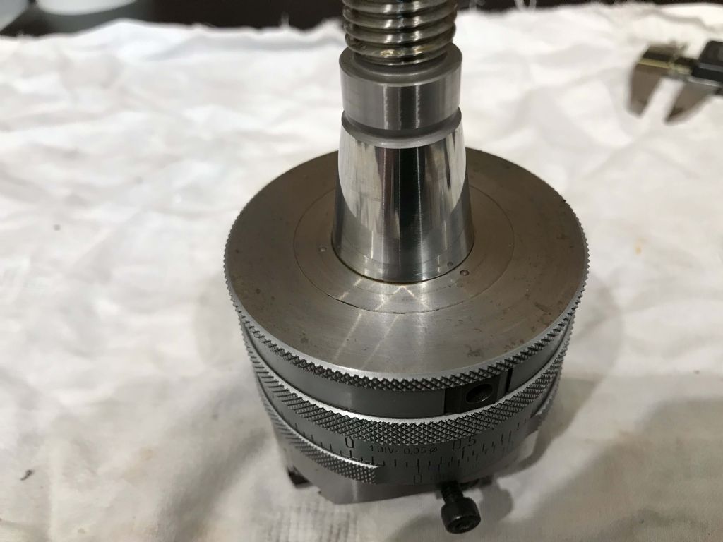

                                          Reviving this thread briefly (but for a good reason) I have one of these Kaiser PA boring and facing heads on a MT4 taper with what appears to be a 1/2″ BSW drawbar thread. It was previously used on an Alexander mill as I understand it.
                                          Anyway I needed to remove the MT4 arbor because 1. I need a M14 thread and 2. I need the extended MT4 arbor because my mill has driving slots. I had peeked inside the drawbar hole and saw a centre drilled so assumed that it was a MT3 inside but found that it would not press out. After finding this thread I had realised that it was likely that the arbor was screwed on and seated on that short taper and when I tried it un-screwed quite readily after I warmed it up a little.
                                          I have to make a new extended-nose arbor for my mill, but I do have the original (probably factory because it’s well hardened) arbor available, if anyone has one of these heads and needs to hold it in a MT4 taper get in touch and I’ll sort you out for a very modest sum.
