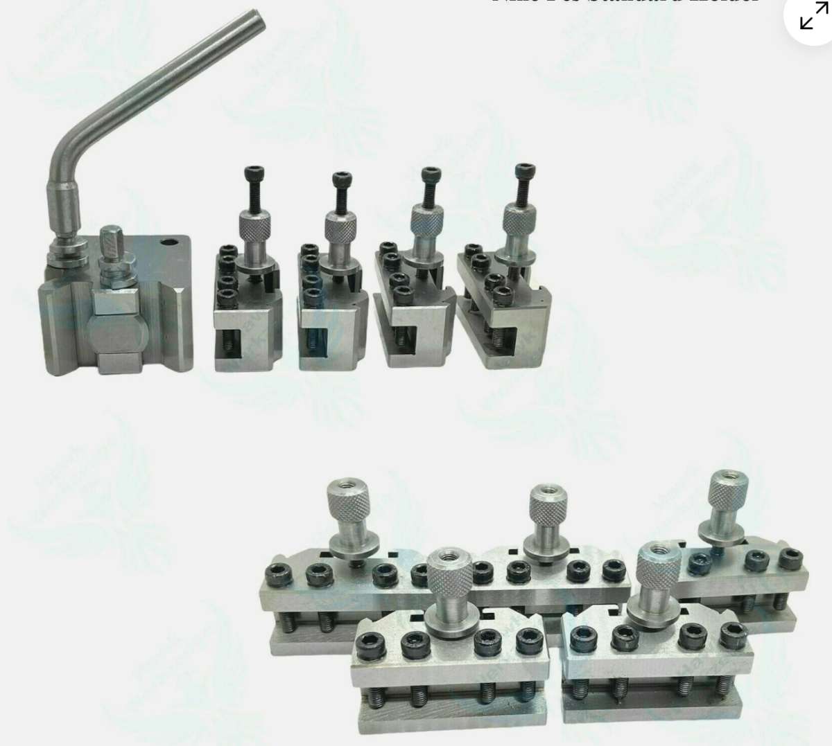

      I’m looking for a 12-15mm tool post for my lathe and I found this. But the price is suspiciously small for so many toolholders. Anybody had any experience with these? I have the same style of tool holders on my big industrial lathe and the are great. But they were made in Italy and are way more expensive.

        No experience of said QCTP, but very cheap items originating in India would make me very wary. There is some excellent kit made in India, but the quality is reflected in the asking price.

        Tony Pratt 1
          @tonypratt1
          I liked these style of toolholders when I worked in industry and had little problems with them. But these far east knock offs are not made to the same degree of accuracy. I had quite a collection of these budget toolholders in my garage for hobby use but they were not the best, poorly made and the clamping was a bit iffy so sold them on and bought a wedge style tool post and holders which I’m happy with.
          In short the deal sounds good but I would walk away!

            It could be a bit of a gamble.  While it resembles a Dickson type QCTP, it’s very unlikely to be made to the same tolerances.  The supplied tool holders may well fit the toolpost, but can you get spare tool holders, and will they also fit?  I have what may be a similar QCTP from Warco and it works well, apart from variability in the clamping of a couple of tool holders to the post.  I was able to remedy this with some thin strips of shim steel “JB welded” in the tool holder slot.  Also, While there are other similar inexpensive QCTP’s out there, they’re unlikely to be interchangeable.

              If you can afford to lose that money, take a gamble on it.
              Some of those cheap QCTP sets are made of aluminium, not steel. Yes it says they are hardened, but hardened what? Verify with the seller before rolling the dice.

                  I have that style of QCTP on both a Myford S7 & a Warco GH600. Both work fine.
                  The Myford arrangment came from Myford Spares Counter when they were still the original company. Other holders have come from different Ebay sellers at different times – all fit the Myford post fine.
                  The next size up system on the Warco came from an Ebay seller & is probably of Indian origin. This too is fine & holders from 3 different sources fit without issues. I had to bore out the toolpost on this to fit over a boss on the compound slide & it was very hard (used a CBN insert – which gave it’s life in the process, but did the job).
                  Based on my experience I would go for it. The Dickson system is proven (used several genuine Dickson TPs when working – all good). If you buy from a repuatable platform you will have redress should the supplied items prove unsuitable – though that is probably unlikely.

                      I know that style of QCTP is fine. I have a large industrial lathe that is using it. I was more interested if those Indian clones are any good.

                          I believe that the ones sold by Warco, RDG and Chronos are all the same Indian origin. I have had a Chronos one fitted to my Boxford for the last 20 years with no problems. Some of my holders are from Warco, some from RDG, some from eBay. They all work together, all have been fine.
                          Obviously its not as nice as a Dickson or Bison, but with a bit of deburring perfectly usable.

                                  These OCTP toolposts and tool holders are visually identical to the set I have fitted to my S7 which I bought from RGD tools – even down to the custom wrench, and they have been absolutely first class, no problems whatsoever.

                                    When I bought my Warco 720 (Super 7B clone), it came with two of these toolposts and 8 holders; they are often supplied as a bolck + 4 holders.
                                    All work fine for me.
                                    I then bought a couple of spare holders from the company which briefly re-started manufacturing them after pausing supplying to Myford themselves. They didn’t fit very well, and can only be made to lock by changing the pulling piston.
                                    I then borrowed an original genuine Dickson one from a friend, which locks fine, implying that the extra pair I bought were out of spec.
                                    Subsequently I’ve added several more holders, including extended nose ones, all of which lock OK, but in slightly different positions of the handle, so lightly different measurements.
                                    I see that the ones you’ve listed above have two sets left; If you can afford it, I’d be tempted to buy both, as you will then end up with lots of tool holders which should match both toolposts.
                                    N.B. The search I did shows a 13 piece set, block +12 holders; your photo shows less holders, so check your adverts & descriptions carefully, the same ad I found, claims 13 piece, but shows photos of 13, 10 & 5 piece sets, though the description is for 13.
