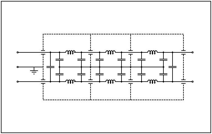

              The filter design is complicated because power inverters switch square waves at radio frequency, and square waves are full of harmonics and voltage spikes.  The filter cleans up in several stages, each stage removing part of the muck.  The stages are carefully matched to cooperate with each other.  The design is difficult.
              The components aren’t ordinary:  high-speed low ESR capacitors, and inductors wound on ferrite cores selected to absorb part bands of unwanted frequencies.  The inductors are probably wound on toroid cores rather than solenoids. All mains rated or better.   The circuit is balanced, so double the number of components.
              The components are internally shielded inside a screened box and often arranged at right angles to minimise pick up.  Circuit something like this:
              filter
              So, 8 feed-through capacitors, 14 filter capacitors and 6 inductors.
              The filter I recovered from an old washing is single stage, unbalanced and narrow frequency.  I mean to try it on my lathe one day.  I expect it will help a little, not much.
              Home made is possible.  Trouble is, the interference spectrum would have to be identified and fed into the component value calculations.  I have a book and the maths is intimidating.   There might be an online calculator, but then suitable components have to be found and assembled in a well-made box.  A loose lid ruins performance.
              Could take a by-and-large approach, building a filter with guesstimated components, and accepting it will underperform.  Not difficult to filter out 6dB, problem being a professional unit does 60dB or better.  And the scale is logarithmic.  Suitable filters must be available second-hand, I’ve never seen one!
              Some Radio Amateurs do make filters in this class; not me, though I have made a few simpler bandpass filters.  For example, transmitting on 7MHz, suppressing the second harmonic on 14MHz and the third on 21MHz is relatively easy because the three single signals are spaced 7MHz apart.  Inverters are much messier.
