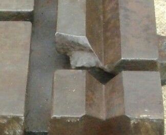

      I have a broken T slot which needs repairing. Question is: What would be the best way?
      My first thought is to mill the bottom to remove the sideways slot and back to make space for a bolt hole through the casting. Then mill backwards (up on this pic) at an angle. A shaped steel "bolt", to replace the parts lost and removed, would be fitted through the hole and secured underneath and either welded or brazed to the cast.
      The idea is that steel would give strength on the corner of the two slots and support the cast on the angled join. The intention is for a working repair, not just a 'decorative' one.
      I'm open to suggestions as the casting is likely around 100 years old and is not replaceable. There are another couple of angles in an album.
      Slots are 1/2" and their base width is 1"

          Any chance that you could manufacture a short length in steel, cut out the cast iron, entirely for a few inches and retain the steel repair with countersunk screws?

            How thick is the material in the base of the t slot ?
            What is the slot between the two sections for ?

                  If it is worth the investment, get an expert in cast iron repairs to build it up using suitable sticks (it can be done) and re-machine.

                    Suitable sticks meaning pure nickel. All you need is 90A and 2.5mm rods very easy welding.
                    However there a lots out there with a percentage of FE in them. Use one of these and you get un machineable scrap metal that you can only angle grind very slowly.

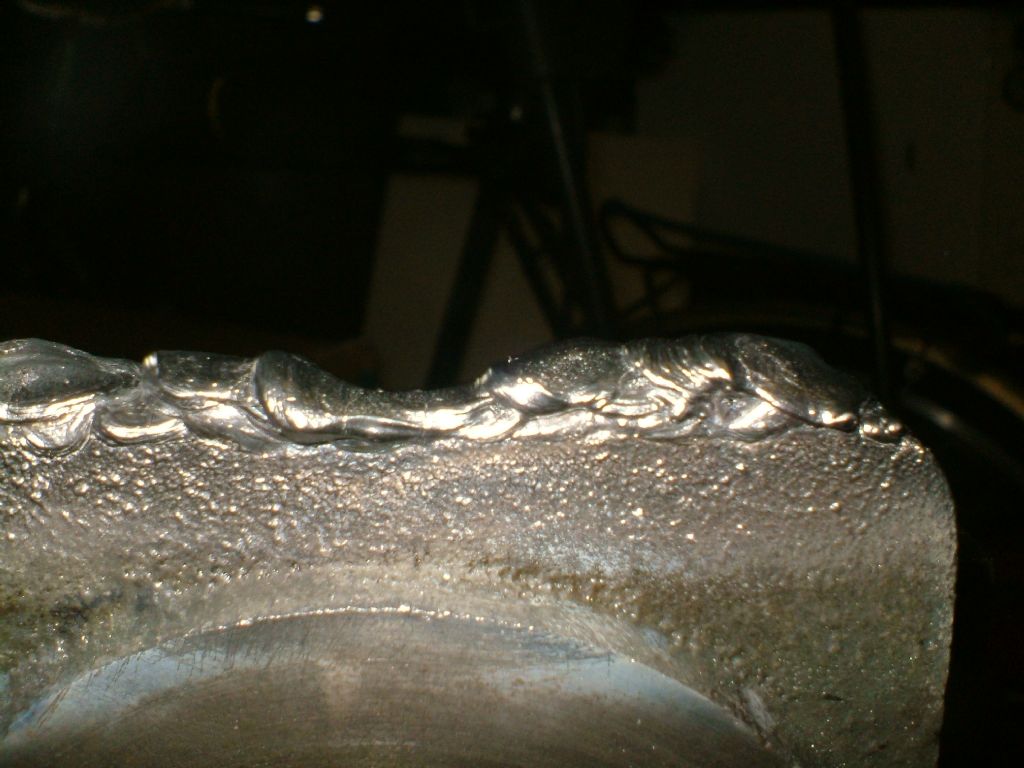

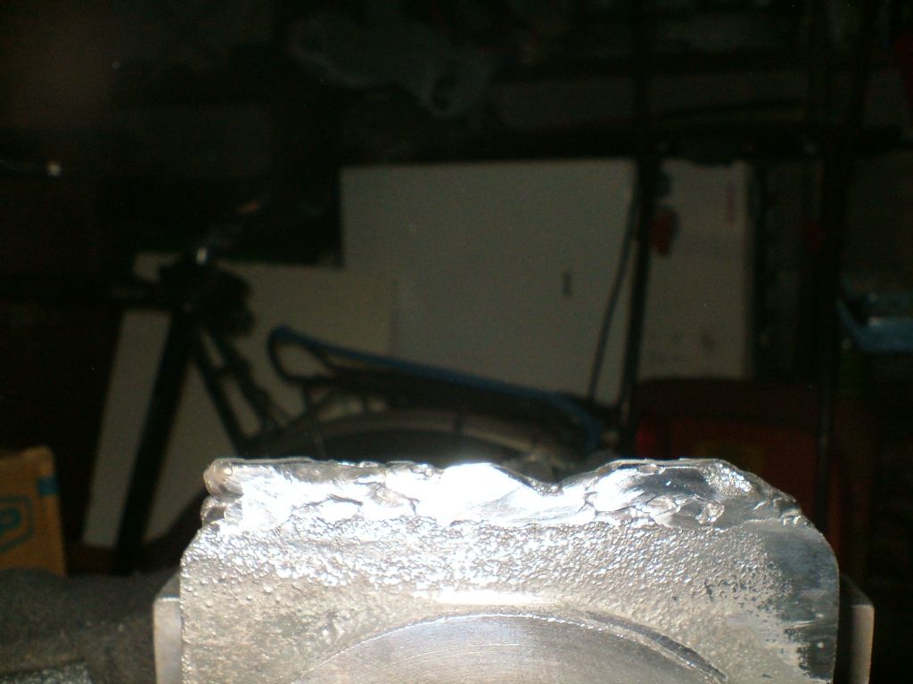

                                      While the position of the break is at a very vulnerable spot, it's also a very good location for a weld repair, since the likelihood of distortion is reduced by the exposed location.
                                      Pre-heat the part to about 350-400°C and use 98% Ni rods with a stick welder to build up enough metal to mill or shape the T-slots back to where they had been.
                                      Don't be afraid to add far more metal than was needed for a minimum buildup. It's simple to cut it off again and you will get some undercut/erosion of the original metal unless you are experienced with the process.
                                      The High Nickel rods will have a slightly different colour to the original steel (more yellow), but because they don't absorb carbon. They will not be hard to machine.
                                      As a datum, this is how I repaired some gears on my shaper and found that the weld machined very easily.

                                          I'm currently slowly building up the bottom of a cast iron milling slide with standard rods and a cheap inverter, my current pet project to simplify and beef up milling on my lathe
                                          Will let you know how I get on, early days yet though
                                          First impressions are good if the cast lron is good quality close grained type and any oil is completely removed filed or ground off before welding

                                              A zero experience noob effort
                                              Each bead needs thoroughly cleaning and preparing (i used a rotary wire brush) and a hand held angle grinder squares it off
                                              How successful a job you get will depend entirely how much skill and care is put into your wee job

                                                I have repaired similar. Machine the top of the tee off for a long enough to get four threaded holes in. Then bolt a cast iron plate in the machined place. Countersink the holes in the plate and make four studs with countersunk heads.
                                                Fit the plate with these then machine the studs flush.
