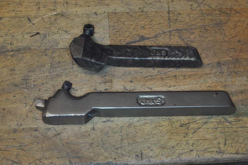

                          J&S also do some with the usual end but with most of the shank thinned down – they are a bit rare. I've seen them oil blacked rather than the usual shiny ones.

                          Roderick Jenkins
                            @roderickjenkins93242
                            Posted by John W1 on 18/09/2015 19:41:50:
                            Indeed they do, John:
                            The top one has a 1/2" deep shank and takes 3/16" square tools and the lower one has a 5/8" deep shank and takes 1/4" tools. They both have a distinctly "hand crafted" look about them, with a lot of file marks. I assume, from the patterning, that the top one has been case hardened. The lower one looks as if it might be plated. I've had them for ever, never used them but you never know…

                            bodge
                              @bodge
                              Have couple of J&S tool holders like bottom one in Rods picture, they are cranked left & right handed,and take 3/16 tool bits, the shanks are 1/2 inch deep ,like the top one in pic, which looks like it may have been shortened at some point in its life .
