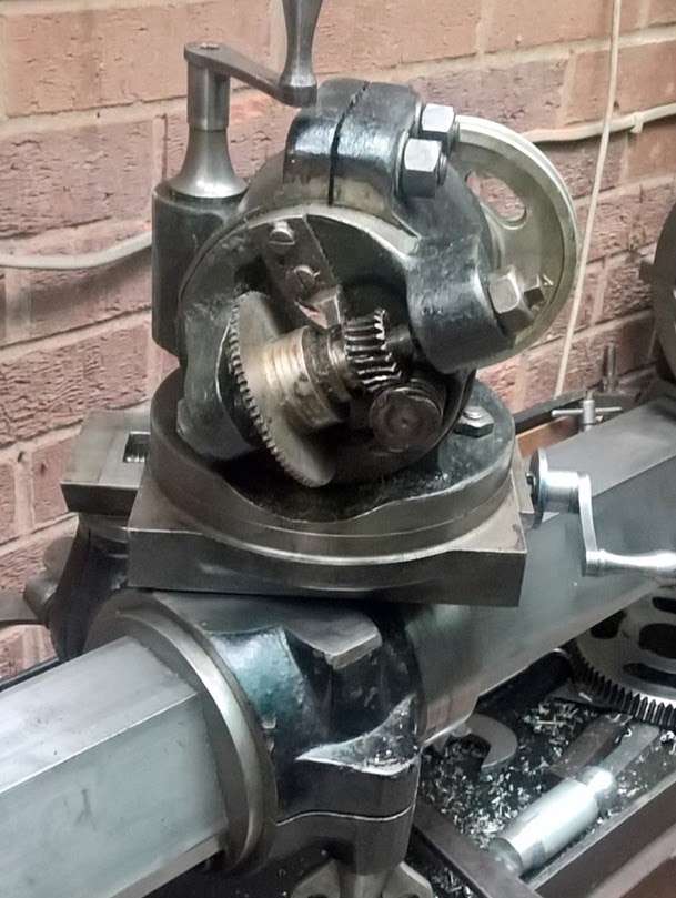

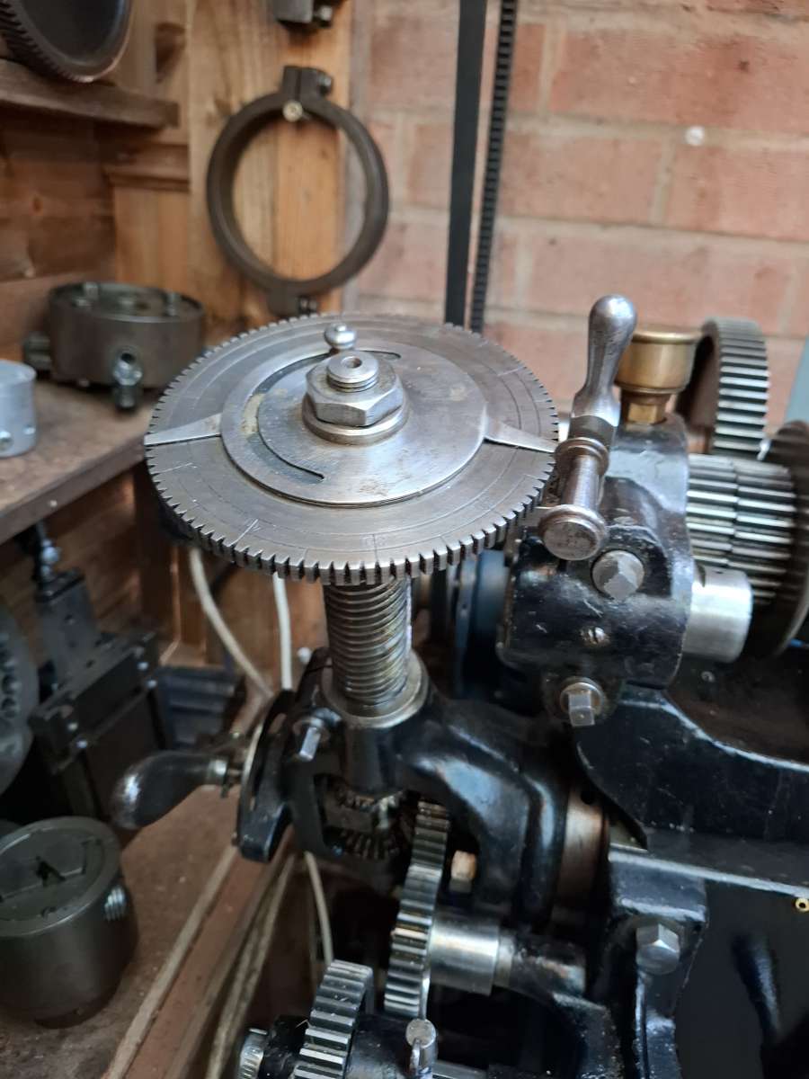

      20260915_153108A Pittler C3 lathe dating from 1894, here shown using the unique dividing spindle invented by von Pittler, it simply pushes in to replace the screw cutting spindle The spanning hands on the disk of 100 notches set the count in a similar way to modern versions, a huge number of divisions are available using different worms and wheels and back gear The drum cutter is original Pittler equipment and fits in the saddle casting, it enables a blade to turn to any angle between horizontal and vertical, here I am trying it out cutting a helix
      drum cutter

              These machine have so many possibilities it’s incredible for their age, the original catalogues show examples such as cutting a round ball and socket and then threading them to screw together. Pittler called it a universal machine tool with good reason but fathoming out how to do some of the things in diagrams with no instructions is trial and error
