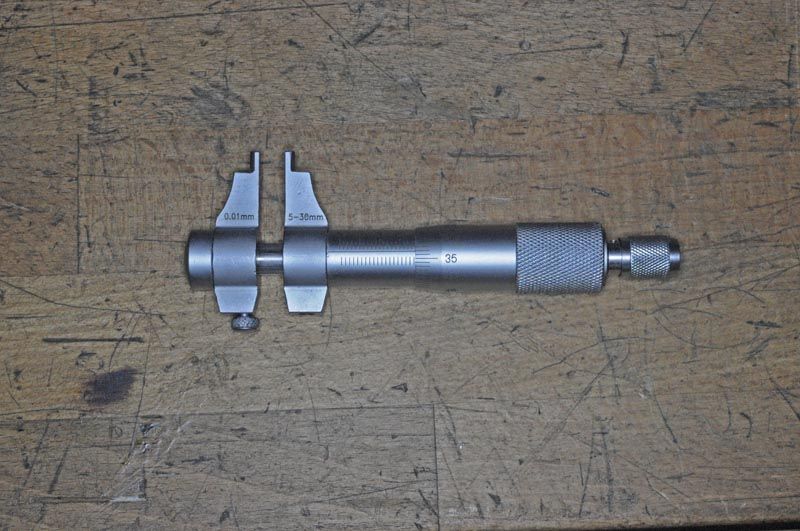

      I started out with curved calipers, set to the bore then measured with micrometers.
      I subsequently flirted with telescopic and expanding "bell" gauges, again set then measure with micrometers
      Later I did get an old style internal micrometer, great for bigger stuff but the minimum size is a bit of a limitation.
      Recently I bought a 5-30mm internal micrometer that has pins instead of anvils and that's great for accurately measuring bores but only at the first few mm from the surface and only above 5mm.

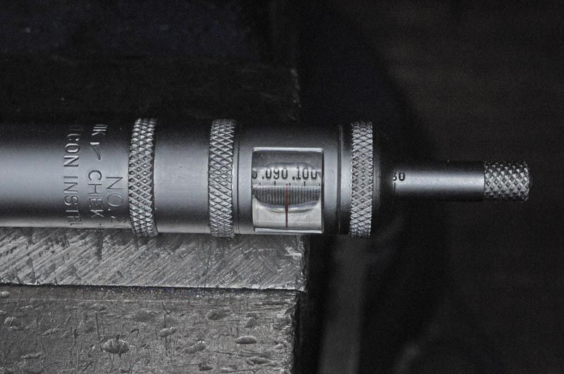

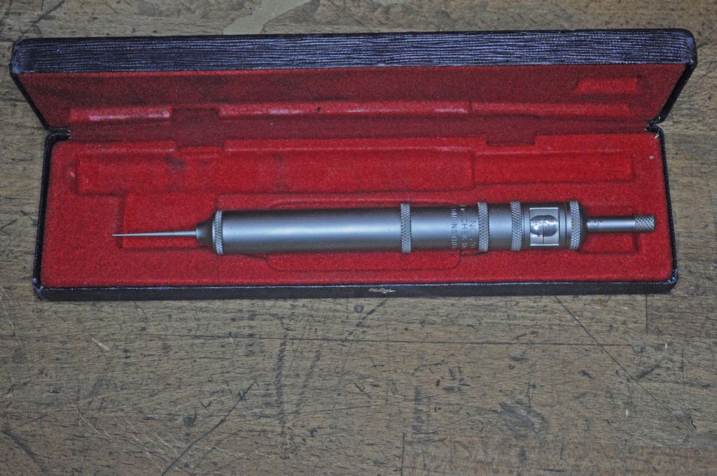

            I use a Starrett 269a taper gauge for holes from 0.100" – 0.500", and drill bits for holes smaller than 0.100"

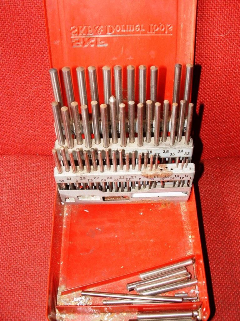

                  A few months ago I had the opportunity to buy sets of HSS Drill blanks, 1-6mm and 6-10mm by 0.10mm increments for a very low price. Since having them have found they are very useful not only for hole diameters but also for measuring slots cut on the milling machine.

                    Plus one for the drill blanks. After that it is small bore gauges and telescopic gauges plus luck but usually close enough for things I make.

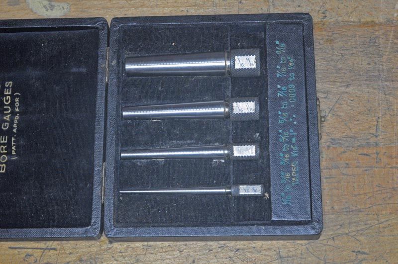

                              Small drill blanks used as plug gauges, as mentioned before tapered bore gauges.

                                        Many years ago I was given these:
                                        and this:
                                        I've never used them, it seems dodgy to me to measure a hole at the "corner" – too much chance of burrs or bellmouthing (nice bits of kit though).
