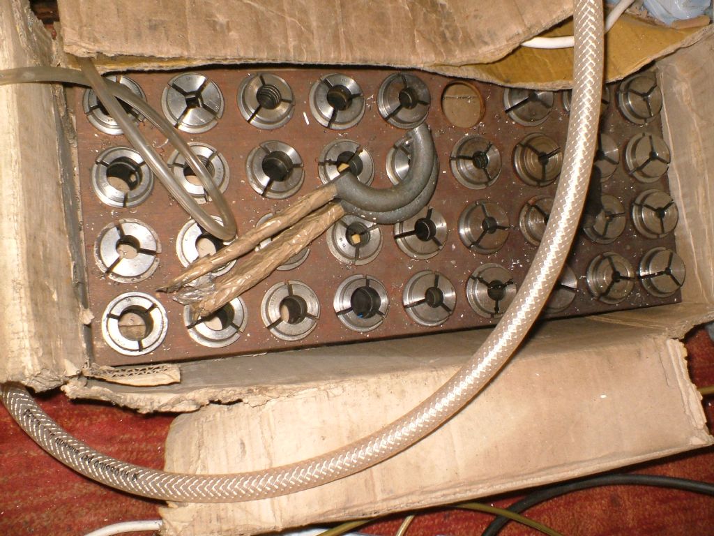

Anyway, way back in the early days I acquired a completely useless set of ward/herbert collets for almost nowt, one of those bargains you may never get to use

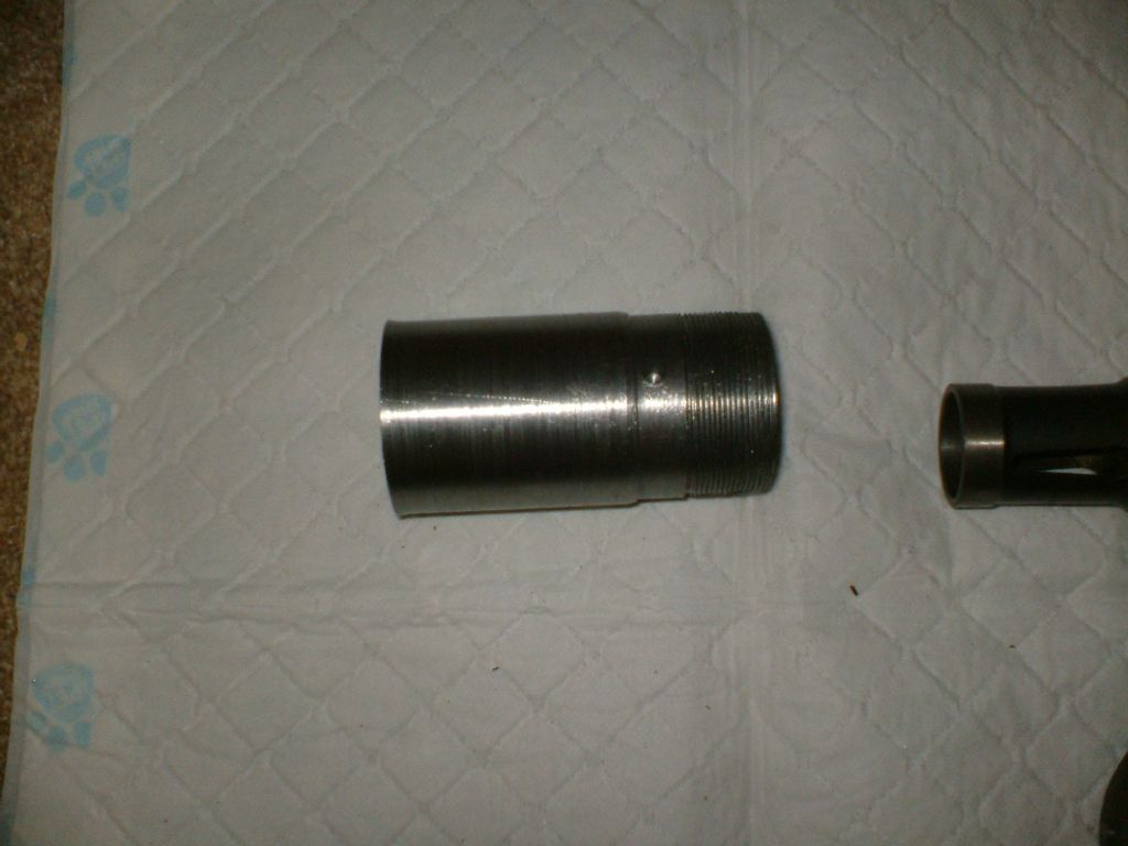

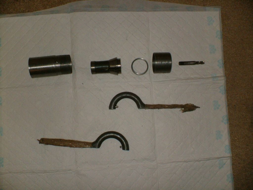

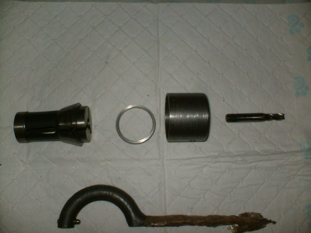

Then I set myself the task of making a collet holder for my Drummond M series which has been an on and off process until completion today
What held me up was when I saw the amount of overhang for this "collet holder" I assumed it would be useless. There was also a slight wobble of a thou or two so it was never going to be a "proper job" for good bar work and the job became an occasional effort

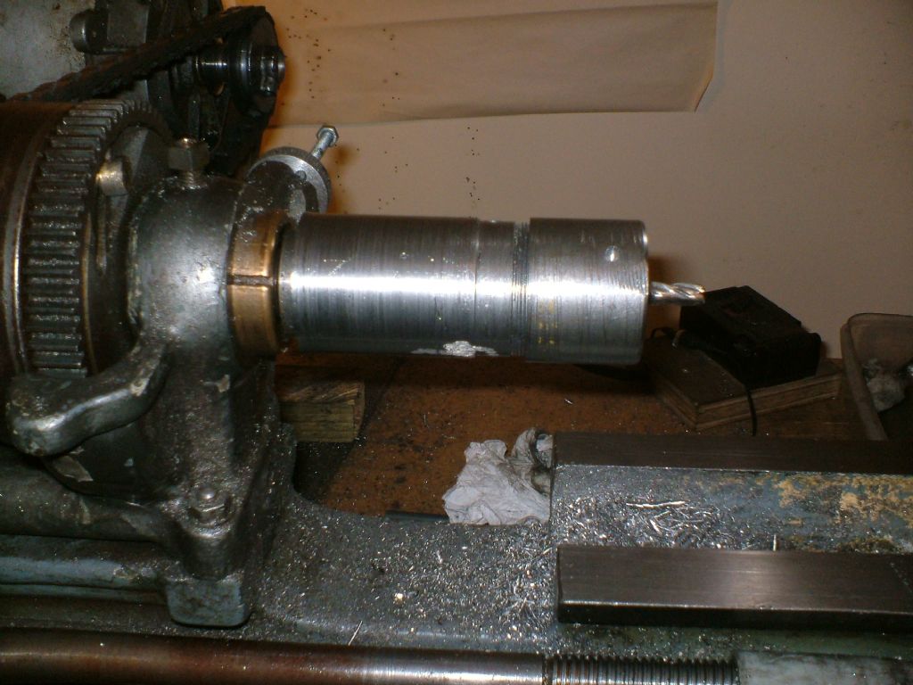

Well I finally finished it today and tried it out with a milling cutter and it was FABULOUS
6mm 8mm 10mm 12mm the metal just flew off as each cutter went brrrrrrrrrrrrrrrrr through a mild steel job I was messing about with
Straight in, up, down, who cares, it was amazing
the milling slide needed no extra support either, although I would still give it extra support it in the event of an overhanging job
I've used my big chucks in the past, but even a home made collet holder does a far better job
