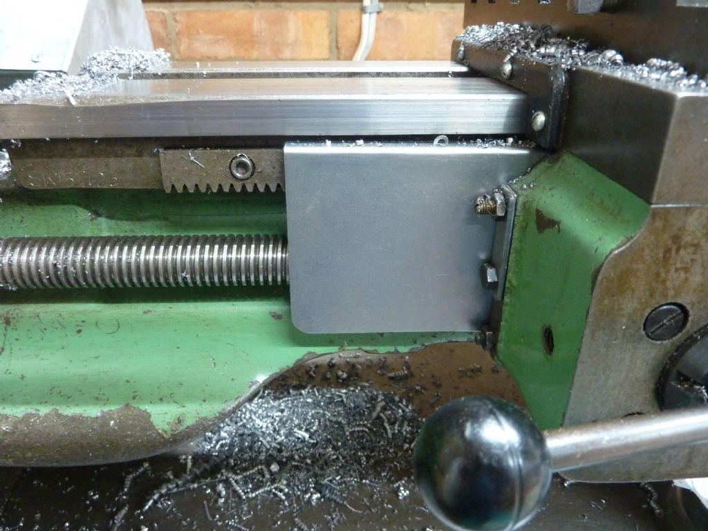

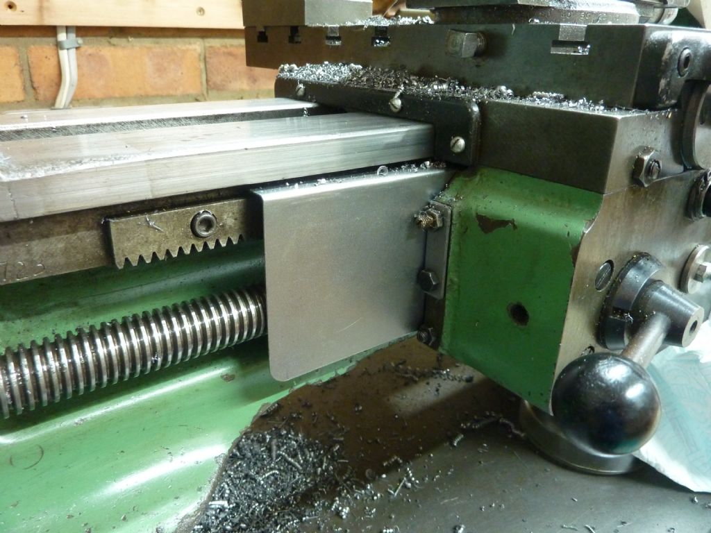

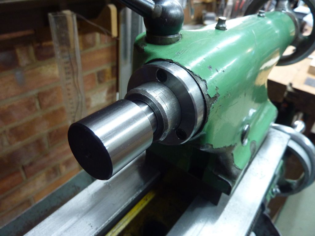

                        Hi ega, I have posted photos of the two guards I've made so far below:
                        Leadscrew Swarf Guard 1
                        Leadscrew Swarf Guard 2
                        Tailstock Swarf Guard

                          Thanks for the photos. The new leadscrew guard is clearly doing a good job already; I assume the standard guard is removed.
                          From your photo it seems that the PXF machine's half nut lever does not need the protection I mentioned.

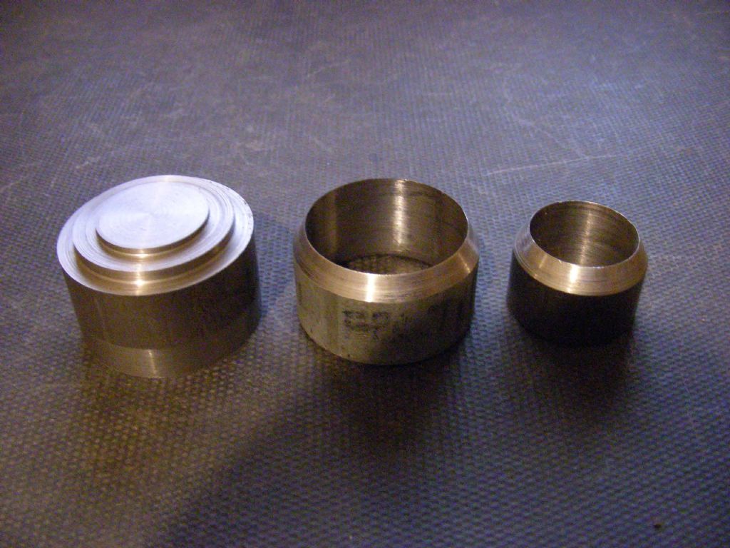

                          FYI, here is a photo of the tool I made to produce the felts for my Quorn grinder:
                          Perhaps not justified for a one off but you could make more and sell them to Hemingway!

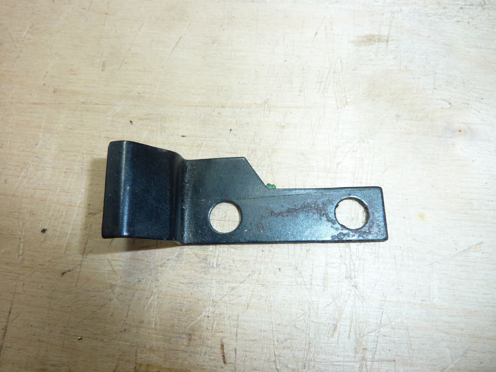

                            ega: Yes, I removed the standard guard and the plate that protects the half-nuts (which I can't find any reference to in the manual so I'm wondering whether it was home-made. Having said that, it does look as if it has been stamped out:
                            Original half nut guard
                            I like your felt cutter and was wondering how to make such a thing. How did you make yours? I assume it's made in several pieces?

                              Yes – a base, inner and outer ring; the outer ring looks as though I made it from a bit of scaffold tube.
                              The OD of the felt produced would be about 36mm; would this suit your job, by any chance? I could easily put a felt in the post.
                              I have no experience of the PXF machine. Presumably, the holes on the part in your photo are there to clear the screws associated with the gib strip and/or standard guard. Like you, I couldn't see this part in the manual (drawing LA) and I had some difficulty in visualising its orientation and function.

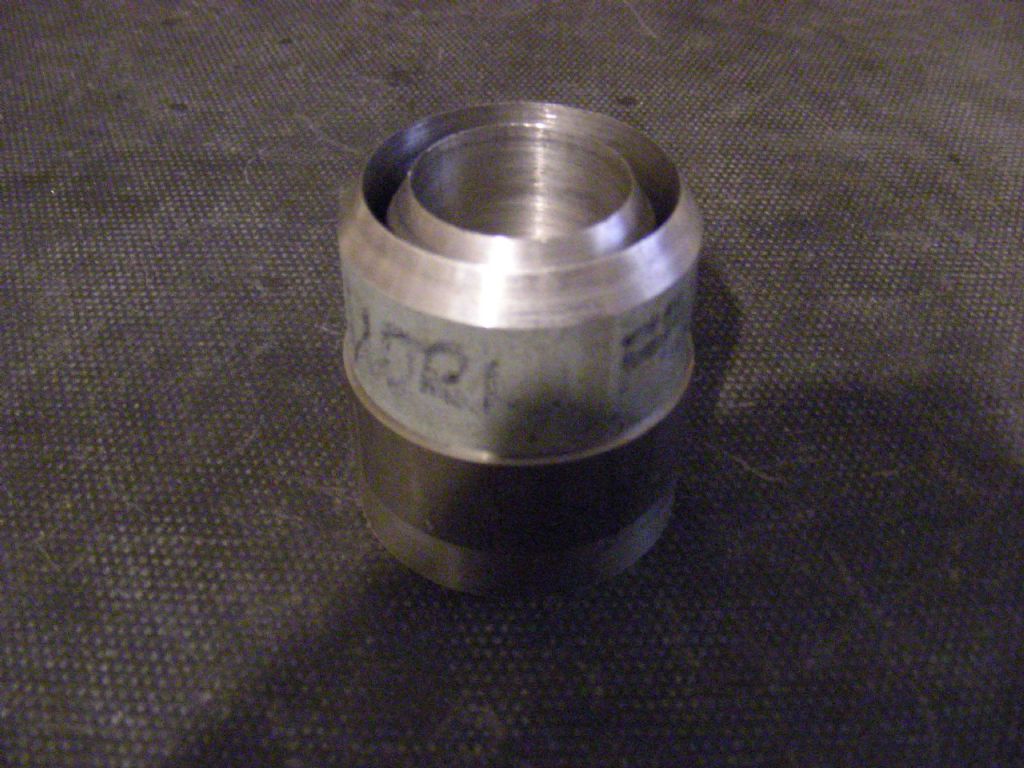

                                How did you keep the inner and out ring concentric?

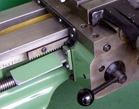

                                The part I photographed fits with the bent part upwards, covering the top of the apron above the half nuts, as in the photo on lathes.co.uk, which confirms that it must have been an original fitment:

                                  Like this:
                                  The two cutting surfaces need to be more or less level, of course.
                                  Good idea to check lathes.co.uk – clearly, we both have out-of-date manuals!
