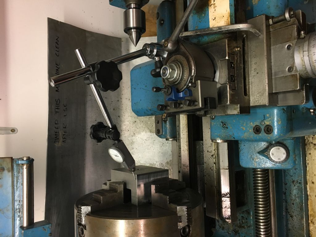

      i have just acquired a second hand Harrison L5 Lathe from the 1970? it in quite good condition except the sud pump and the chuck key is missing also the lathe tool post could some suggest a suitable one as looking at other posts and suppliers they all seem to small thanks

            img_3714.jpgimg_3560.jpgOn my 140 I've fitted a multifix toolpost, had to make a adapter for it to fit the large T slot on the compound slide, does the job a treat. Sorry about the angle of the pictures, no idea how to rotate them on my phone 👍🏻
