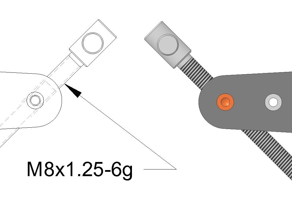

                                  #576914
                                    Bill, I'm sure Fuson can be used like Alibre in which case at the 3D modeling stage you can place a threaded hole or thread an external part. During modeling depemding on what settings you choose just be shown as a simple second line much as it would if on a 2D drawing or you can have a visual representation.
                                    At the time you come to produce the 2D working drawings you can again choose how it appears on the drawing but more importantly it will add a thread call out automatically on the drawing you don't have to try and remember if you were going to thread that hole 1/4BSF or 1/4 x 20 UNC from when you design the part some time ago.
                                    The visual is useful for things like that Kant clamp assembly I drew the other day as it is easy to see what parts are threaded but not something I would want on a 2D drawing.
                                    I'd go for the option on the left for 2D working drawings, I have the default set for it to include that M8 call out onto the drawing by itself as well as the second broken lines. It will adjust the position of the broken line to suit the selected threads minor diameter and also the length if entered all I need click at design stage is M8 coarse,
                                    Click for larger clearer image
                                    But on a 3D rendering or animation having the visual thread can make things easier to understand as well as some colour to indicate material types. Again watch on youtube for larger screen
                                    So useful to have the data there if the user wants to make use of it, don't know how you would easily depict say an external thread otherwise as you can't get your pen out and simply draw the second broken lines onto a bit of round bar.
                                    Edited By JasonB on 27/12/2021 07:40:12
