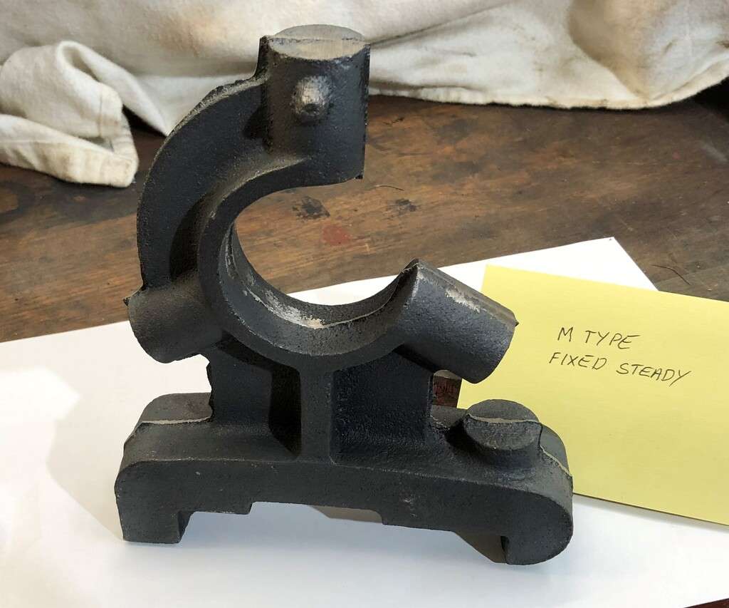

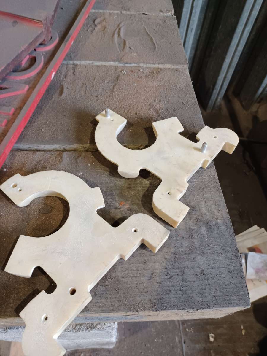

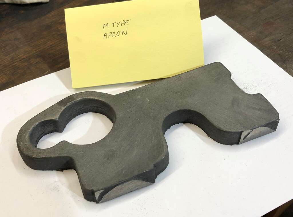

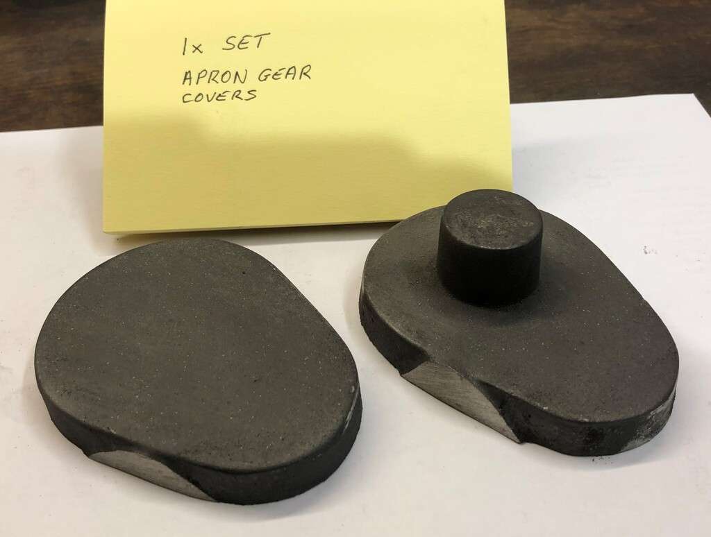

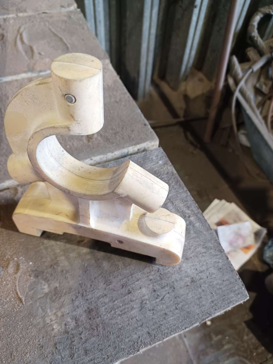

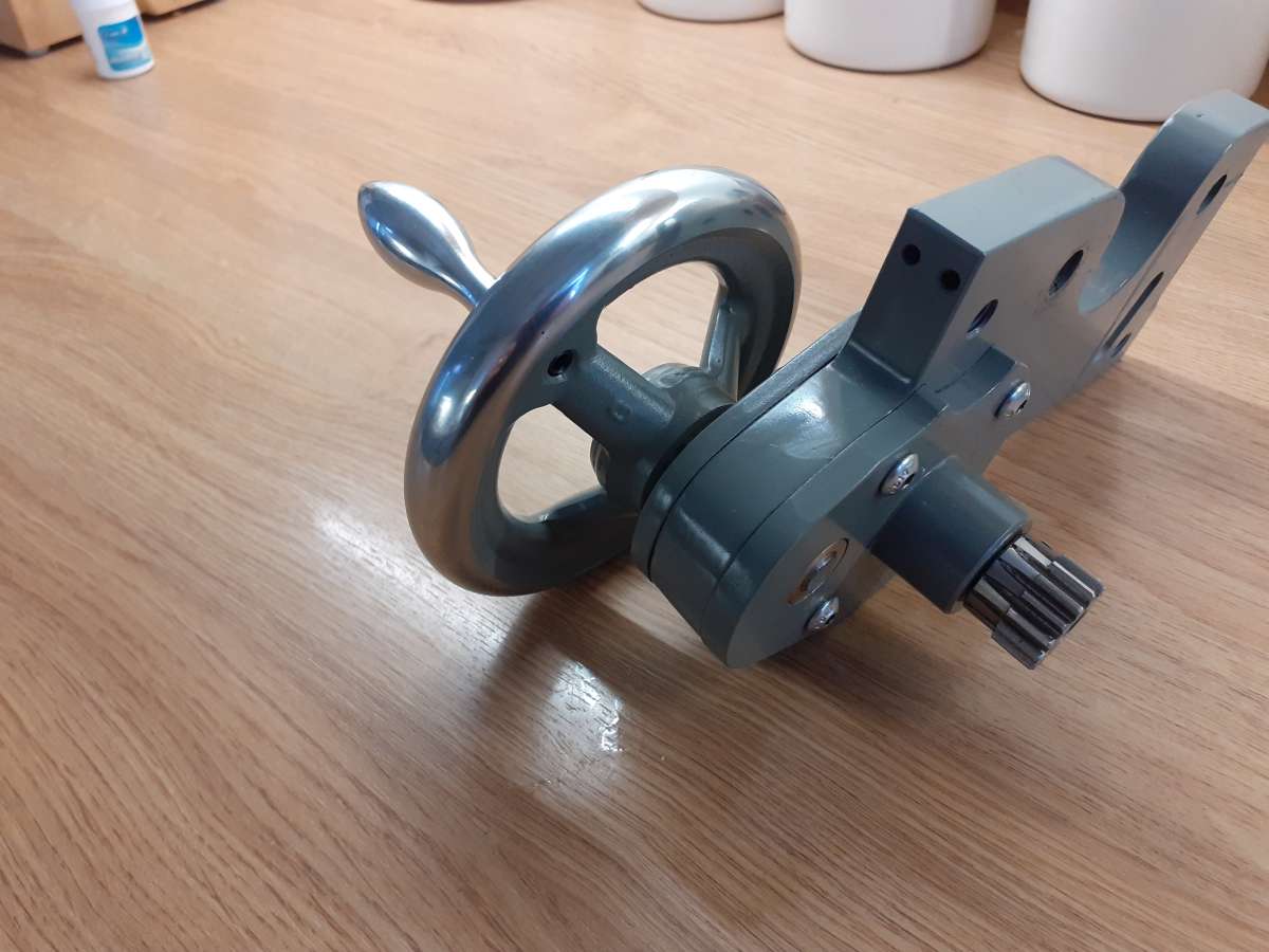

        I have had patterns made recently for remaking parts for Drummond lathe parts. I have also made patterns for simple pars which didnt need complex split and taper as well as shrinkage management for diferant part metals.
        Fixed steady.
        M type fixed steady
        20240711_12391320240711_123952
        made by Greedale patern makers in resin CNC cut from a block
        Castings made from body already excisting and two side covers from paterns I made. These are for a mod to add an extra gear which changes the handwheel rotation.

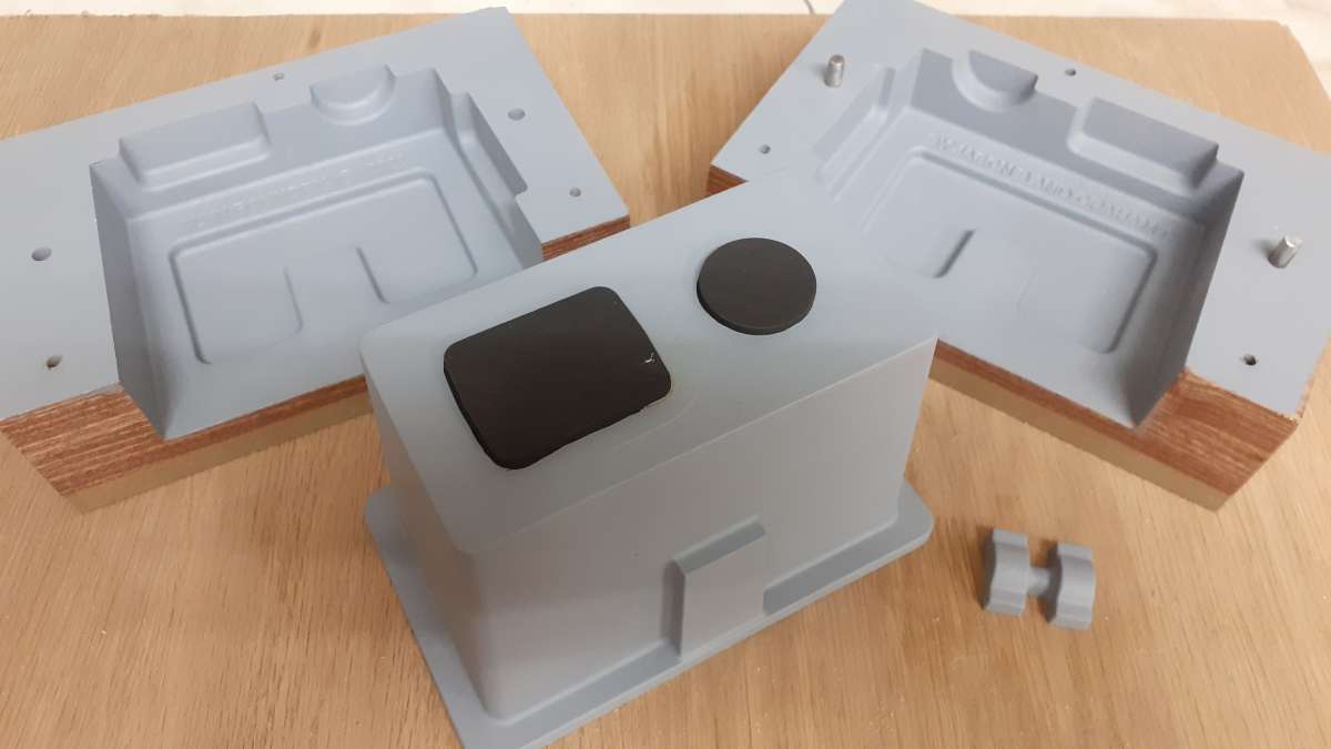

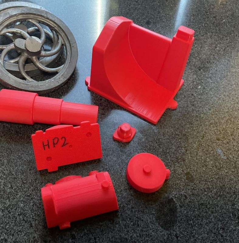

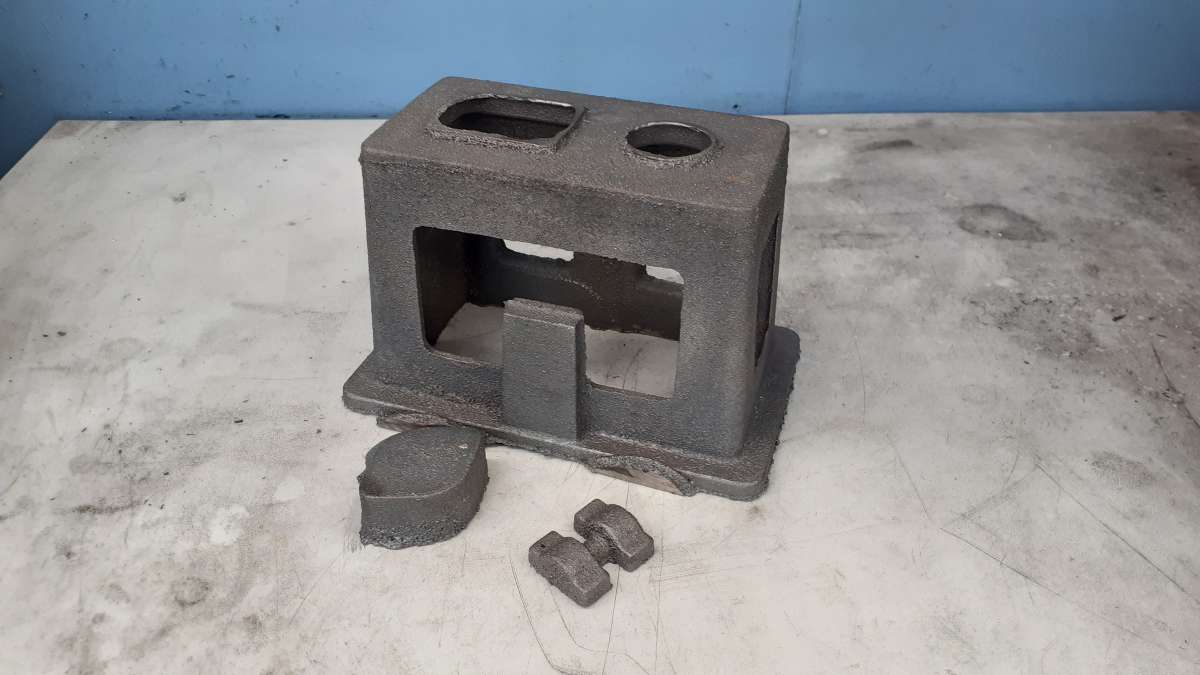

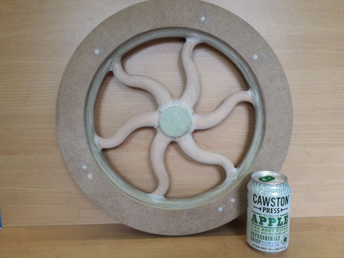

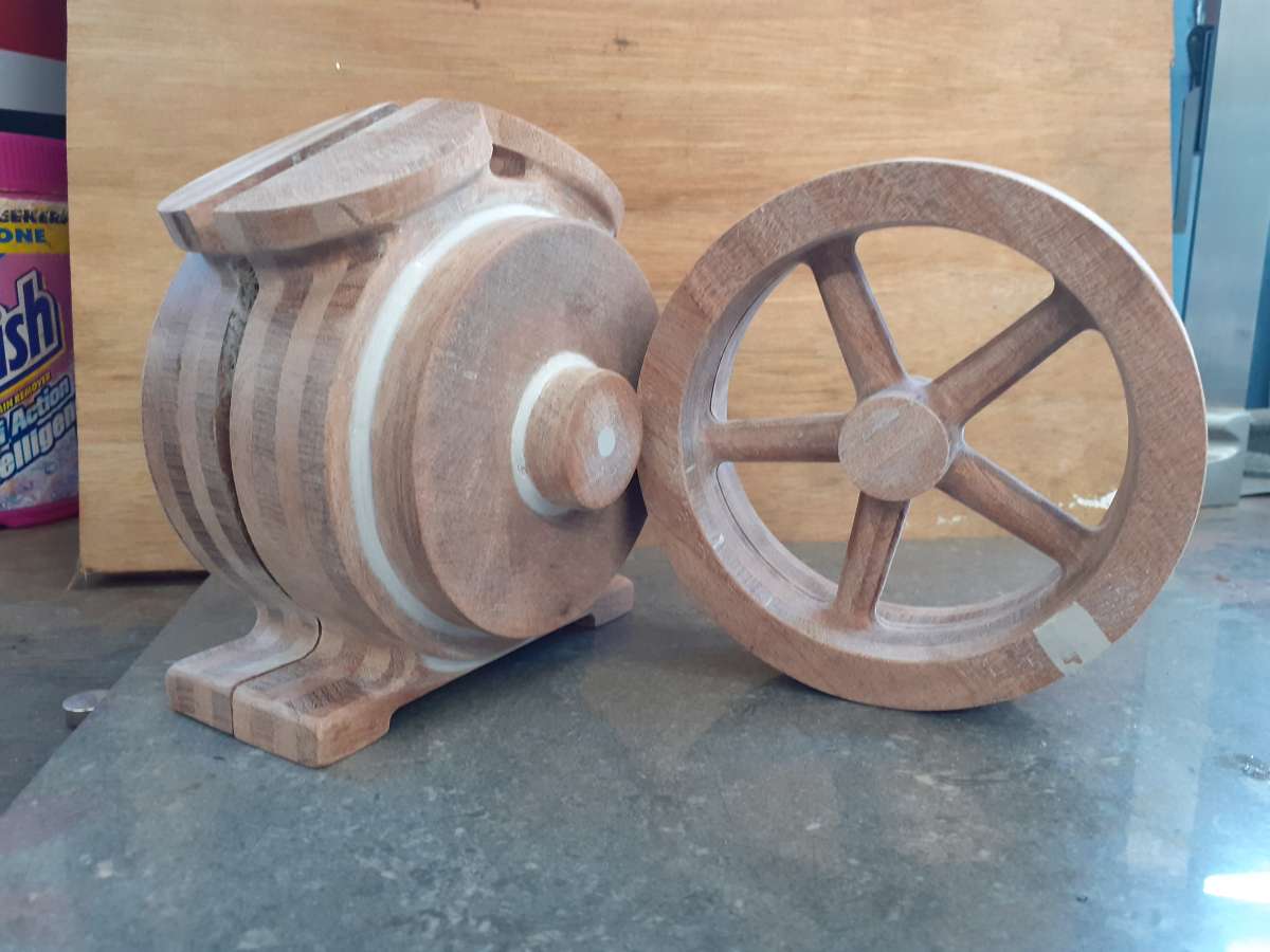

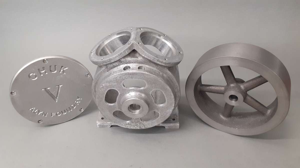

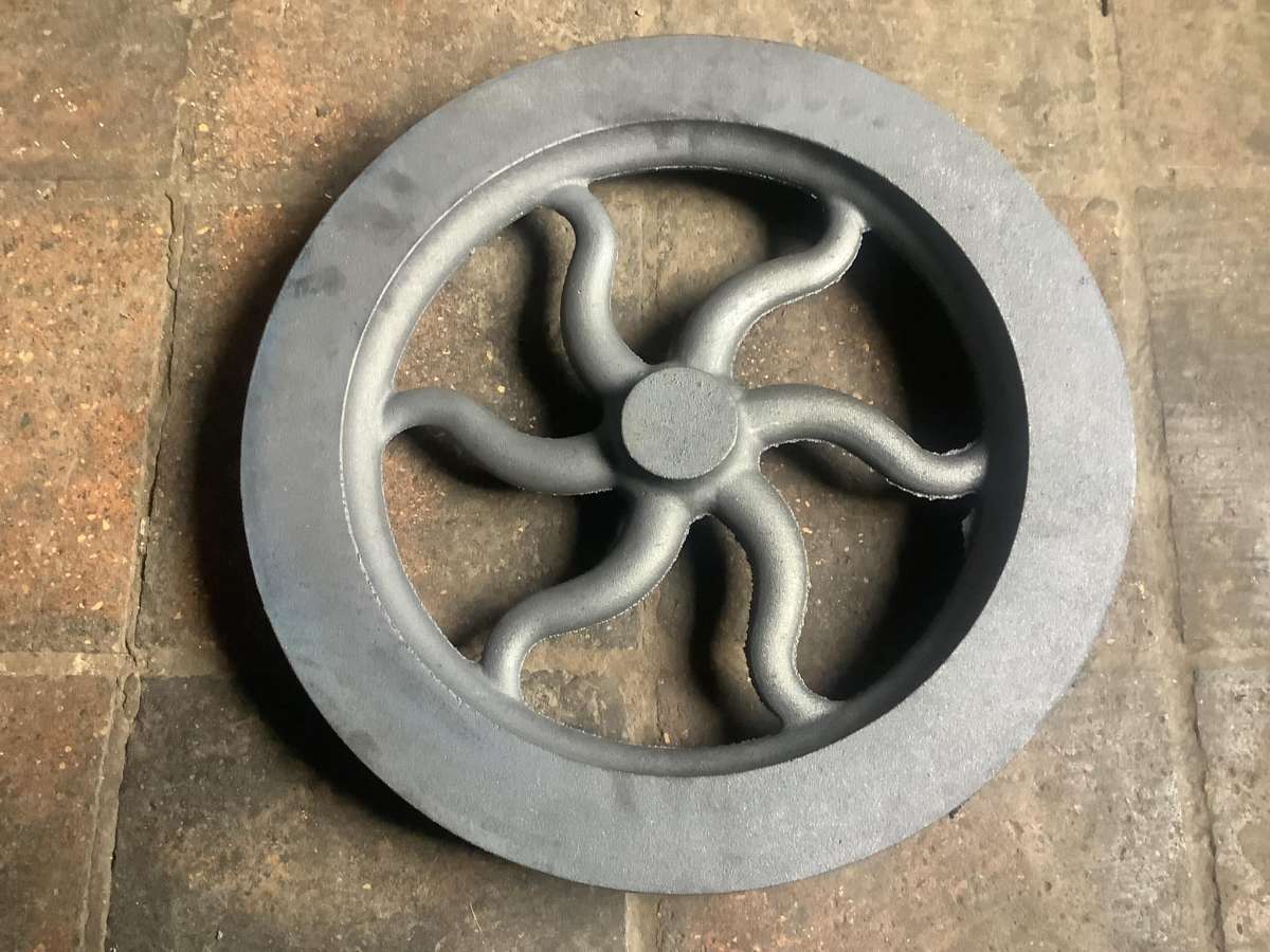

              When Neil gets round to publishing it I have an article that shows taking a fag packet sketch through design, patterns and finally machining.
              These days if you can use 3D CAD then our size castings are likely to suit 3D printed patterns so that opens things up to those that don’t like the brown stuff. Does need a well filled pattern with a thick surface. I’ve done it both ways with wood manually and also CNC cut and had quite  afew of my CAd designed patterns 3D printed and castings taken from those.
              Finding foundries that will produce a decent casting from them is a different matter and becoming harder to find all the time.

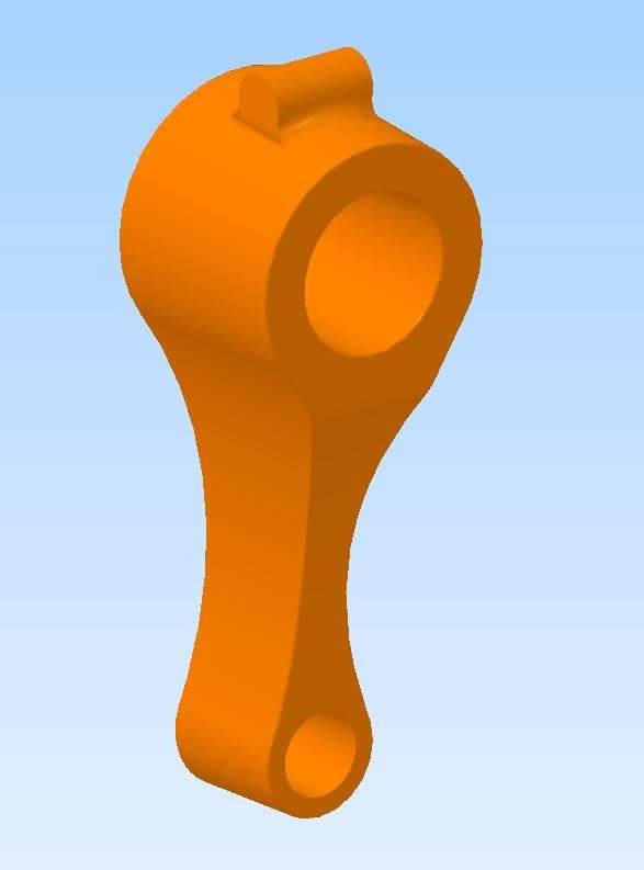

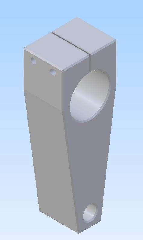

                  You probably saw the printer’s “slicer” software in action. This is not a design program like CAD but what is used to convert an imported CAD file and turn it into something the printer understands. Much like the software that comes with an HP or Brother paper printer is specific to that and not a word processor. Some printers come with an inbuilt camera so you can watch the part being printed from your armchair or anywhere with web access.
                  Should not be too hard to knock up a suitable 1 sided pattern, will probably want a loose piece so that the top clamp boss can be pulled out of the sand. Alibre will add the draft as part of the extrusion of the main shape both externally and also to the two main holes. using “Scale” will add a shrinkage allowance.

                        I suppose it comes down to what an individual is has to hand and is capable of. If your welding is pants then fabrication may not be the best option, if you like making swarf then cut from solid, could just be an inverted triangle with the point cut off if you like sawing

                            A version of Jason’s suggestion but with squarer clamp-boss made along the top rather than across it, and machined to take a split-sleeve clamp as often used on bench-drill columns, would be simpler to cast or to fabricate.
