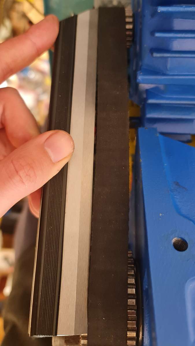

      I just got a new belt for my lathe and I have some problems with it. I understand how to adjust the two pulleys in order to keep the belt from falling off. But I don’t understand why it is wobbling like this. Could it be a defect of the belt?
      The old belt doesn’t wobble like that. So that means the new one is bad or I’m missing something?
      I bought the belt here. I got the cheapest one, the one for 11.2 euros. Because I was stingy. But is it normal for it to be so bad?

        If you run a straight edge around it on the sides does it look to be V shaped ? If so it has been assembled incorrectly. If not I would tighten it and try to run it in. Maybe been sitting in packaging folded for some time.

          Yes it does. But the V shape moves to the other side if I put the belt in the other way. So I think this is not caused by assembling error. And the old belt doesn’t have this V shape.
          One more thing. If I put the belt on a flat surface I can’t notice any irregularities. So maybe some of the internal glass fiber wires are broken and this is deforming it when tensioned?

            It looks to me like the new belt has not been manufactured correctly.

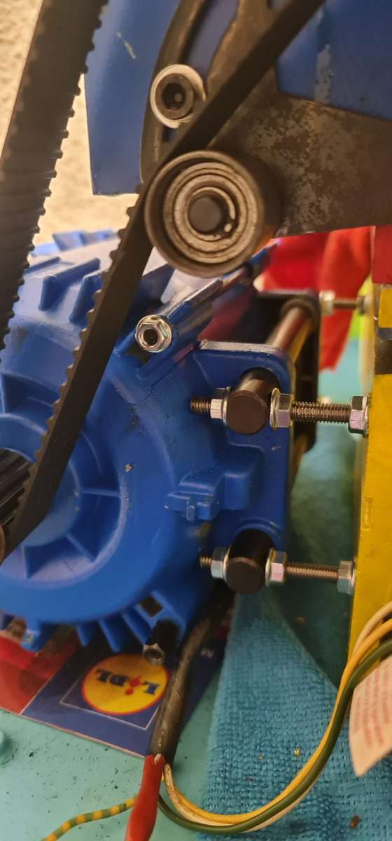

              Also possible, because it’s that lathe again, is the tensioner problem fixed?  Low or over-tensioned belts can snake.
              Bearing in mind the lathe has been completely dis- and reassembled (I believe), confirm the pulleys and tension roller are parallel and aligned fore/aft.  And that the bearings aren’t twisted in the motor or headstock. Apply a straight-edge to check alignment and a DTI to confirm there’s no run-out.
              As the lathe seems to have some non-standard features, trust nothing until proven otherwise! Bent motor shaft?

                EDIT – no, agree it’s the belt – that is ‘wrong’ – if you used that on a machine with cheeks on the pulleys it’d fail in short order – decent toothed belts run remarkably true..
                Will they take it back / credit you the amount if you buy a branded one? ..a good belt should last for years on a lathe, so costs over time are small..
                #837311
                  Wonky belt, I believe they are made as a long tube then cut to width. That one was cut crooked.

                            The lathe is fine. At least this part. I made a modification to use the old Continental belt that was too long. Everything is fine now. I’ll try to return that silly belt.
