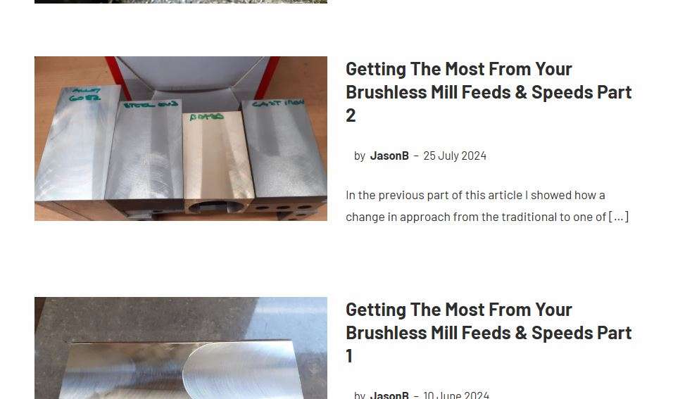

        If you click the “workshop” heading on the light blue bar along the top of the page and read these two articles of mine you can see how a SX2.7 handles a facemill. I suggest you go with the inserts shown in the second part.
        50mm 5 insert head would be a reasonable choice though I have used upto 80mm. Cut depth of 0.5mm per pass and make 4 passes of just over 40mm width to cover the work.

          Thanks Jason, that’s a real help.

                    Perhaps it would be useful to add a postscript to the articles now that the source of the facemill shown no longer exists.

                        And I expect many looking at the article will go and buy a cheap direct from china option  which was a factor in the demise of ARC. I have previously written about those and how they can be made to work better and also using inserts from the likes of APT helped but the 50mm banggood one I tried was not upto ARCs usual standard.
