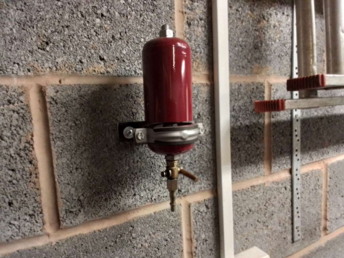

I doubt the NO2 cartridge would help much because it is far too small. I think I do have one somewhere – not an ex-nitrous oxide bottle but it once held compressed air, nitrogen or CO2, to supply a small bouyancy float.
A vacuum-brake reservoir’s pupose is to take a fairly large amount of air at low pressure-difference, to accelerate releasing the brakes. The ejector or vacuum-pump then exhausts the reservoir while the train is moving.
So it needs an appreciable volume.
A pressure-vessel in inherently weaker against external, than internal, pressure but even full brake vacuum gives well under atmospheric-pressure difference. The system already does have a pressure-regulator.
(Actually there was a craze in the 19C for high-jinks with that gas, not long after its analgesic – but well before its toxic – properties were discovered.)
If possible I want to keep the valve bush intact, to use with the valve itself removed. I have some BSP fittings I can use as “thread-gauges” more easily than a regular thread-gauge.
I suspect the “No Refilling” is more sales than safety, but clearly no-one wants anyone to try refilling a compressed-gas tin without understanding what they are doing. It also says the gas should not be released into the atmosphere… whence presumably it came.
The only practical problem there may be otherwise, comes from Dave’s warning that the wall is very thin. The small pressure-differentials may not worry it but corrosion by internal condensation could. The bottle is made to take just one filling of carefully-dried, inert gas, not soggy atmosphere.
So a reservoir made for the purpose may be better. Given the low pressure differential and necessarily modest diameter, this could even be of a rigid plastic like PVC, though external pressure calculations are much more subtle than the standard ones for internal pressure, by involving the length.
Indeed this reminds me I already have a potential vessel made of PVC, about the size of a blow-lamp gas bottle, and made to take more than a vacuum-brake’s external pressure difference. It was a scrap-bin find, originally part of some marine-equipment experiment or other.*
Nor would it hard to make a vacuum-vessel test-tank that can be connected to the club’s boiler pressure-test set, and intended not to exceed 30psi at twice w.p.
