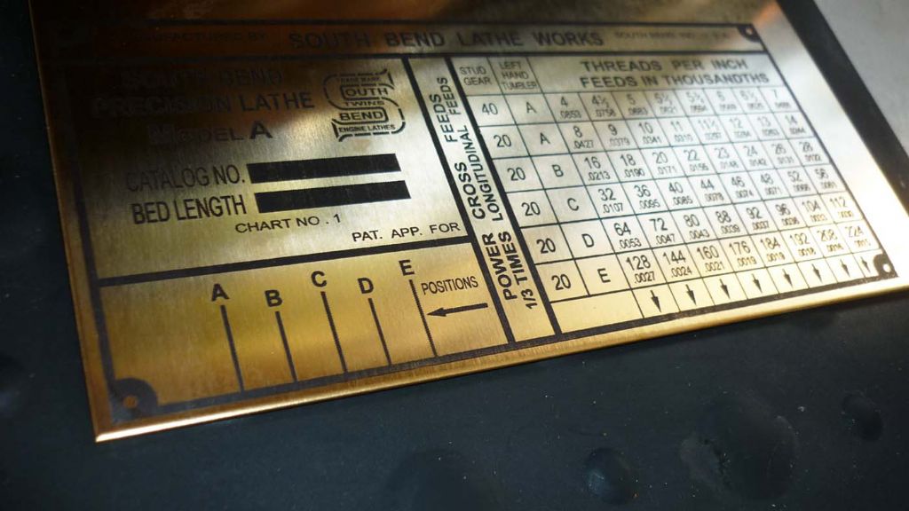

          mark smith 20
            @marksmith20

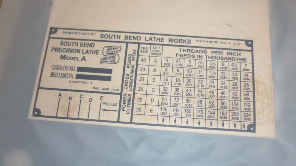

            p1250953.jpgUsing a laser printer and ferric chloride would probably work quite well at that depth of etch. heres a southbend lathe QC Gear box plate i did and it was my first attempt.
            Edited By mark smith 20 on 26/03/2017 09:53:45

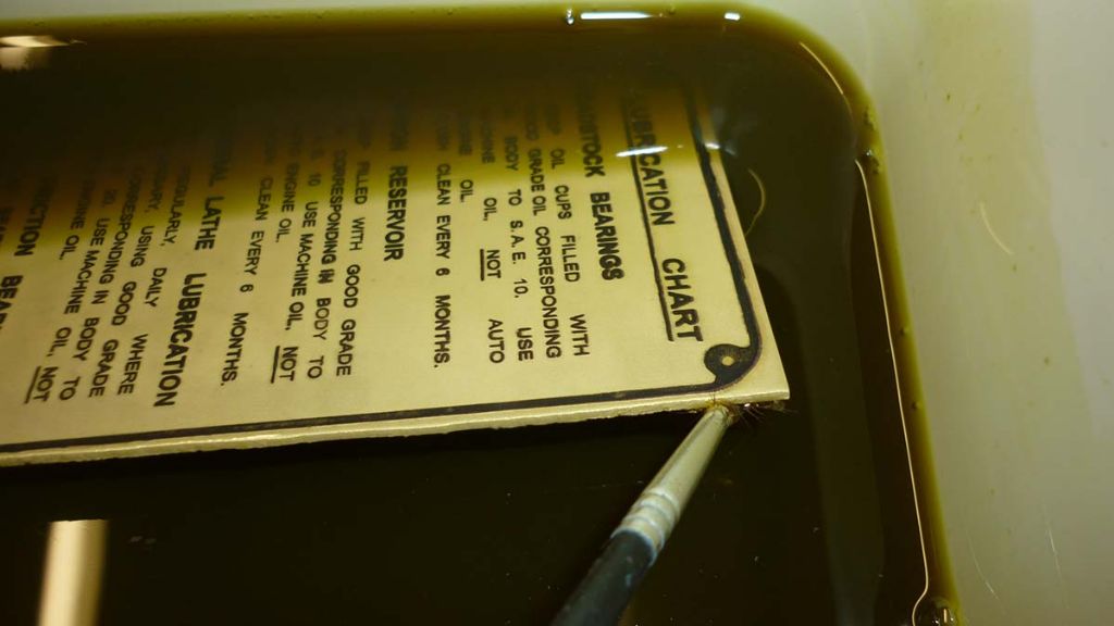

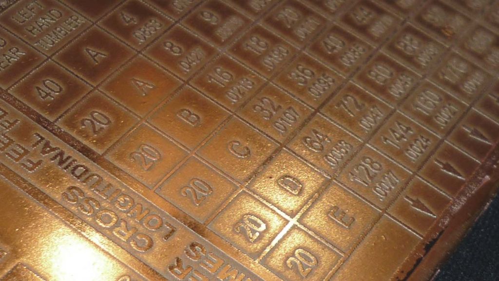

                mark smith 20
                  @marksmith20
                  Phil,
                  Its quite simple the hardest part is painting the plate.
                  I bought a cheap used laser printer off ebay.In my case a Samsung ML-1860. It had half the original toner cartridge still in (worked great) and later found out that cheap compatable toner cartridges dont work very well.
                  I printed out the reverse image onto mylar drafting film using the best quality and blackest print settings.
                  I then placed it over the brass plate which was cleaned and polished before hand with alcohol or acetone and ironed the mylar on a hot setting .
                  Carefully and slowly peeled off the mylar before it cooled too much and it leaves the black toner as a mask on the brass plate.If all goes well it should look like this.
                  I then coated the back with a couple of coats of shellac,quick drying acrylic varnish will do,just to stop etching on the back of the plate.
                  I then prepared a simple warm bath of ferric chloride in an old icecream tub. I didnt take much notice of the strength of the solution but probably about 25gms in 1/2 litre of water.
                  Then just put it in the bath and gently tilted the tub occasionally to keep te solution a bit agitated.
                  You can use a very soft brush to brush the surface but after a while the toner becomes sensitive to abrasion.
                  Heres a different plate in the bath.
                  Thats basically it ,clean off the toner with a dish cleaner scruber (like the scotchbrite pads).

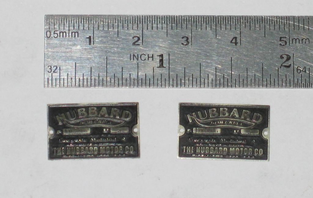

                            steamdave
                              @steamdave

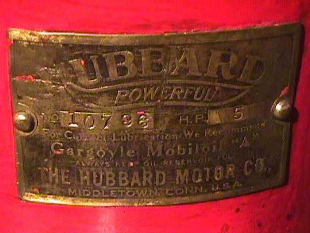

                              Some time ago I requested etched plate suppliers details because my original contact had domestic problems and was unable to assist me.
                              Contacting the suggested possible etchers did not prove fruitful, but lo and behold my original etcher came back soon afterwards and said the plates were ready. I'm very pleased with his work and considering the condition of the original plate from which he had to work from, and the small size of the replica I would say it is a a job well done. The cost was very reasonable, too.
                              If anyone needs etched name plates, then I would have no hesitation in recommending Peter's Plates
                              http://www.petersplates.co.uk/
                              The Emerald Isle

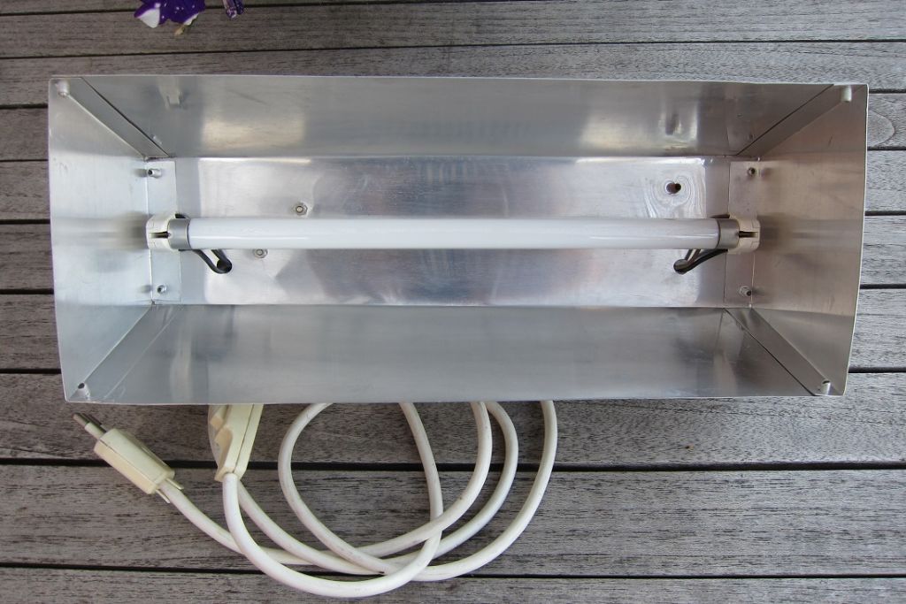

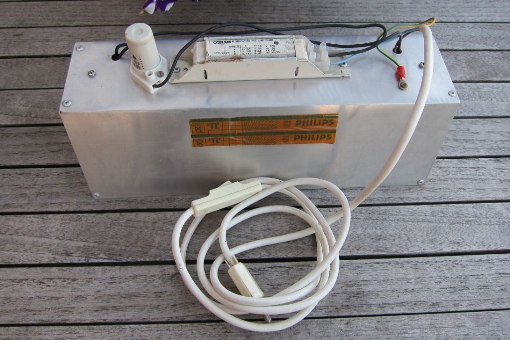

                                    Massimo Dalmonte
                                      @massimodalmonte45801
                                      "I use photo etching, bit expensive for a one-off unless you use sunlight as a UV source.
                                      Neil"
                                      Not necessarily so, here's a little contraption I made with aluminumm sheet, pop rivets and parts from the scrap box when I bought some photoresist PCB laminate at a fair; the vendor told me I could use a Philips TL 8 W tube (standard tube, but it seems they "leak" some UV radiation) for 90 seconds at a distance of 7 cm.
                                      You simply put the "mask" (artwork on a printed drafting paper, best with a laser printer, but inkjet was about the same) on the pcb, a piece of glass over the two ( I quickly took it from a small display case I have, just to show that I'm a casual pcb "developer"…) and this gadget on top.
                                      Results where consistent ( I always turned it on for a few minutes before using it on the pcb, to be sure that it had reached it's working temperature) radiation bounces on the inner walls. Working area 32×13 cm, TL tube axis height (guess…) 7 cm.
                                      I searched now, and found that you can buy UV TL tubes, anyway I think that a standard tube is safer, as the exposition time is longer and plusminus a couple of seconds won't ruin your pcb.
                                      Anyway experiment on small samples of the pcb laminate you have before trying "full size".
