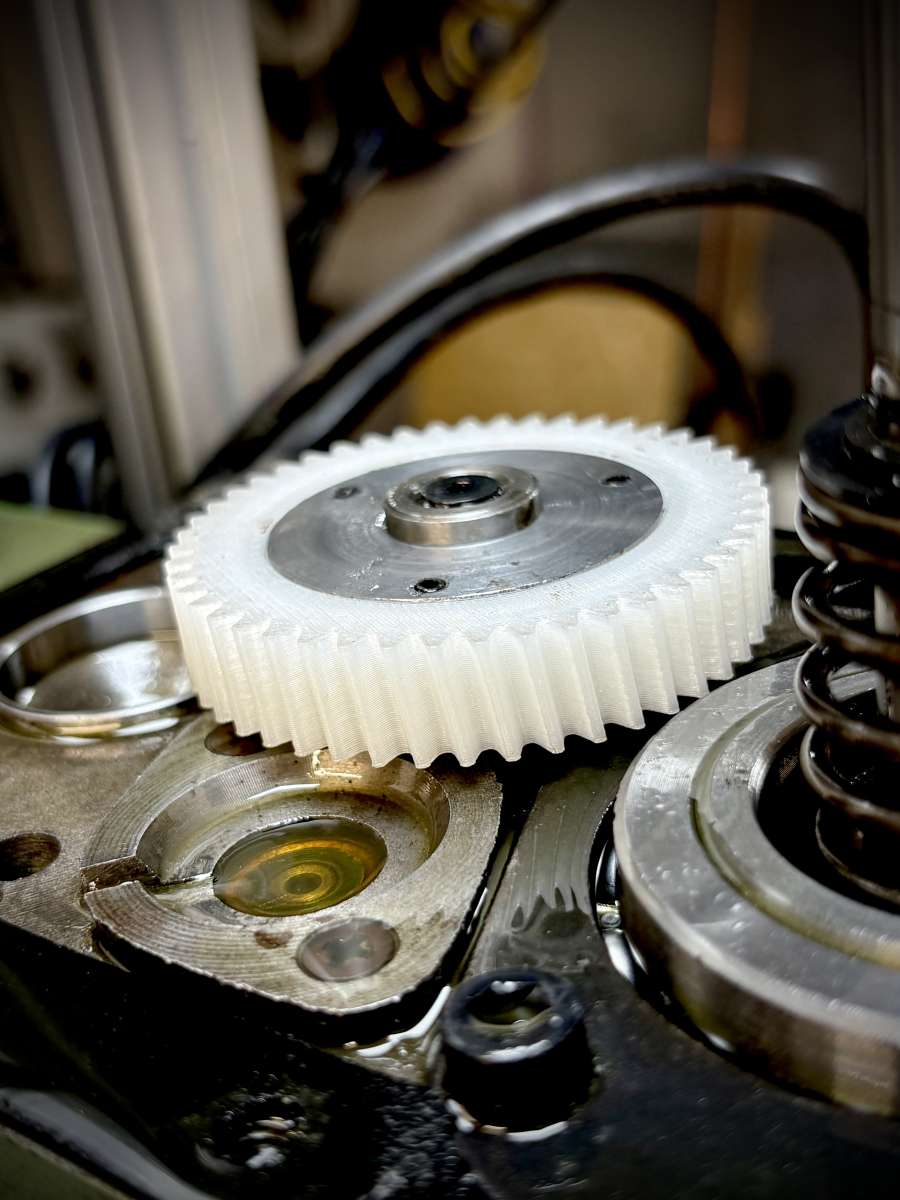

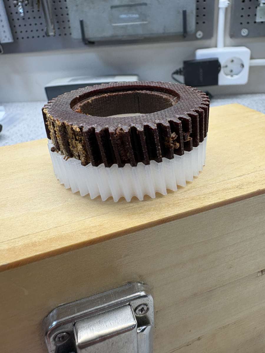

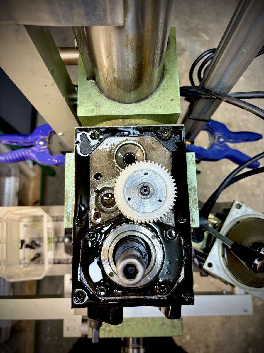

                                          #871042
                                          engineeredbyhansson
                                            @engineeredbyhansson
                                            On mgnbuk Said:
                                            Didn’t go back far enough on this thread Gray – gone back to the start now & see what was previously written, thanks.
                                            I printed the 47 tooth gear from thingiverse this afternoon and it is nothing like correct – the helix angle is only around 3 degrees and the OD is only 58.5mm. Difficult to see how it could work & I have contacted the poster of the model for more information.
                                            Nigel B.
                                            Hello,
                                            I’m new in this forum and also a new FB-2 clone owner. My 47-teeth gear broke the 2nd day I used it. I designed a new one and 3D-printed it in nylon. It has held up for a while now with no worries. I also 3D-printed new gaskets in TPU.
                                            Really love some of the improvements I’ve seen in this thread. Really inspiring! I have some ideas on my own that I want to start working on soon.
                                            IMG_2616IMG_2558IMG_2556
