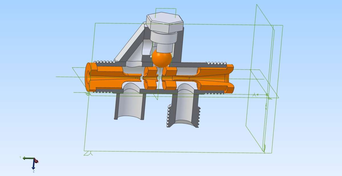

      I was trying to use the drawings in D.A.G. Brown’s book Miniature Injectors Inside and Out, mainly as an Alibre Atom exercise but also to see if if there is an easier way to make the overflow conduit than his method. I’m sure it works for him but I am not convinced it would for me.
      I was hampered by the drawings having been reduced to fit the A5 pages, and by the random use of binary fractions among mainly decimals. Also, some parts were not very clear.
      Anyway I came back to the exercise over the last few weeks and this evening completed it, for the 8oz/minute size. Mr. Brown uses a common body size for three or four capacities.
      One aspect I was prepared to see fail was how I drew the two-part combining-cone. I started it as if solid, then used Revolve Cut to remove the centre section, not knowing if the two parts would stay together across the gap.
      They do!
      I don’t know if its location along the tube is right. I used an auxiliary plane set from the body’s steam-inlet face to place the downstream face of the combining-cone division, making the division symmetrical with the ball-valve. Though useful as part of a CAD exercise it might not be correct for the real version, in which the penetration of the steam cone in the combining-cone is critical.
      Those threads are 1/32″ pitch but not helices, just symbolic parallel ridges.
      Is it correct though? Or have I muddled up the original drawings? Is the gap between the combining-cone outlet and delivery-cone inlet usually in thin air? I had to examine one, using the same illuminated magnifier (bought at MMEX last week!) that helped me read the book’s drawings, to establish that is indeed so.
      Whether I’ll try making the real thing I don’t know, but it was quite a challenge just to model it in 1s and 0s.

        The model looks pretty good.
        More recent versions of Atom3D include the capability to include either real or cosmetic threads, both internal and external.

          I thought you said you couldn’t model in 3d. 😉
          Looks good to me.

            I have absolutely no idea what it is that you have drawn, nor what it does, but my, what a vast improvement in your 3D skills it represents!  10/10 for perseverance.  Well done.

              An “injector” feeds water into a steam-boiler in a decidedly non-intuitive way, using a small jet of steam from the boiler and neat energy-conversion physics in those converging and diverging “cones” (nozzles).
              Water enters at the bottom right, steam at – or by the time it gets there slightly under – boiler pressure at the right-hand end; hot water at above boiler pressure emerges from the left-hand end to be piped to the boiler inlet.
              The ball-valve on top opens an overflow to help it start, and to re-start automatically if the water supply is briefly interrupted (e.g. by surging in a locomotive or traction-engine tank). I don’t know how – but guess the overflow eases back-pressure to let the flow conditions stabilise.

              I couldn’t learn TurboCAD’s 3D model system to any useful level, despite some years of fighting it. It was that which put me off 3D CAD. You can use TC in orthographic mode only if wished; and that is still useful to me occasionally.
              Alibre lacks that choice by default; but it’s 3D basics are easier to learn and tutorial material is easier to find and more digestible.
              In some respects its tools are more powerful than the TC equivalents, too; especially its active dimension controls and its Parts and Assembly files system; and is more direct in action so easier and more convenient to use. My first dip into Alibre Atom was the scribing-block exercise in serial form some years ago in MEW.
              Alibre ‘Atom’ and TC’s ‘Deluxe’ are the most basic of their respective edition ranges, lacking many of their more advanced industrial-grade tools; but still very well equipped for most amateur use.
