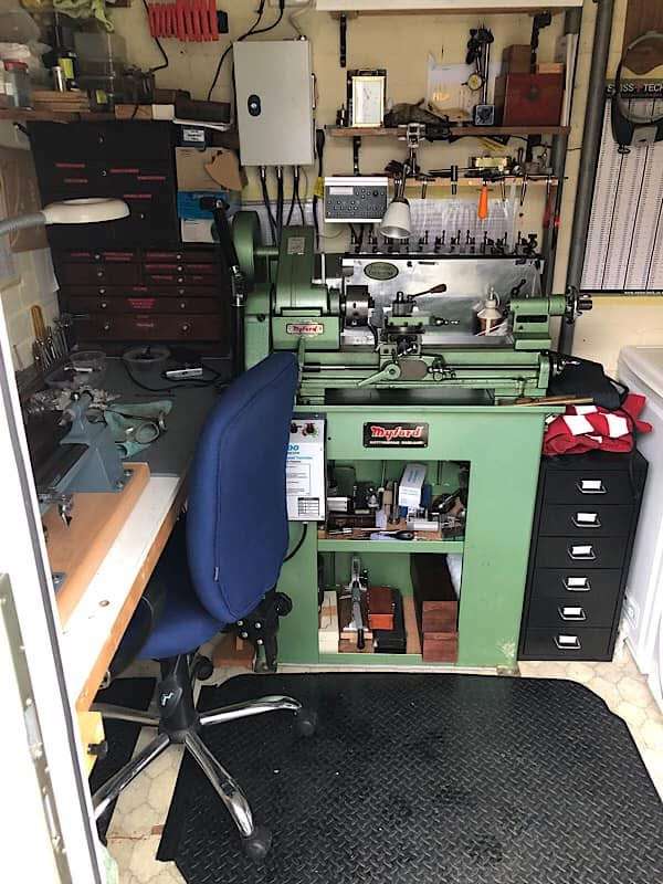

            #869834
            Dell
              @dell
              My Myford 10 has it’s own cabinet so can’t help with the bench construction but space shortage is something I am used to, make sure you make plenty of storage space under the bench & add a splash back so if you have QCTP you can store the holders on it for easy reach, I have Rocketronics on my Myford so don’t need to change gears but you need enough space to be able to see & change them.IMG_4191

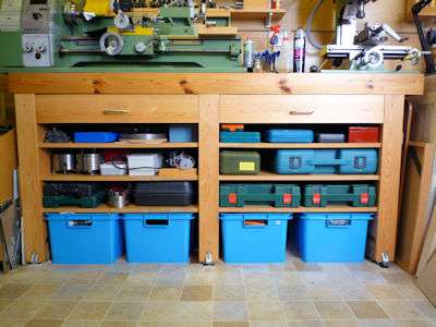

                  #869837
                  Journeyman
                    @journeyman
                    Might be a bit in here that helps – Journeyman’s Workshop – Benches & Worktops (scroll down a bit)
                    machinebench
                    Been in use for an awful lot of years now.

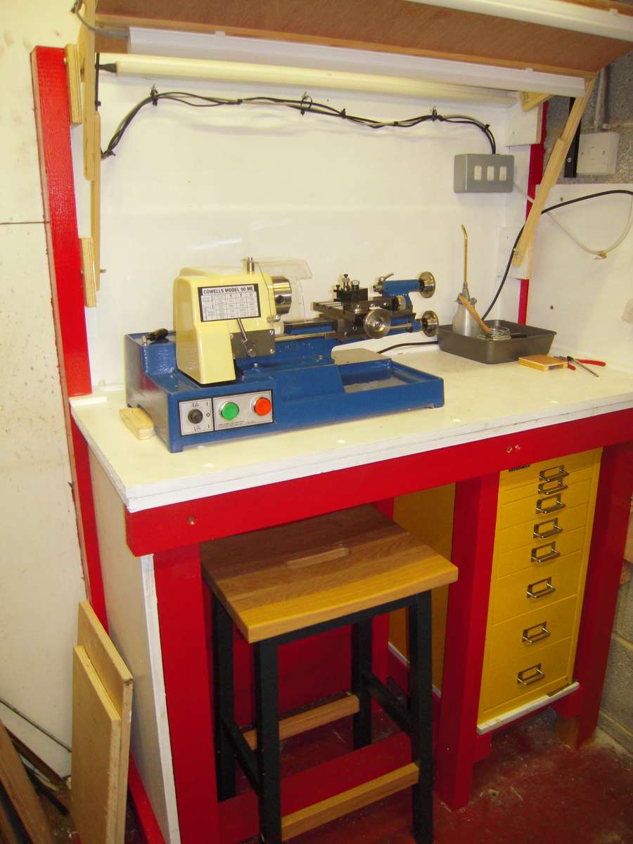

                    #869851
                    JA
                      @ja
                      DSCN8936
                      JA

                        #869854
                        starjump
                          @starjump
                          Hi @dell thank you for your message and the photo! You have a really lovely set-up.
                          I’ll try to learn from you and others. Today I have must continue clearing a space, I’ll posts some photos in a day or two to show what I have to work with and if there has been any progress.
                          Thanks, Starjump.

                                #869862
                                starjump
                                  @starjump
                                  @ja Thank you for your picture – what a neat installation! Best, Starjump
