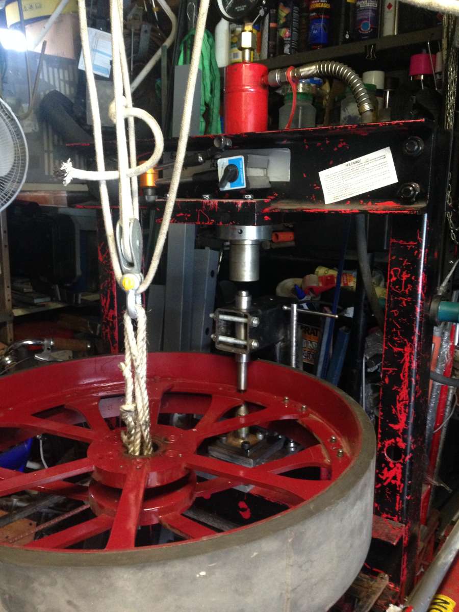

        I used a similar press (bench version, but 10 tons) to set 3/16″ cold iron rivets.  Worked well, and from memory took 4.7 tons to set them properly.
        I made a riveting jig for the wheels – the bottom set is removable:
        Capture1
        Cheers, Jez.

                    Similar to the posts above, I cold pressed the rivets on the wheels of my traction engine.  The rear wheels are 24″ diameter with 5/16″ rivets. Final force needed to close the rivets was about 15 tons which was done in 3 stages with 3 different shaped snaps.  A jig was fabricated to guide the top snap.
                    Wheel Rivets

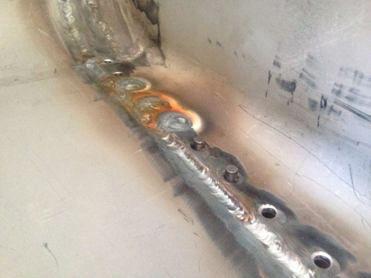

                        have you ever seen welding that bad
                        #869979
                        John Hinkley
                          @johnhinkley26699
                          Yes!  When looking through the sheild at my first attempt at stick welding 40+ years ago!
                          I’d be pretty ashamed to show that on YouTube.  Not even a visible attempt at grinding it down a bit!
                                  That’s what we used to call chicken sh*t welding, I’d be ashamed to put that in the public domain
                                  #870089
                                  Nicholas Farr
                                    @nicholasfarr14254
                                    Hi, believe it or not, but I’ve seen worse welding than that many times, and some have been in a worrying situation, some of which even Angels would fear to tread.
                                    Regards Nick.

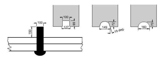

                                          Attempting to press and form 1/8″ diameter rivets is going to be difficult because they do not have much mass and will cool quickly, especially as soon as they are inserted into holes that are cold. They have to remain red hot for rounding the head.
                                          We recently replaced 5/8″ thick plates on the firebox of a full size engine with 3/4″ rivets which was a 3 person operation. The rivets were heated to red hot in a furnace and at the same time the plates were warmed with a large blow torch by a second person. When red hot the rivets were quickly placed into the holes in the plates and kept hot with the blow torch while a 3rd person positioned the hydraulic squeezer and formed the rounded head in a single press.  The whole operation of taking the rivet from the furnace and squeezing the rivet was about than 30 seconds. The squeezer had an 8″ dia cylinder at 2000 psi, producing about 50 tons of force. (Note. Instead of a squeezer, a pneumatic hammer with suitable snap con also be used to form a round head while the rivet is still red hot)
                                          If the rivets are on the outside of your engine frames and they only has to look like a rivetted structure, they can be welded on the inside of the frame, out of sight. This how I made the tender/water tank on my traction engine. Welding the rives also ensure that they are water tight.
                                          IMG_1086
                                          Cold forming the head of a rivet should be done in 3 stages, using different shaped snaps, which is how I rivetted the wheels on my engine.  See details below, based on the diameter of the rivet.
                                          Rivet snap

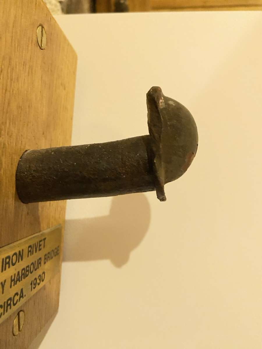

                                            This is a rivet taken from Sydney Harbour bridge during repairs.  Its 3/4″ diameter and the hot forged head is well off centre, but it worked until the rusty section of the structure was replaced.
                                            Bob
                                            Sydney Rivet
