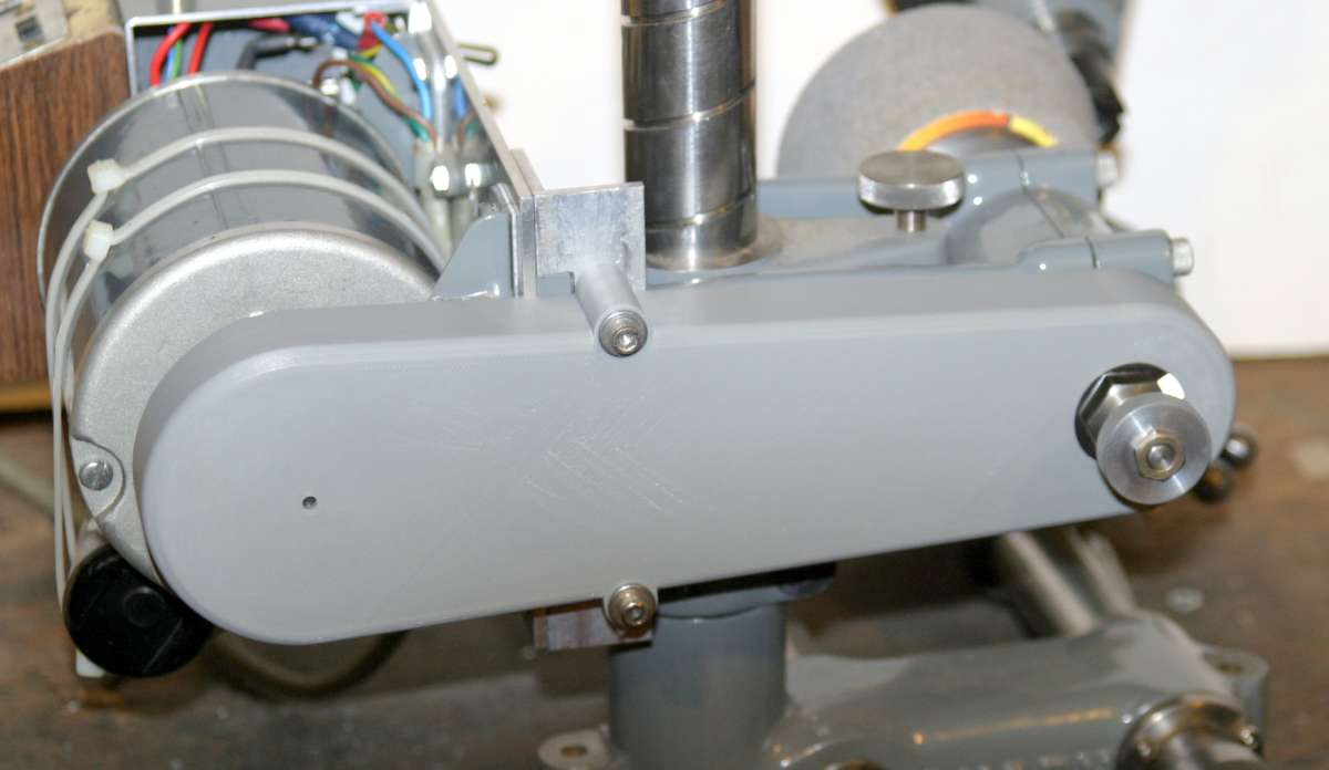

      Now that I have a 3D printer I decided I should print a belt guard for my Quorn Mk1. I have only been using it for 10 years without. To be honest it was the article in the last issue of MEW by Alan Bryan on “3D printing in the Home Workshop” that got me thinking about it.
      Next I guess I should look at a wheel guard. Not sure how crash resistant it would be out of PLA (PETG?). Perhaps make it with 4 or 5 wall loops, 50% or more infill, and a total thickness of 4-5 mm it would be strong enough to resist a burst wheel?
      The small hole at the left end was for an 1/8″ pin with a 60 Deg. point to register in the end of the motor pulley to aid in positioning the guard centred on both pulleys to spot through for the mounting bolts.
      BeltGuard
      BeltGuard1

        I don’t think I’d completely trust any of the usual 3D printing materials as a wheel guard if a stone were to explode. Unless you go for one of the fibre reinforced one, then PETG might be your best bet as it won’t shatter to quite the same extent as PLA or ABS.

          If you want a guard make it out of metal, as thick as you can manage, I have seen a couple of grinding wheels shatter and it is not pretty.

            ONLY use steel for a wheel guard 1.6mm +, printed plastic will not contain an exploding wheel spinning at 3000rpm or more. Noel.

              I had initially posted a response with a proposal to line the guard, but having looked at your photo again, I realise that it’s NOT a wheel guard at all – it’s covering the drive belt as you state in the thread heading.  I misread that, too.  I would have thought that PETG might be better choice or even carbon or glass fibre reinforced filament.
              Neat looking design, by the way.  The finish appears clean as well.

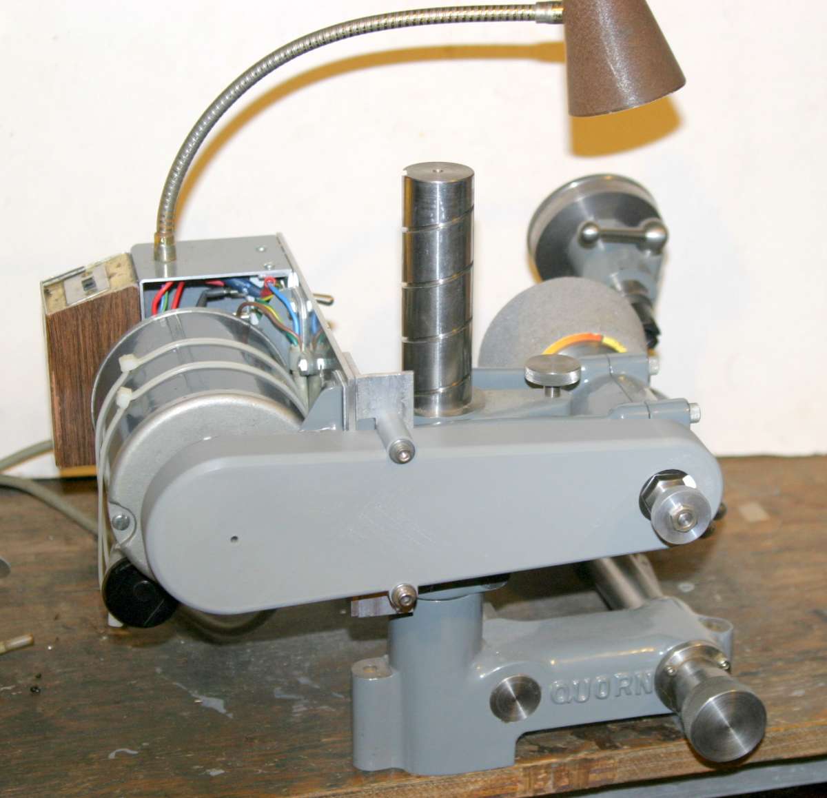

                    That is a very nice belt guard. Is the machine light a home brewed thing or is it commercially available?

                            The machine light is a re-purposed old reading light of my grandfather’s (circa mid 1950s) with the goose neck removed and re-mounted on the top of the switch box. It uses a 12V #93 car parking light bulb, the transformer and a two position switch are in the original brown box seen on the back of the switch box. I had been using it sitting on the bench but it was never in the right place or always getting in the way.
                            I though about publishing the files but I am not sure how much use they would be, as others Quorns would have to have the same centre distance between the motor shaft and the spindle for it to fit. Also the mounting holes would have to be in the same location. If you want the files just PM me your e-mail address and I will send you both the FreeCAD and .stl (or .step) files.
                            As far as my comments on the WHEEL GUARD goes I was just thinking out loud and they seem to have enlisted some very definite opinions! My initial thought was to make a cast aluminum one, which I think, is probably the way I will go.
