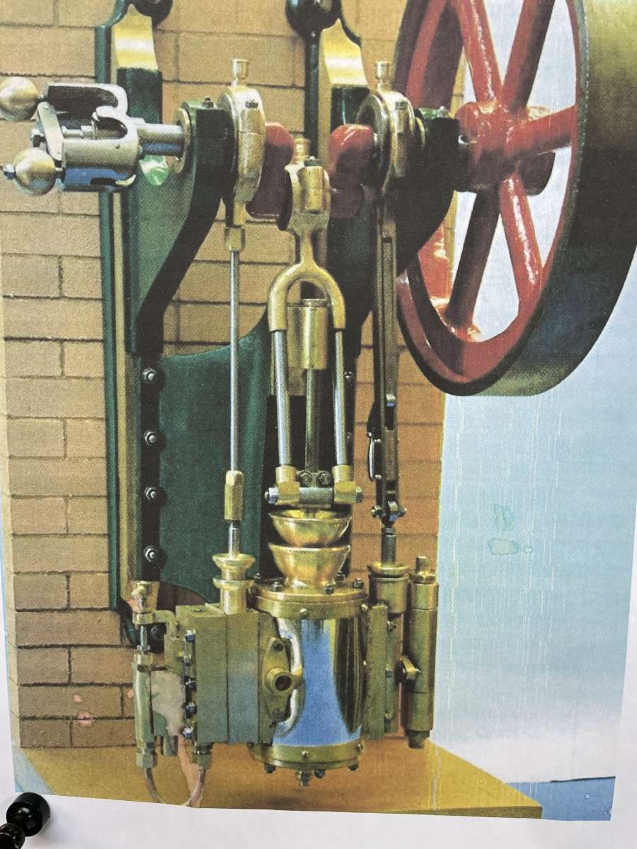

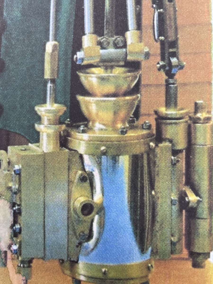

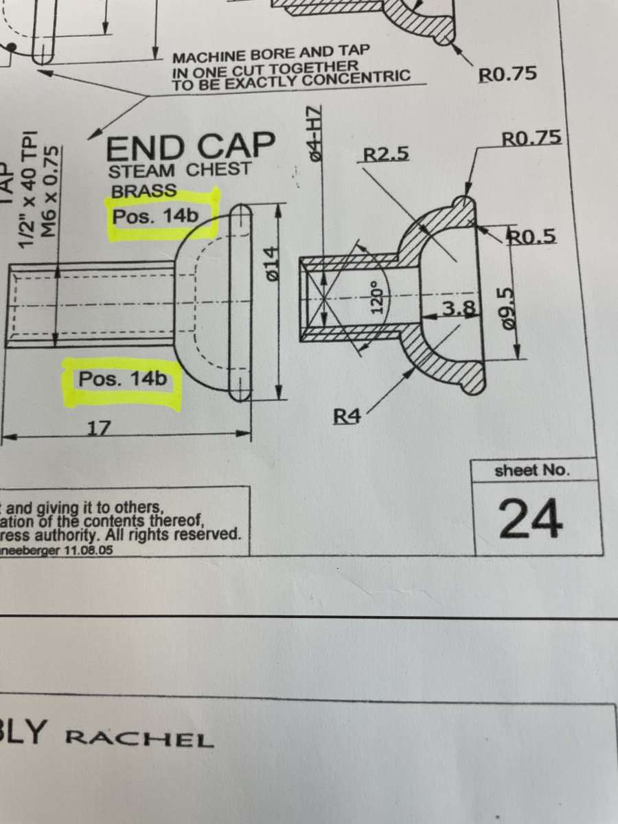

      I’m struggling with my latest casting kit which is the Rachel Wall engine from EKP. The drawings have some missing dimensions but I can work with that. Not quite ready to move to the part I need help with yet but thought I might start to ask for advice sooner than later.
      I haven’t yet made a part that’s cup shaped and I have two to make as seen in the photos.
      Im not aware of the sort of tools I would need and how to machine them.
      Any help please .
      Steve
      IMG_2244IMG_2245IMG_2246

        Also the two larger ones on the cylinder one of which is part of the end cap.

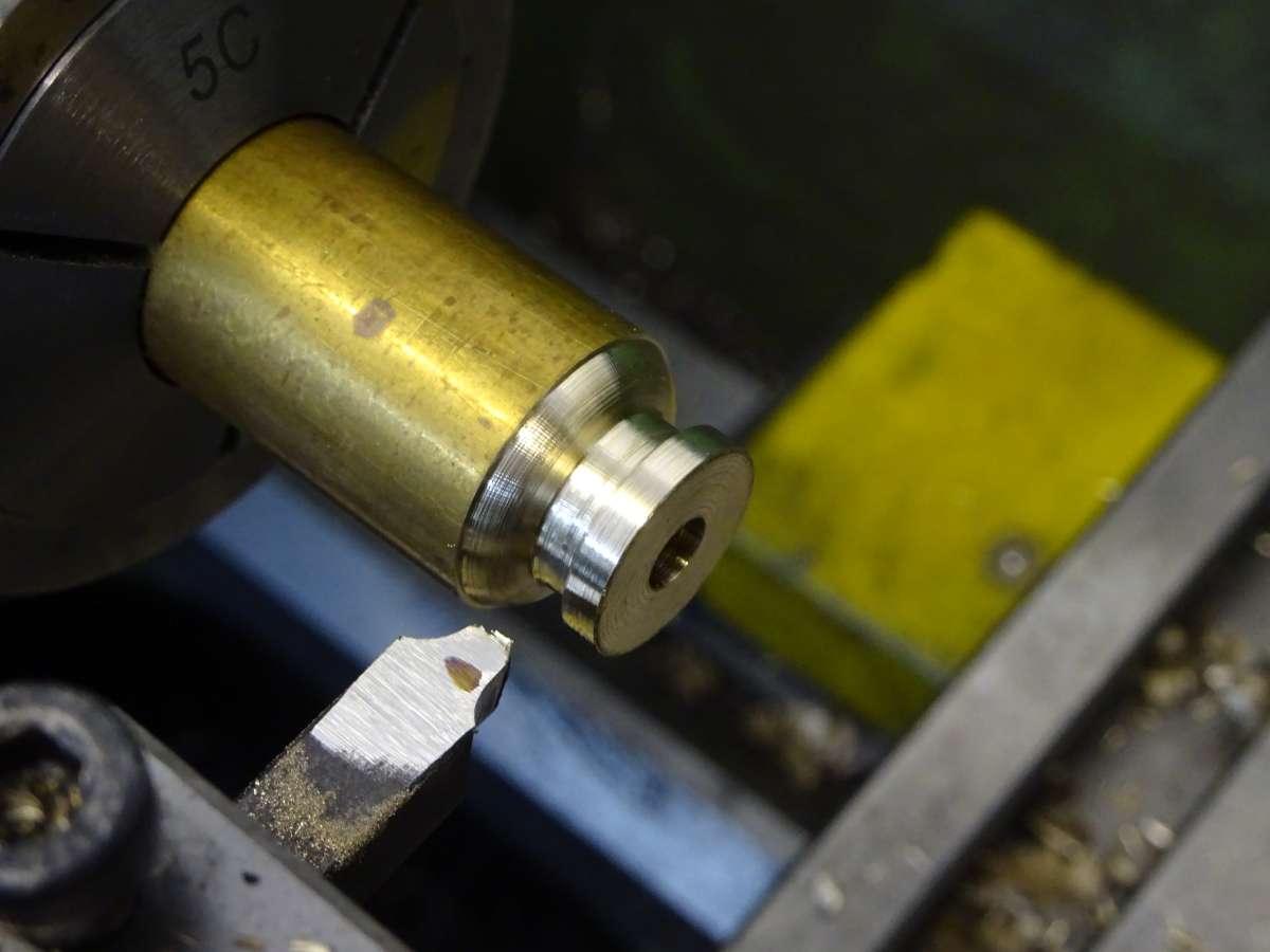

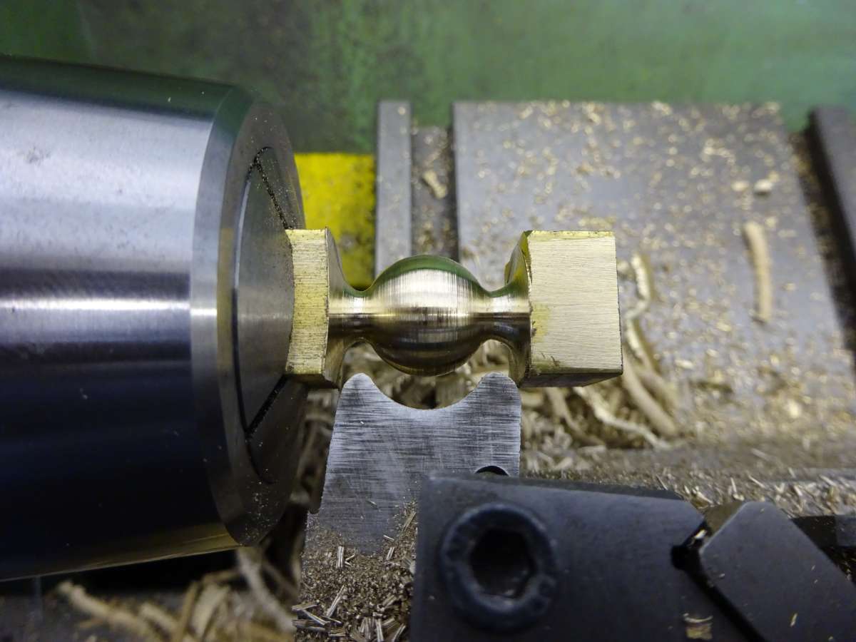

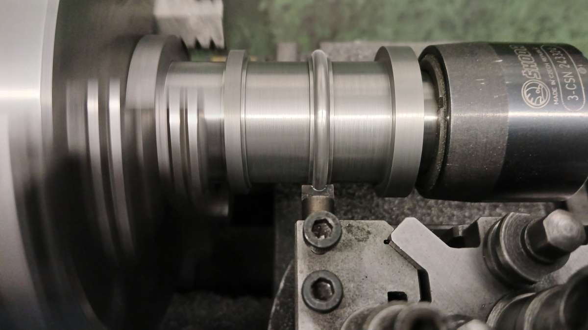

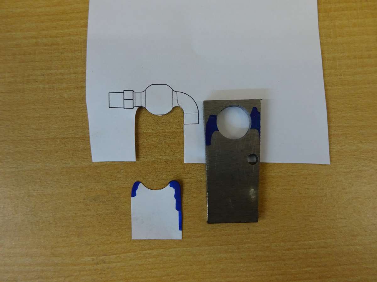

          Form tools are ideal for this. You can use a piece of gauge plate and machine the profile into that so for the outsid eof the cup I would drill an 8mm hole and then use a 1.5mm endmill to form the bead. Harden and then feed that into your work.
          Or you could make two separate tools, one a 1/4 circle and the other a half circle and do it a bit at a time.

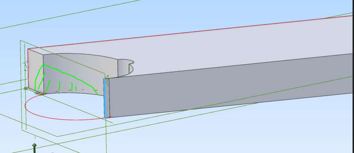

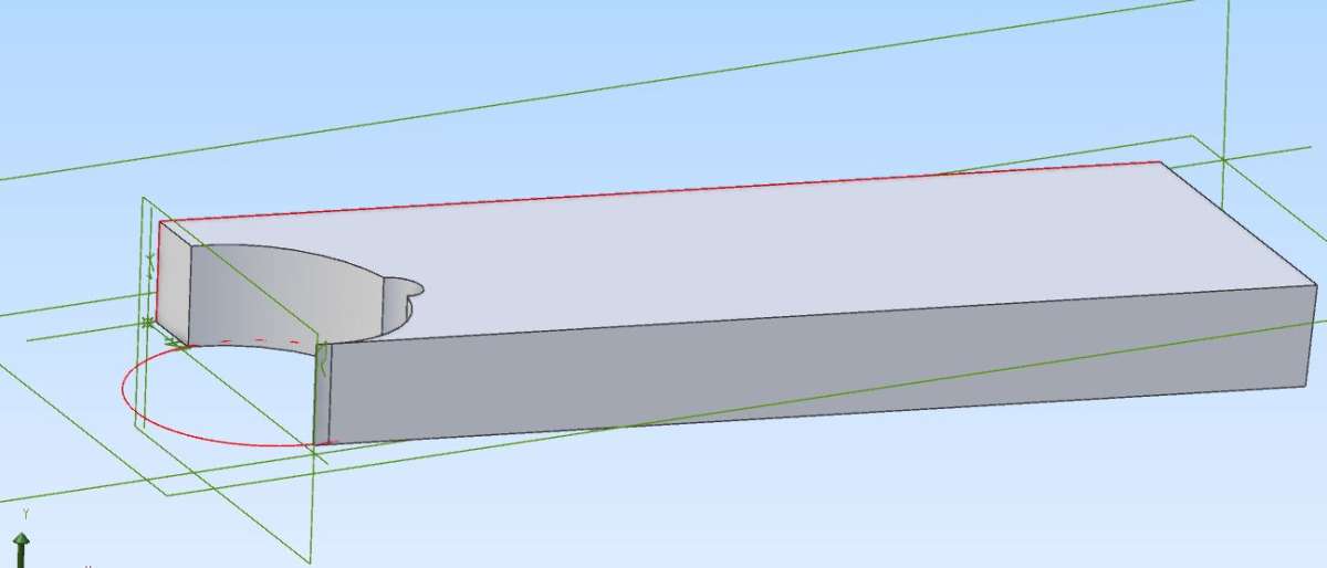

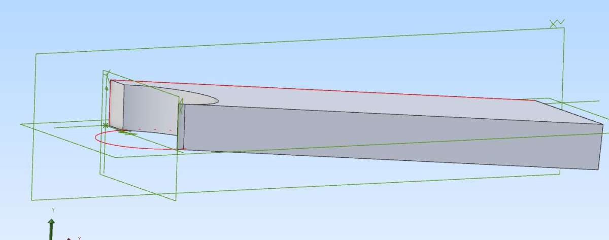

                  You can machine it with HSS no problem, not quite as free machining as EN1A but basically the same as silver steel.
                  The easy way to get some relief is to hold the piece of bar at an angle of say 5-7 degrees in the mill vice.
                  Provided you don’t have too much sticking out the tool post, something like 10mm x 3mm or 3/8 x 1/8 would do the job.
                  I just heat the working end with a blowtorch to cherry red and quench in water. I don’t bother about tempering.
                  Hold at an angle, mill across the end then using an 8mm cutter form a half circle, depending on your mill you may be able to feed in sideways or if less rigid make a series of plunge cuts moving the work over in say 0.5mm steps.
                  form 1
                  Take a 1.5mm cutter and form the half round bead detail, I would definately plunge with this, 0.1mm stepovers
                  form 2
                  Probably not needed on this simple form but you may find the sides needs a small amount of relief which can be done with a half round needle file before hardening.
                  form4

                        I do it exactly as Jason suggests, so quick and easy that way, after all the job is more or less a one off or two off. I have tool holder that holds a short piece of gauge plate, so easy to hold a wider piece, this did not take long to make either, size will depend on what lathe you have. Just watch out for chatter if it is a wide cutting edge, i sometimes make a final light cut turnng the chuck by hand to eliminate the chatter.
