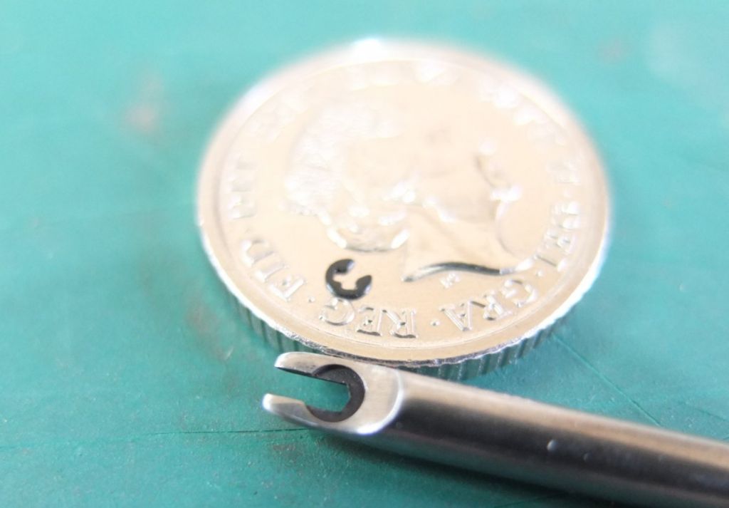

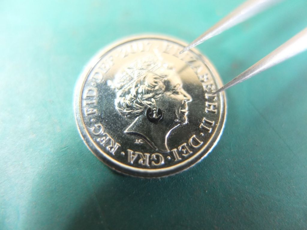

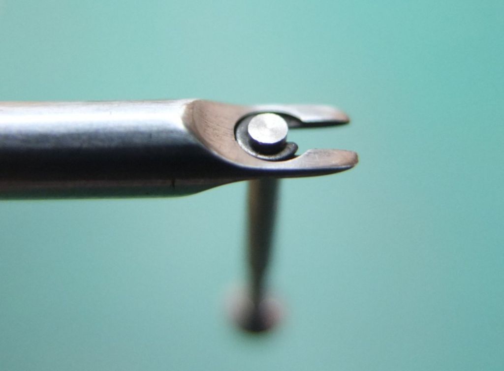

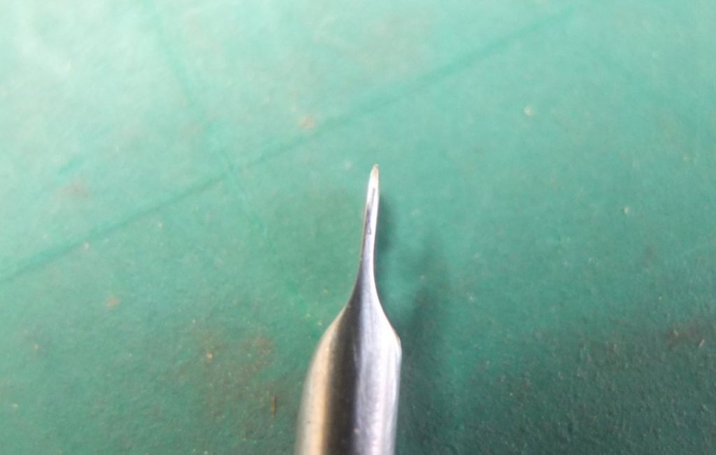

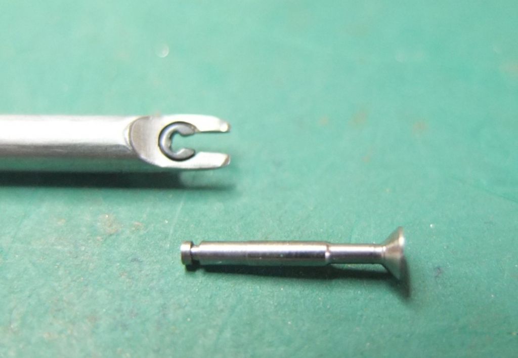

      I need to retain a compression spring on a 1.2mm shaft using a small e-clip.
      And boy, are they small.
      I need my finest point watchmakers tweezers to handle them. They are 2mm od, 0.2mm thick and fit a 0.8mm dia groove. Despite their size, they need a fair bit of pressure to engage.
      I made a tool to both depress the spring and fit the clip. It was milled from 3mm silver steel, hardened, tempered and polished. Works a treat.
      The photos are self explanatory.
      Now I need to make a tool for removing them without the "ping"!
      Steve

                            The tool you have made Steve is similar to the factory made insertion tool. Main difference is :-
                            A. cross section of slot was a dovetail shape so clip could not ride up.
                            B. Blade was slit behind the recess to allow sideways spring opening of clip lips.
                            Spent many hours in the toolroom at Andertons milling the b****y things, a different insert tool for each "e" clip.
                            Regards Ian.

                              donkey
                                @donkey
                                why can't you use the same tool to remove them by pushing at 180 degrees to the installation direction

                                    " Did you make them as small as this?"
                                    Yep, and the smallest sizes were once deleted from catalogue. The guy that ground the carbide punches for that size press tool left and it was hells own game finding his replacement. Punches ground on an OPG (Optical Profile Grinder), Tricky machine to operate, bit like trying to control a model helicopter.
                                    "why can't you use the same tool to remove them by pushing at 180 degrees to the installation direction"
                                    Needs a slot grinding behind where the back (closed end) of the clip is to allow the valve stem clearance.
