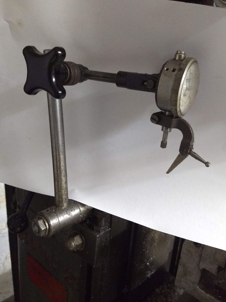

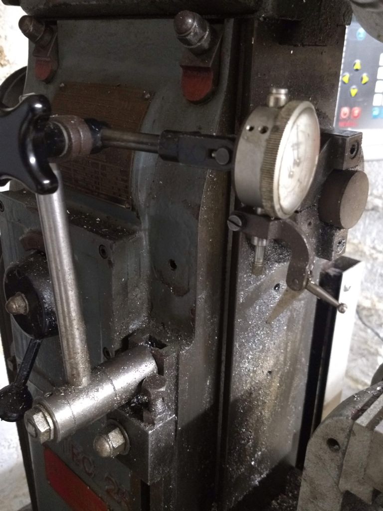

                      Here's what I did on my Centec 2B. I mounted it in the channel used for the Z-axis limit stop.
