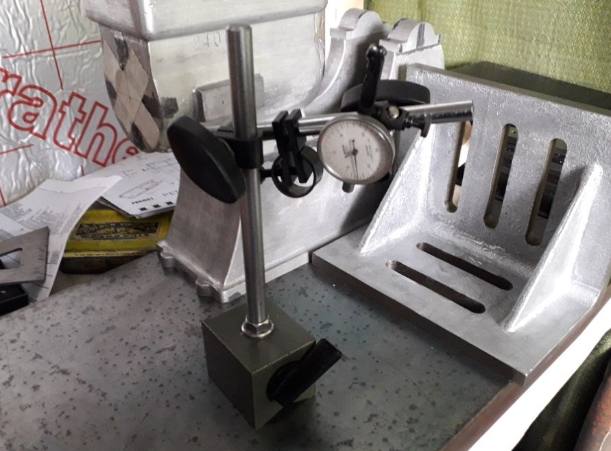

        I currently have a magnetic dti base that is ok for use on the lathe but a pita on the mill, I can never seem to get the clock, usually a plunder type or the finger type shown where I want it to be. The knobs are on the large side the fine adjuster seems to get in the way and its just too big really.
        I looked at the snake neck type but they are eye-wateringly expensive so considered the ball joint type but they seem to have a mixed press. I may just buy the arm as I have a couple of mag bases and see how it goes.
        Would anyone like to make any other suggestions before I bend the credit card again?

          This hydraulic one is my go to mag base unit.
          Martin C

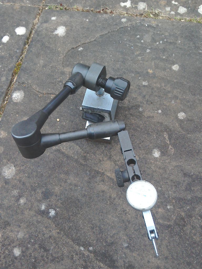

            If you are thinking of getting one from Amazon have a look ***HERE*** for my review. Basically just don't!

                I would just add that my experience of the snake neck type (if we are talking about segmented type with a central cable to pull it tight and lock it) is that they should only be bought from someone who will refund your money if you are not happy with it!
                Martin C

                  Ditch the fine adjuster bit and if necessary use an ordinary bit of steel for that arm. Replace the adjusters with normal bolts with a smaller wing nut shape soldered on.

                    I just looked at your review. It reminds me of bang whotsit items. Only buy if you can afford to throw it away. I’ve got one similar to that one – likely from bang whotsit. It simply does not get used. The magnetic base is not that magnetic and it is small. I still use my M&W or Eclipse all the time.
                    Good of you to be honest and not one of those reviewers on the kit supplier’s payroll (free gifts and percentage commission on purchases made through their referrals) who make loads of misleading(?) reviews that eulogise about kit that is not that good
                    To Henry – Buy cheap, buy twice. It is something that you need to use regularly, so a good quality item is a must, as far as I am concerned. Yes, positioning is always a problem with a small mill. A clock of any description is most usefully mounted to the spindle or spindle housing in my experience.
                    I bought attachment from Arc **LINK** and find it most useful on the mill.
                    I’ve only used it with a dti so far, but that is what most measurements are for – comparative, not absolute.

                        I bit the bullet and bought a Noga, I think it was Stefan Gotteswinter who demonstrated how much an arm moves by mounting a base and indicator on a plate taking a reading and then inverting the whole thing and noting the change in reading. The Noga is quite good at being completely floppy so you can position the indicator and then tighten using one knob, not cheap but the imitation ones don’t seem to get it quite right, a bit of work can improve them though. Also consider some other fixtures for an indicator, toolpost mounts on the lathe can be useful and other fixing points on the mill can be made. A regular task is probably checking the vice so a fixing to hold the indicator in the ideal position could be very convenient. A mag base is very versatile but it does rely on a flat surface to be available in a useful place. I would have reservations about the rigidity of the snake arm type for an indicator.

                            Mike – I'm considering making something like the ARC one, maybe a little more beefy. Interesting that you are not keen on the snake type.

                              I bought one of the quill clamping arms NDIY mentioned from Machine DRO via Amazon. It is rated
                              Quill Clamp Range – 40mm (1 10/16" to 52mm (2" so should go round your quill OK.
                              Use Universal Indicator Quill Clamp for DTI, in the Amazon search box I've only used it once for checking the chuck was central on a rotary table but it made the job easier

                                  The genuine Mitutoyo one works remarkably well.
                                  Many of the others probably demonstrate what Ruskin is alleged to have said [*]:
                                  There is hardly anything in the world that some man cannot make a little worse and sell a little cheaper …

                                    Henry, not easy to see in the photo but the base has Mitutoyo on it. You can't see the face of the knob but that also says Mitutoyo.
                                    Martin C

                                          MichaelG, I think my issue with the snake neck was not so much the rigidity of it but its lack of flexibility in positioning.
