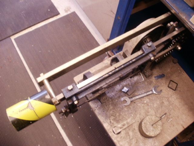

      So, as I really like Donkey's I found myself my own little mechanical one. Really nice chap by the name of Dave was advertising this for sale so I popped round this morning and picked it up. It is a set of Blackgates castings and the castings themselves have been well machined. I show it with the original quarter horse boat annchor in both pics but this motor has already been donated to my local scrap man. I have a nice new, quiet and efficient replacement in a fetching blue you can see in the second pic. I want to place this new motor here in the new configuration as the finished item will have an overall footprint of 7" x 18", I already have a sheet of ally plate ready for it and this is nice and compact to sit on a trolley under the bench.
      The thing is, this is not really useable as it is. There is no cutoff switch for instance, there is no damper either and I think that is important.
      So tomorrow I am going to reduce it to it's component parts and begin a rebuild – oil dashpots for instance on the shafts are something I will be adding. But if it was yours – what would you add and where could I adapt a damper from? I look forward to suggestions.

          Looks good. I would suggest a car hydraulic damper( hols open boots and the like or it.. A NVR switch with a rod to activate it would be wise? Also a short roller at cuttu=ing height on the motor side to add support. MEW had a few good suggestions for bandsaws a while back.
          Have fun! Ian

              As its bedtime, without going in to detail I would suggest a small dashpot damper as is used on the Kennedy hacksaw. You can see some pictures on lathes.co.uk, or let me know if you want a bit more info.

                Unlike Johns Axminster device the little Kennedy power hacksaws work just fine with a damper. The Kennedy takes a standard hacksaw blade and is probably around the same effective size as the Blackgates machine.
                As I remember things correctly from a quarter of a century (ish) back the Kennedy in the departmental support workshop had a damper dashpot about 2" diameter with a fairly loose fitting "piston" effectively comprising a pair of thick washers with a couple or three large holes drilled in them. The amount of damping was adjustable via an L shaped rod sticking up through the middle which rotated one "washer" with respect to the other so altering the amount of free oil passage through the piston. About 1/3rd of a turn adjustment covering a range sufficient to let the beast cut adequately fast on solid bar yet be reasonably under control when dealing with reasonably thick wall tube. Waterpipe and the like. Very thin wall tube, such as Speedframe, was a bit too much for it. I imagine there was some sort of flap valve included so that the oil didn't get spalshed out when the unsympathetic hoiked the arm up rapidly. There was still noticeable drag when lifting. When the beast was running a certain nodding of the carrier arm could be seen. Probably not enough to indicate actual lift but certainly suggesting a reduction in blade down pressure on the back stroke. Some sort of geometrical magic going on.
                Allegedly oil specification is important but ours seemed to work just fine getting a splash of whatever was handy when I noticed things getting low. No one else cared and the place wasn't exactly a regular haunt so for much of the time the oil level would ahve been wrong. Dashpot seems to have been a refinement rather than necessity as the saw still worked pretty well with it near empty. Decent write up on http://www.lathes.co.uk whith probably enough detail in the pictures for you to scale off.
                Clive

                    The first "washer" you mention is in fact the piston, about 1/4" thick, with the holes in it. The second one is a thin disc (shim thickness) which can move up and down to either cover the holes or uncover them and let oil pass round it in the lifting position. Adjustment as you say, by a rod, threaded at bottom, which can vary the distance between piston and shim.
                    The only thing that stops the oil coming out of the top is a rubber boot, such as on car steering arms.
                    The makers specified the dashpot oil as "the special Wakefield Cresta V oil" (which was supplied). Though any reasonably thick oil will do.
                    There was a very strong pull down spring on the machine, the dashpot smoothed out the action.

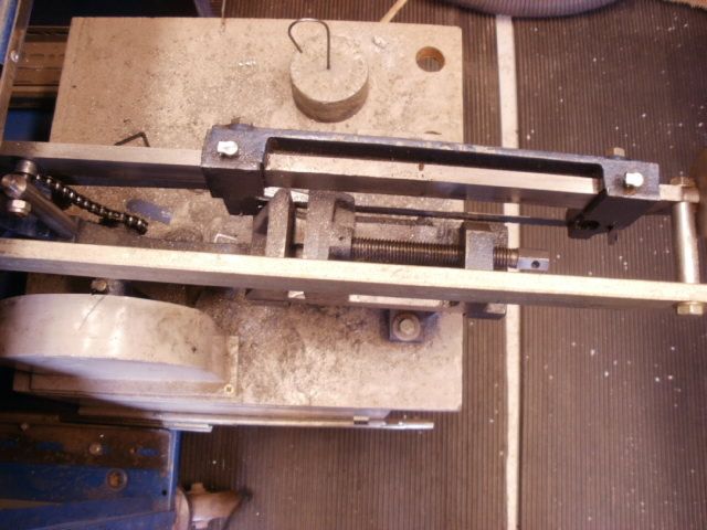

                                            p5041169.jpgp5041166.jpgp5041165.jpgGraham.

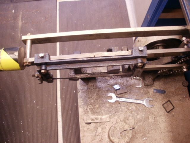

                                            I've had one of these hacksaw's for a number of years & it's served me very well ( I get no fun from using a hand hacksaw!!)
                                            A few improvements I made to mine are :-
                                            1. I fitted a second bar parallel to the existing slide bar which helped in stopping the blade running off.
                                            2. Fitted flip top oilers to the slide bar & shafts.
                                            3. Secured the vice feed screw in the moving jaw so the jaw moves in or out when the screw is turned
                                            4. Adding a weight to the handle improves the cutting.
                                            Mine is mounted on a box with the motor enclosed underneath for the only reason that the motor is rather large ( It's the only one I had at the time) I must keep a look out for a smaller one. The whole lot is mounted on a shelf fitted with runners so it can be slid into the cabinet when not in use.

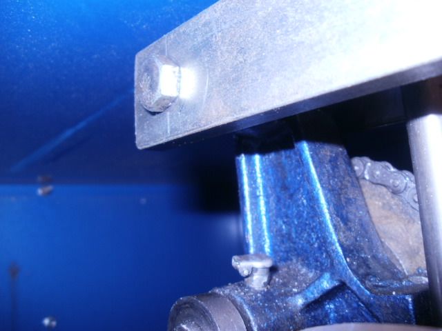

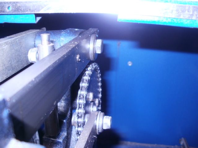

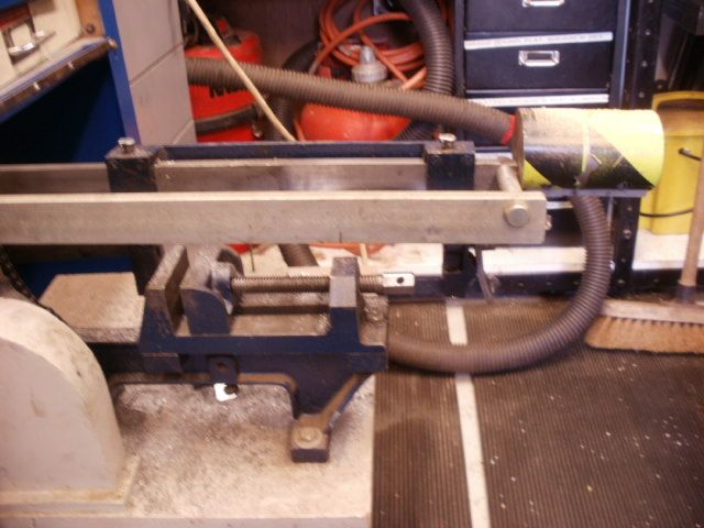

                                              Made quite a bit of progress and a picture as they say, paints a thousand words. I just painted the bits instead (RAL 9001 for those of you interested, one of my favourite shades of white):

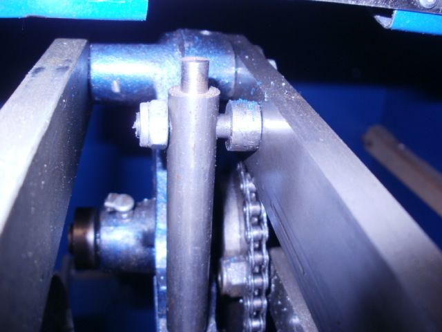

                                              I had looked at the arm and the cranks and though not overly used the wear marks were apparent in places. This signalled a rethink of the bearing surfaces and the crank action. This was the original crankpin:
                                              The hole in the crank arm has been over-bored already in the above picture and you can see the new configuration here:
                                              As shown in the pic of the main arm I have made some "Top Hat" bushes for this main arm and the smaller crankpin on the sprocket, I made two Top Hats and put them back to back on the sprocket crankpin and the bearing surface is now 10mm diameter as opposed to the original 3/8". I also made new brass bearing covers for the hacksaw frame itself.
                                              Not satisfied with that, I then bored the rear vice jaw, turned the thread back a bit on the bar and turned a groove in it, made a brass retaining plate and drilled and tapped it for the plate:
                                              Oh, and if anyone thinks I have been polishing the bits up you are right. It's a friction thing:

                                                    So, I knocked up a bit of a stand for the saw today, this will carry three tools and roll back under the bench (if I used the measuring stick correctly!).
                                                    On the top will be the saw with the shelf at the top level with the vice on the saw so a bit of support for material being cut and also something for a clamp to grip onto. Underneath the saw will b e another saw – the Fretsaw that I will soon have and alongside that but at the back will be the Belt Sander because I am getting fed up with moving it back and forth off the bench when I want to use it.

                                                      Now fitted with a parallel arm and all bearings remade with bit of Phos Bronze.
                                                      The vice sits exactly level with the steel shelf on the left so plenty of support for material as it is being cut.
                                                      The whole thing just slides away under the bench. Near Perfic! Just the stop to make and a bit of a weight for the arm. Thinking about fitting a spring to it to pull the arm down as opposed to just piling a load of lead on the front. No matter, It Lives!
