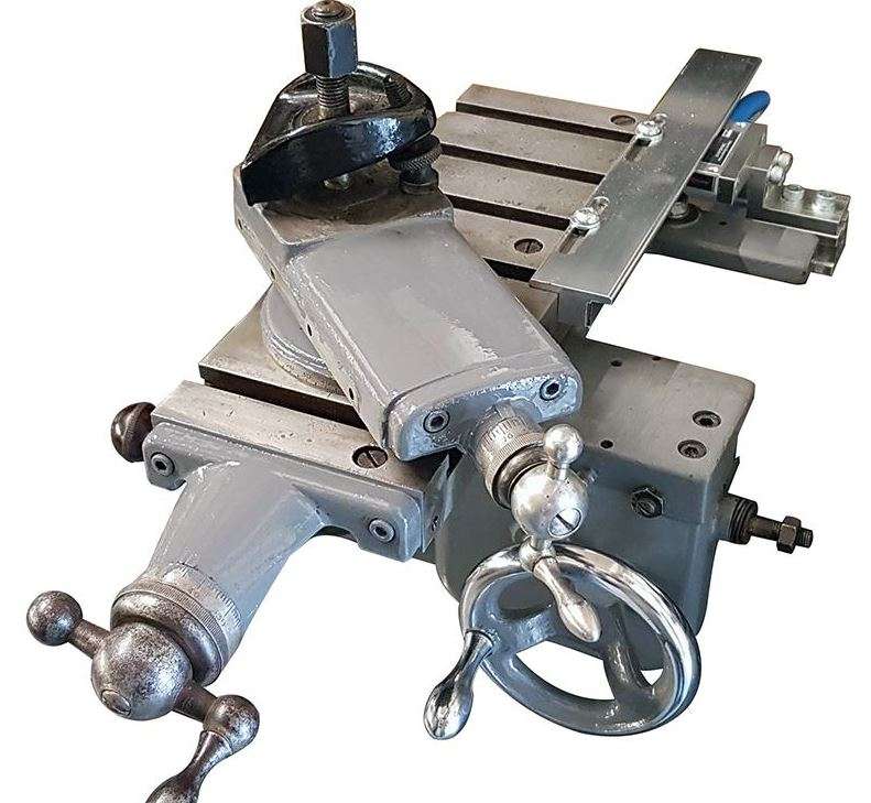

                        I assume you have raised similar points with them. As well as how bulky their bolt on kit for a Myford is?
                        bolt on
                        I’ll leave it to others to decide but comparing the two then Chris’s offering is a vast improvement on that and now that we have some figures likely to be at least twice as accurate as although sold as “high Accuracy” tape theirs is actually +/- 20 micron basic tape.
