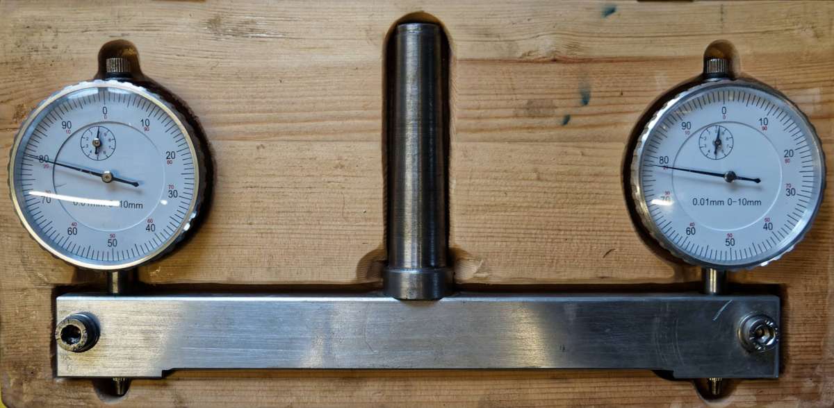

      Note that the final fitting of the clocks, has the tubular outer section all contained within the bottom alloy bar; it actually only goes about 2/3 of the way through.
      This means that one can stand it on a known flat surface, before fitting to the mill’s spindle, and zero the clocks exactly. Effectively it self-calibrates, without needing to go through the normal rigmarole of turning the clock’s supporting arm by 180° and constantly re-checking.

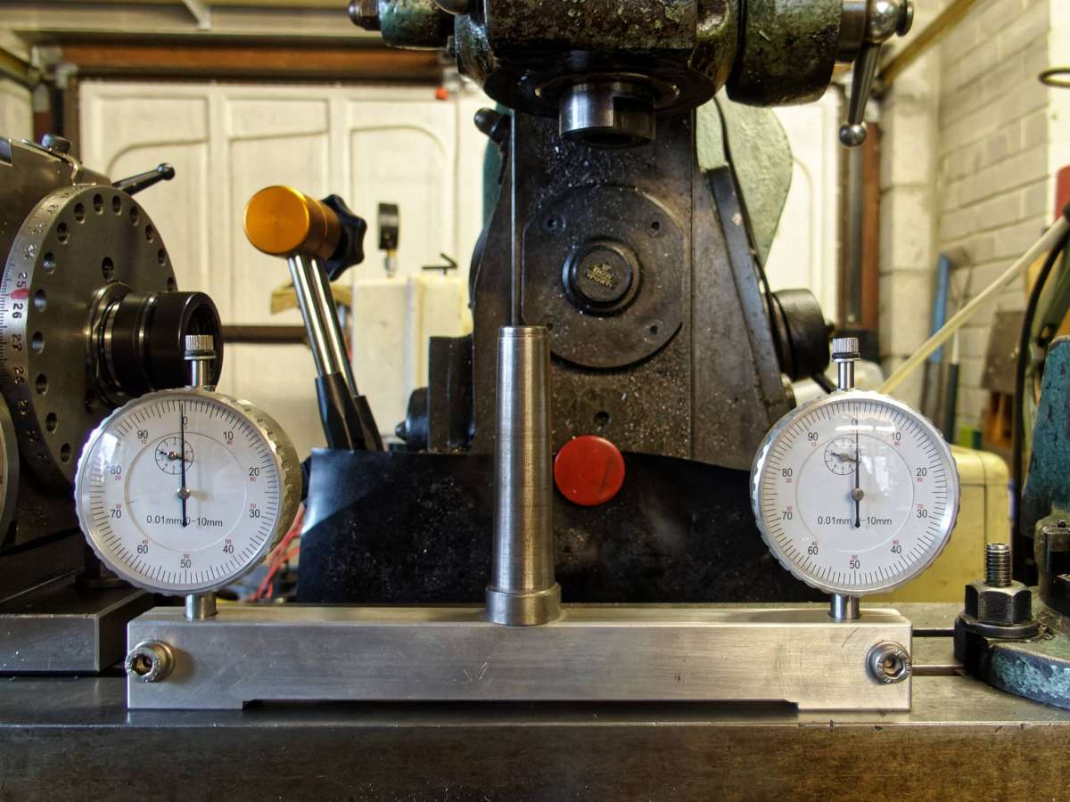

      To use, fit the tramming gauge to the mill spindle and raise the table (or lower the quill as appropriate) until the stylus on each clock touches the table.
      Tilt the head to correct any error, which shows as the clocks will display different readings.
      One can monitor for angular movement whilst nipping up the mill head fixings.
      Spindle Square in its box.
      1-Spindle Square Boxed
      Sitting on a flat surface for self calibration
      2-Spindle Square Calibrating

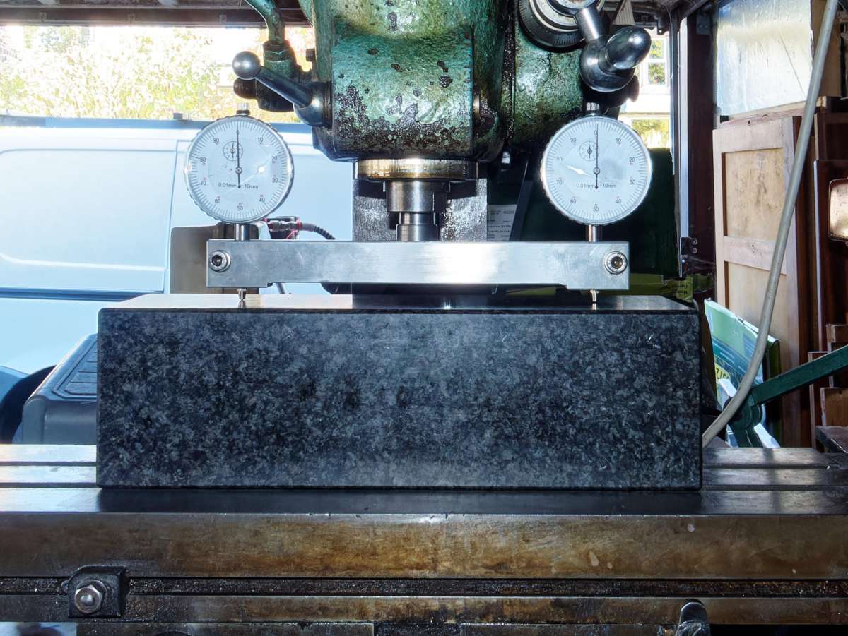

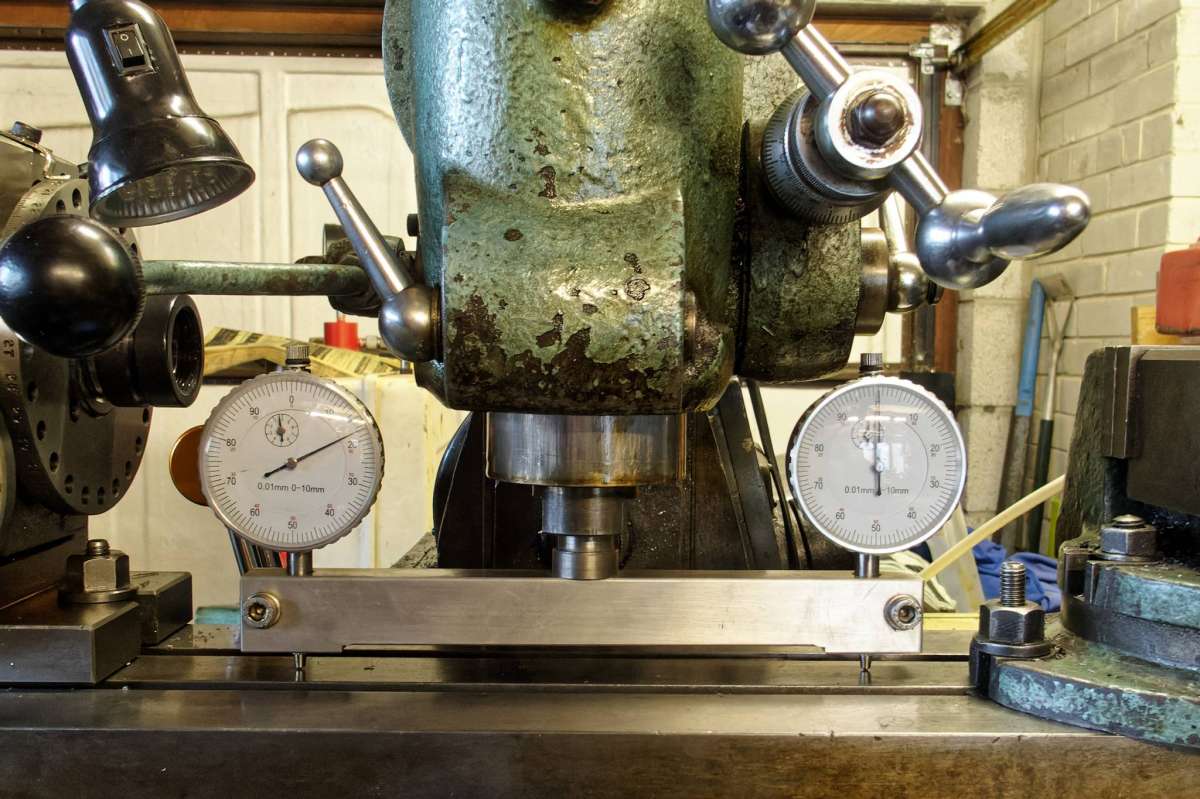

      Square in use before I found a long riser block for the Centec
      3-Spindle Off Square

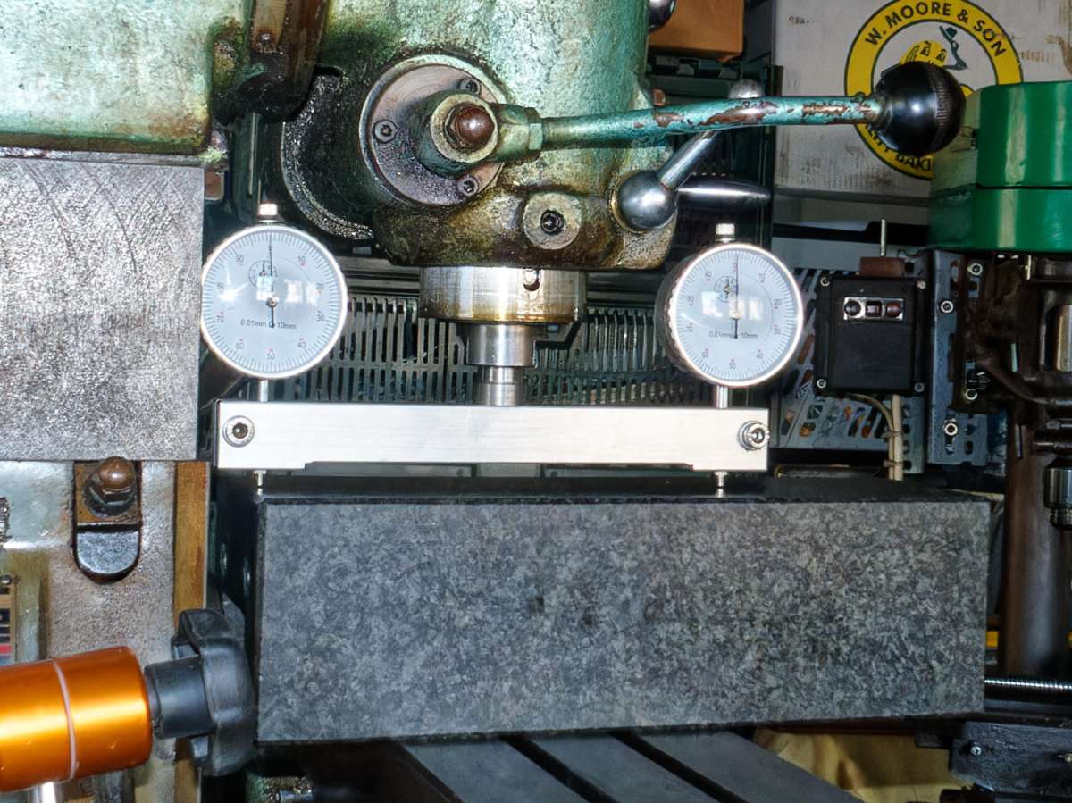

      Vertical Head now Trammed Left to Right
      4-Spindle squared

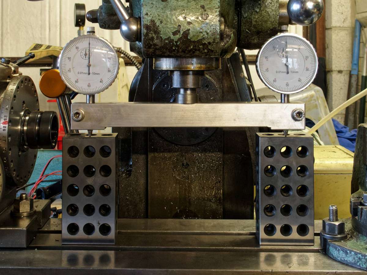

      It can also be used with blocks to save raising the table all the way up
      5-Spindle Square Blocked

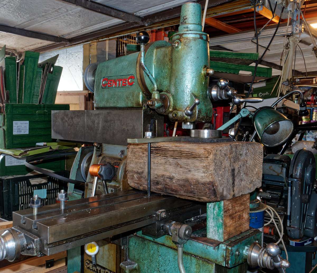

        To remove the vertical head without injury I jury rigged as below.
        Sorry these photos are poor, I was set up for the job, rather than photography
        Wooden block clamped down to the table for support, with table fully backwards
        S9270086_DxO-Facebook-s
        As you can see from the above, I used an old bearing outer to provide support for the nose, as well as a second block to support the sleeper end.

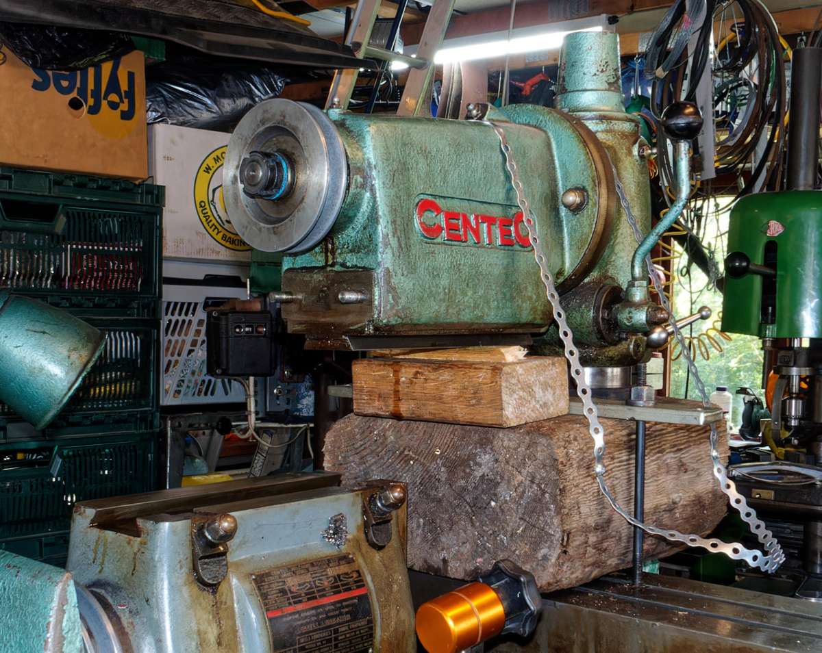

        Head now screwed down with some perforated galv strip, so I don’t lose it, and then the table raised and wound out.
        S9270088_DxO-Facebook-s

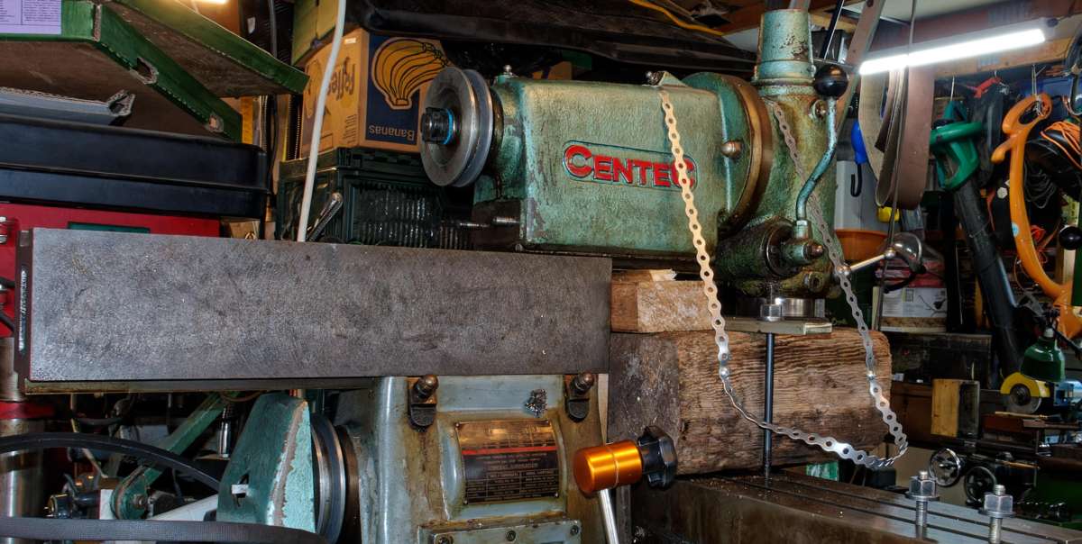

        The Riser can now be removed backwards and modified slightly; about 50 thou taken off the sharp edges, on top and one bottom, opposite the clamps.
        Riser block removed, and everything still quite stable and safe(ish).
        S9270089_DxO-Facebook-s

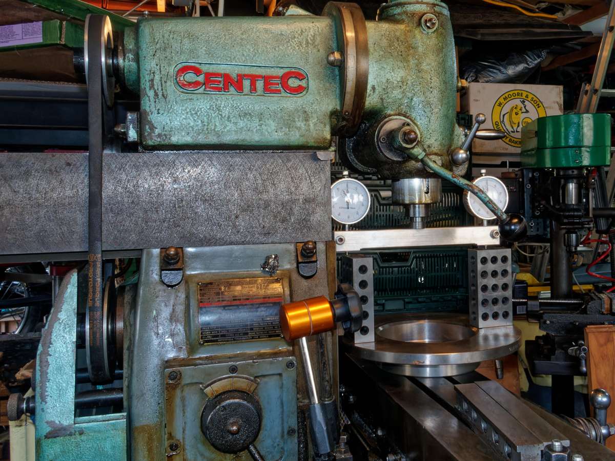

        Left Right could now be trammed fine, which is much as before, but I still had a slight nod forwards.
        Far too much to be acceptable at about 5 divisions on the metric clock.
        Setup for initial rough tramming with 2 thou shims, above left hand clock
        S9270090_DxO-Facebook-s
        Note that Now, I can recess the riser block slightly and spin the spindle gauge through 90°
        2 thou shims were just too thick, but after much experimentation, 3 layers of green cigarette papers proved to be about spot on.
        In theory, that comes out as 3 thou, but the paper distorted into the machining marks on the riser block and works nicely.
        It now trams quite well as regards front to back nod, with a more precision granite U block.

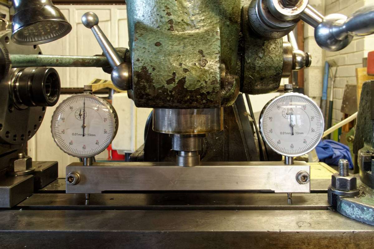

        S9270092_DxO-Facebook-s
        Left right can now be adjusted quite accurately, just by the conventional swivel locknuts
        S9270091_DxO-Facebook-s
        To mix my units a bit, over the 7¼” long bar between the clocks, I’ve gone from about 10 thou nod, to a bit less than 0.005mm, which will do OK for me
        Similarly left right tram is also close to spot on as well.
        I’d also made sure the table top was square to the column, just using an engineers 12″ square, to check as well as I was able.
