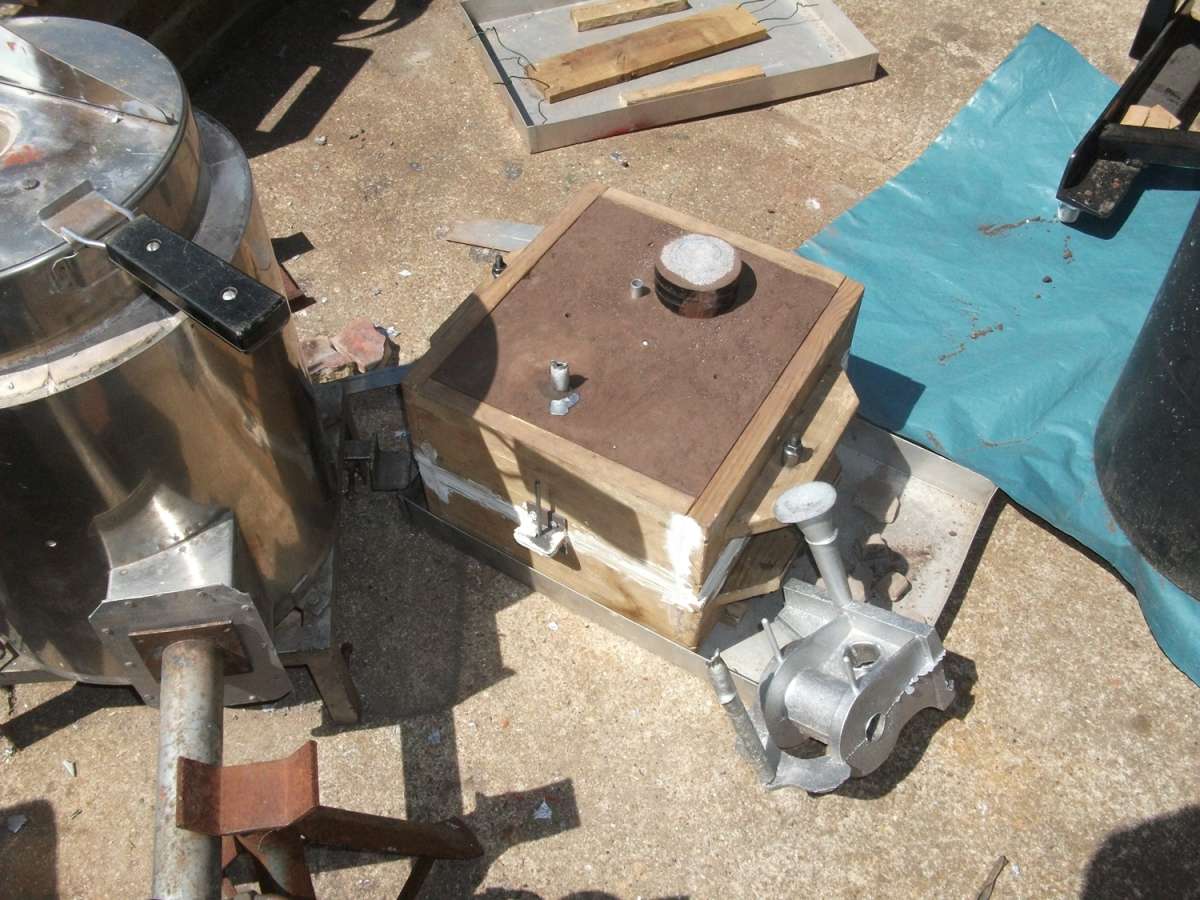

              You could try on here
              https://www.academia.edu/115318929/Building_A_Gas_Fired_Crucible_Furnace
              free download David Gingery crucible furnace.
              I made one of these a long time ago 1990 i think
              but used heat resistant bricks for the lining ,gas fired with propane  electric blower  .
              This is the only photo i could find holds maximum A8 crucible
              about 20 lbs cast iron /brass ,you need a fair bit of
              other stuff to go with it moulding flasks , sand , tooling
              protective clothing .
              https://www.artisanfoundry.co.uk for foundry supplies.
              You can use play pit sand for the molds and sodium silicate
              binder they sell it or you can make your own with gel
              cat litter and drain cleaner (sodium hydroxide).
