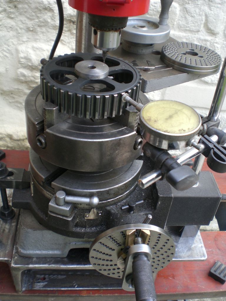

              Hi John, a lot of rotary tables can be used as a dividing head with an optional accessary kit.
              The picture below shows my 6″ Vertex with a four jaw chuck fixed to my cheap drill press on the hurry up, to drill five holes in an oil pump spocket mod, which failed on my car last year. There was not much room for error to achieve the strongest job, hench the choice for this application. I hasten to add this was just to get the engine going again to asses if there was any other failings in the engine.
