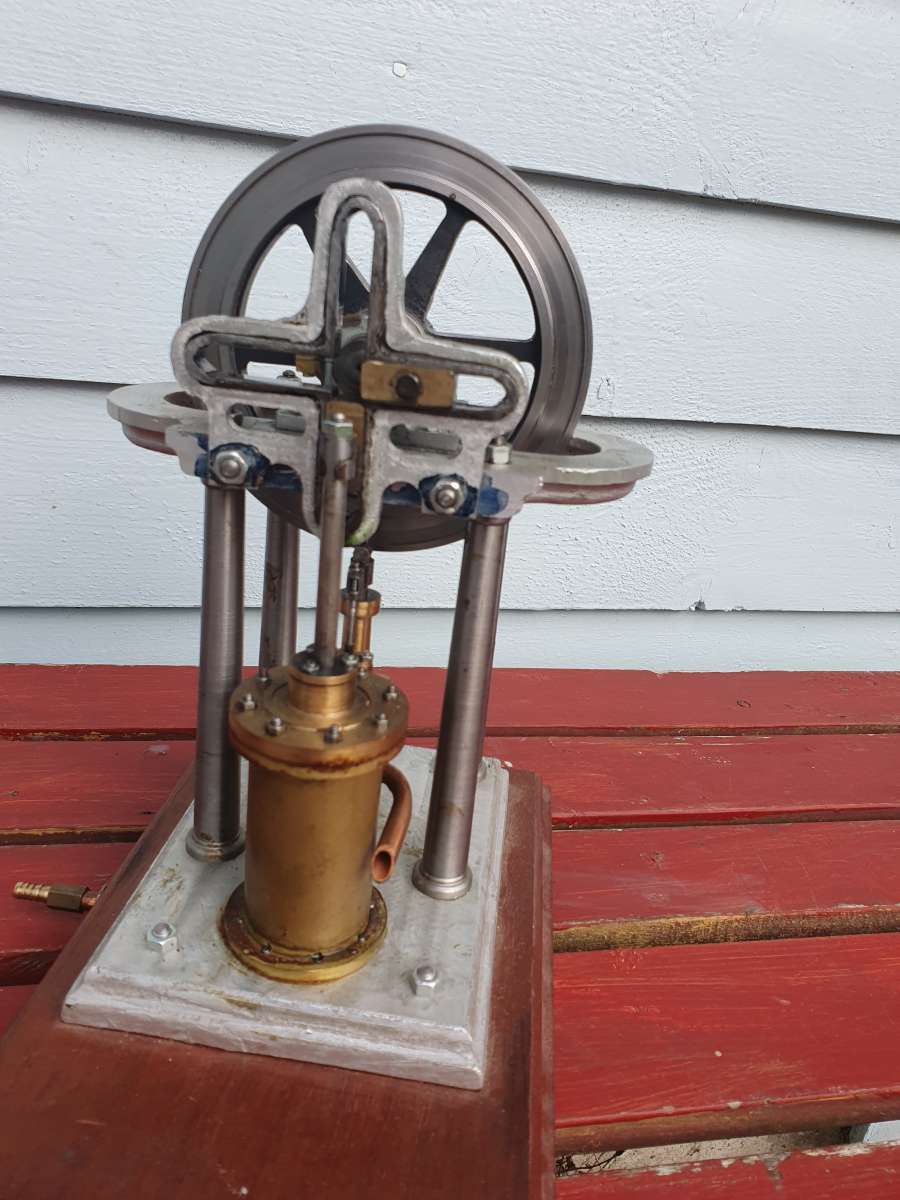

      Can some tell me the name of this engine and were to find the construction drawing?
      Thanks

        It looks like Anthony Mount’s Cross or Rectilinear Engine. The build was in Engineering in Miniature Vol 30 issues 9, 10, 11, and 12 March thru June 2009.  Castings available from Polly Engineering I believe. Check their web site under historic stationary engines.

            If it’s odd Anthony Mount is always a good place to start. He did do interesting engines.
            #814002
              Although Antony did a Crosss engine that one in the photo looks to be a more basic scratch built version that uses the same motion.

                      I agree with Jason. The cylinder and the columns are much plainer than Anthony’s. His columns were fluted and the cylinder had some reinforcing bands moulded around it.  It might be scratch built based on Anthony’s build series which actually ran from March to October 2009. Johannes I have sent you a PM.

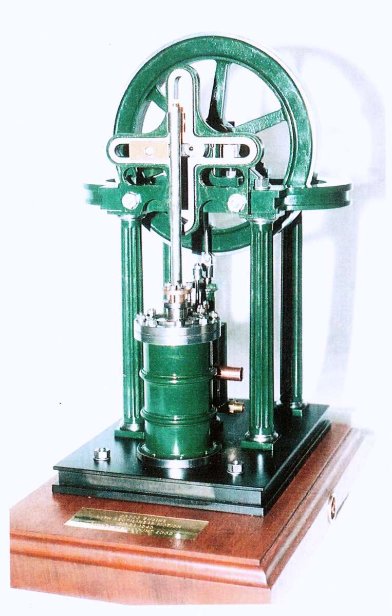

                        Here’s a picture of Anthony mount’s cross engine for comparison.
                        Cross

                          Sorry, it is a steam engine. (Dampmaskin in Norwegian).
                          I actually built the engine many yers ago. Cast the base, table and the cross in aluminium. The cross is strengthening with a steel lining.
                          It is a friend of of me that want to build the engine and I did not remember were I godt the drawings.
                          Thanks to you all is OK now. (BTW my friend is 93 years old,— and you learnd some Norwegian).
