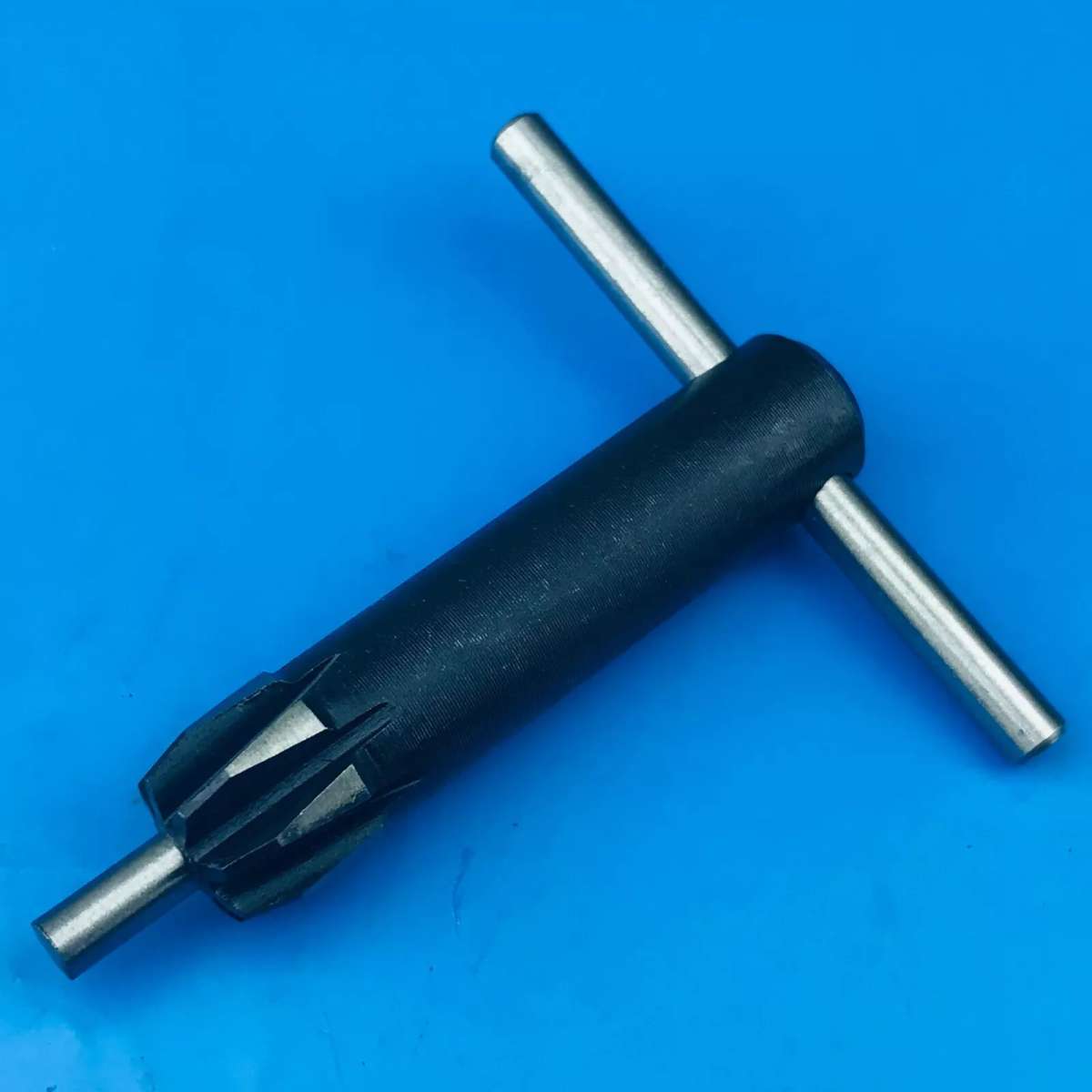

      I have Cowells 3 jaw chuck made by Bison which is missing the key. They are available new for about £60 however I would like to make one. I can ascertain most of the dimensions but can’t really work out how many teeth the key should have. Online photos (below) suggest six but my crude IMG_1153working out gives eight or nine. Does anybody have one and able to count the teeth for me? Many Thanks

        Mine has eight teeth.
        #839091
        Hollowpoint
          @hollowpoint
          Mine also has 8 teeth. If you need any other measurements I can get them for you. 🙂

            Great, thank you both, very much appreciated.

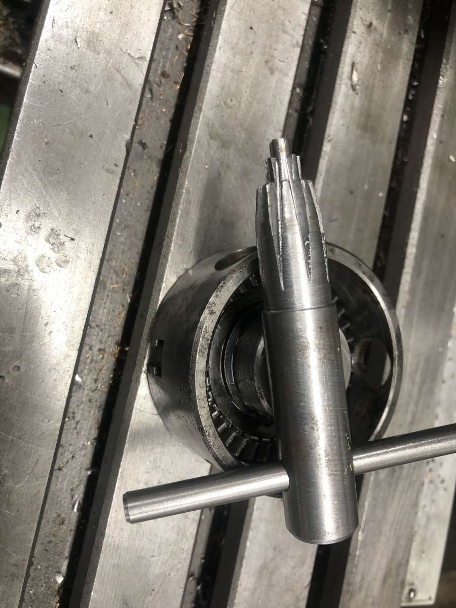

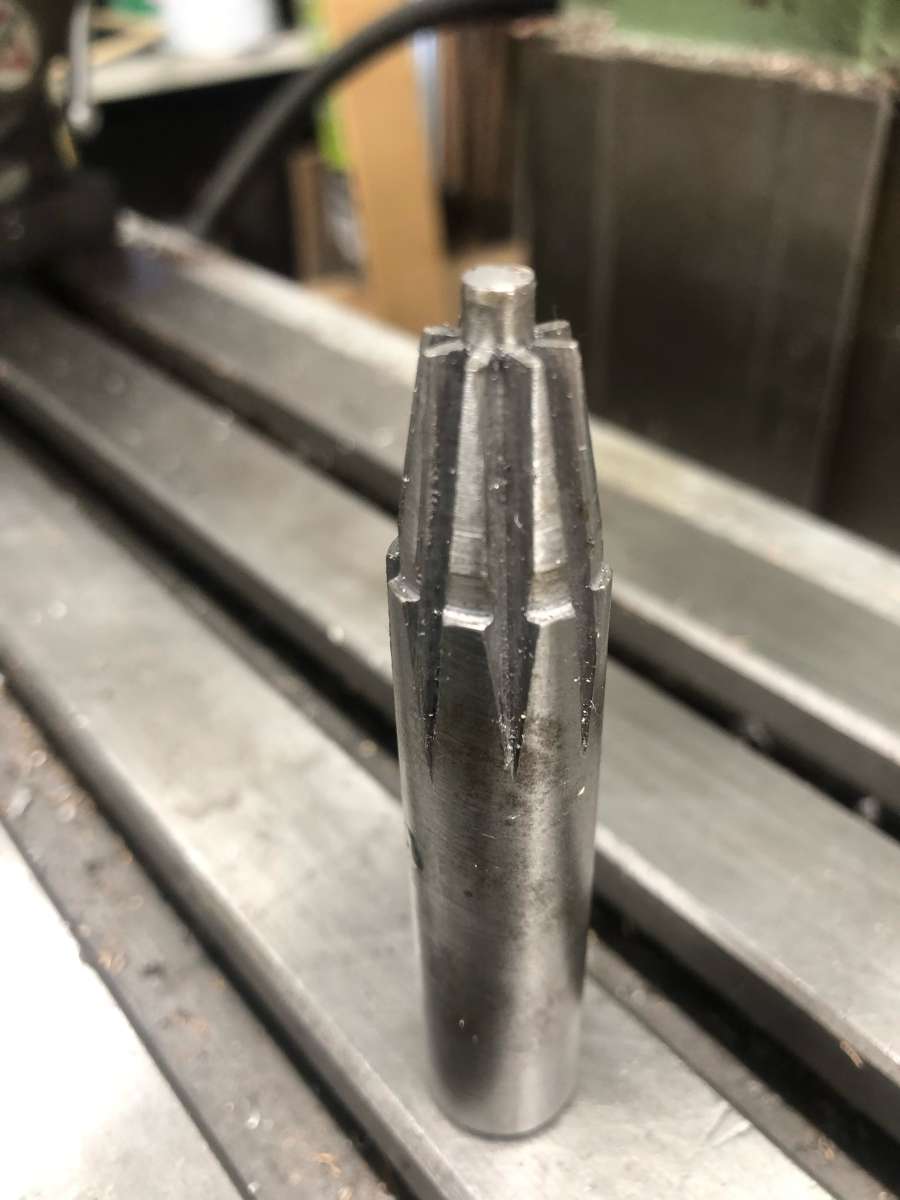

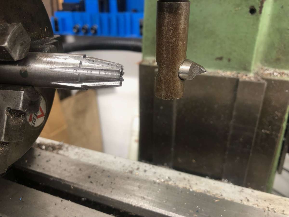

                      The fruits of an hours work earlier today. This was supposed to be a trial run but it works pretty well with no discernible slack in the chuck. The pinion was cut at an assumed 10degrees with a single point cutter found in a miscellaneous scrap tool box which looked about right. The centre pin was pressed in to the end of the key and trimmed back five thou or so at a time to ‘set the mesh’. At the end of the day it wouldn’t work on a big ten inch chuck but for a small 2 inch chuck it will be fine. IMG_3092IMG_3094IMG_3096
