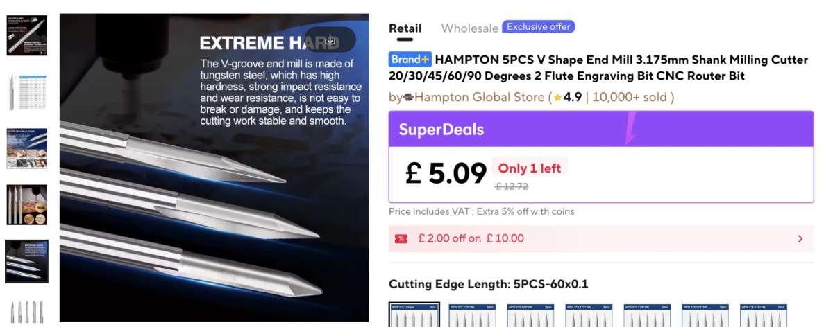

          Whilst I am pondering Pyramids, I do have the urge to buy these:
          IMG_1242
          If they can really grind that shape and finish on 3.175mm, at that price, I shall be impressed!

                IMG_1242
                They arrived today and, on quick visual inspection, I am impressed !

                  Just a shame they are too short for my old Gravograph, which seems to need a minimum of 90mm length cutters.
                  It’s an earlier version of one of these;
