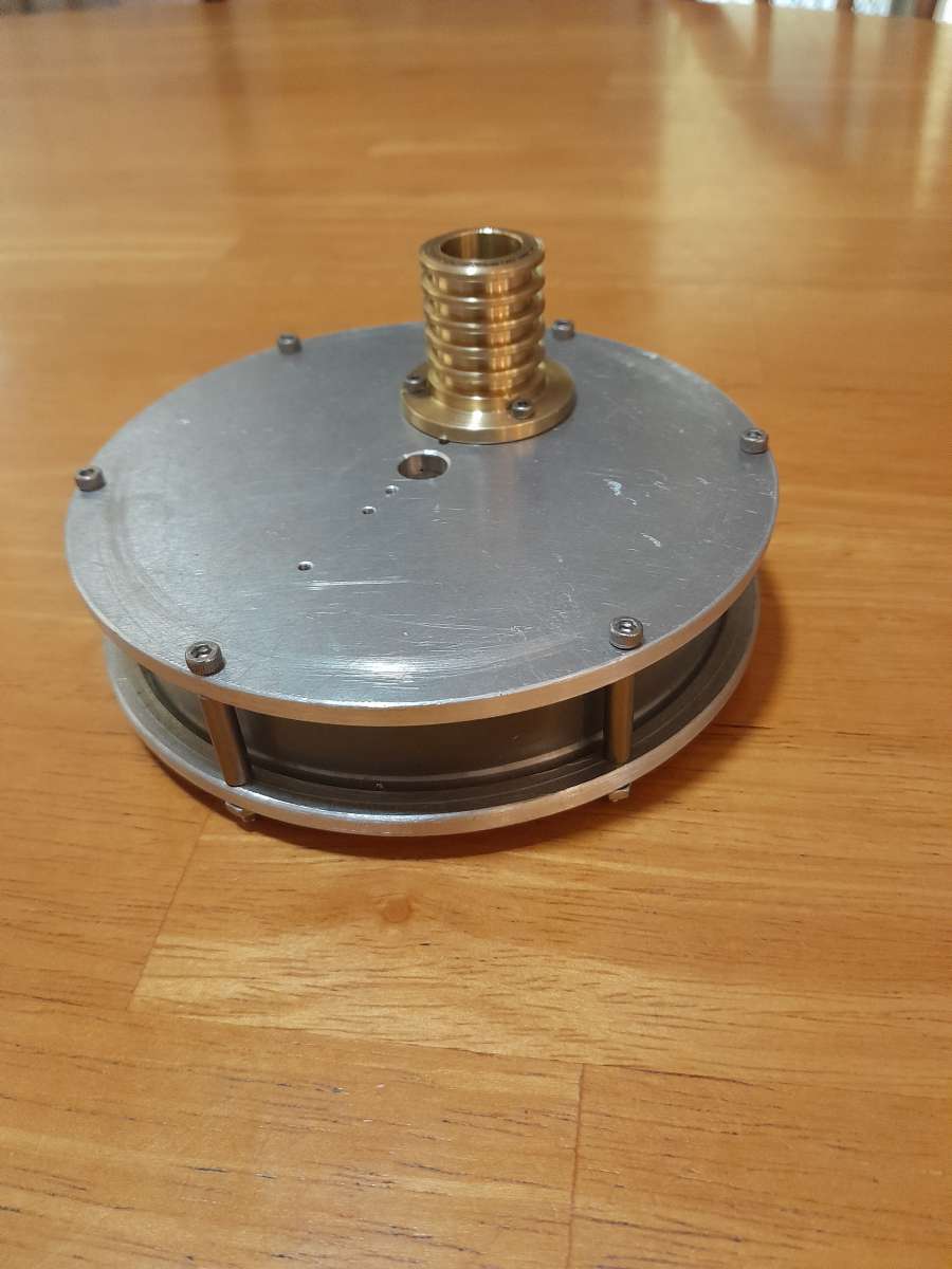

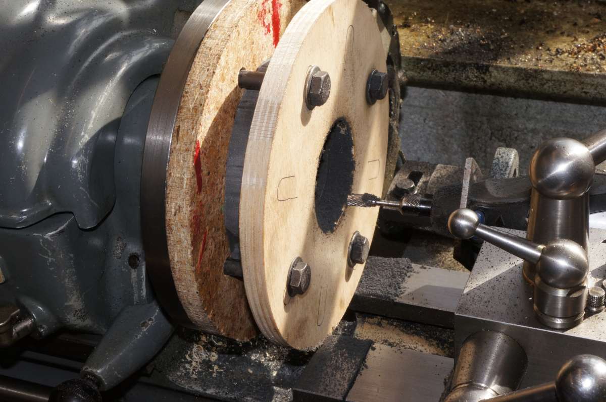

          I made a bracket to mount my Dremel on the lathe toolpost and used it to regrind a set of lathe chuck jaws. It worked very well.
          The Dremel bearings are supposedly rubber mounted but it seems to work OK as a mini toolpost grinder.
          I have also used that same rig to drill 2.5mm holes equidistant around the flange of the brass cylinder for a small stirling engine. Indexing was done using a 60 tooth change gear  on the banjo to get 3 holes spaced equally.
          Also the 6 holes around the periphery of the two large aluminium discs.

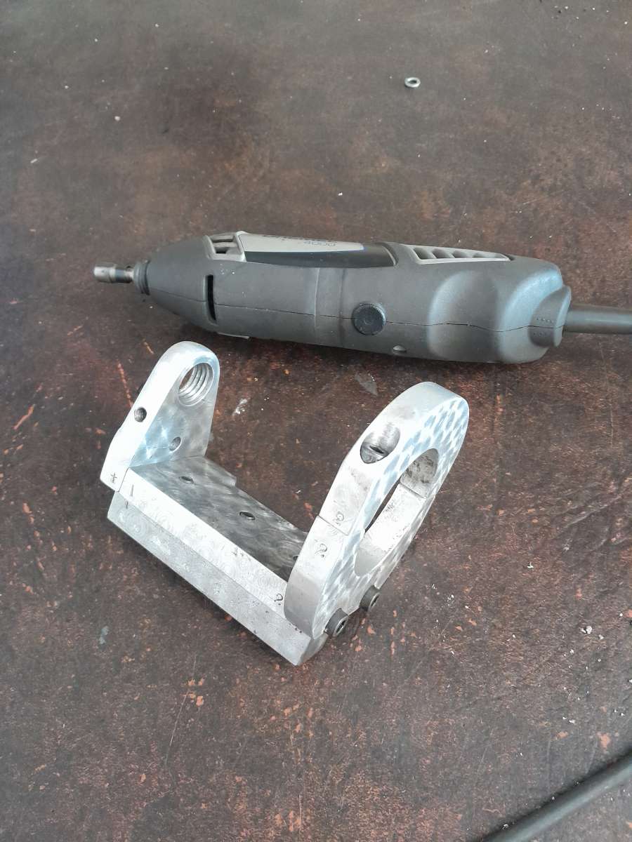

                      I used to have a Proxxon mini tool which had a turned parallel neck designed for clamping. it was an easy task to make a holder for the lathe. like Cedric I used it to grind the jaws on the 3 jaw without problem. When it gave up the ghost I got a good deal on a Dremmel. A nice ergonomic design, but I do miss the parallel neck of the Proxxon.

                        #826142

                          I don’t know about precision, but here the Dremel is fixed through a plate fixed to an angle plate fixed to the cross slide. Sizing the hole in one of a bunch of rubber rings.

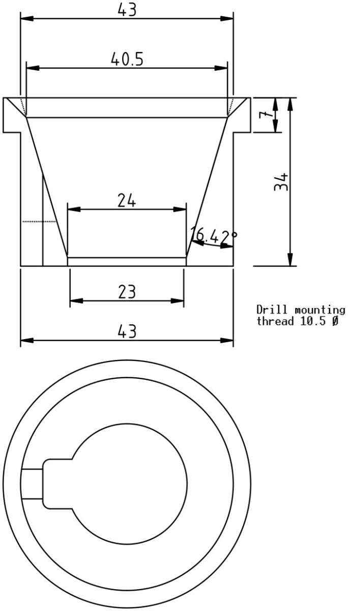

                              Macolm
                                @macolm

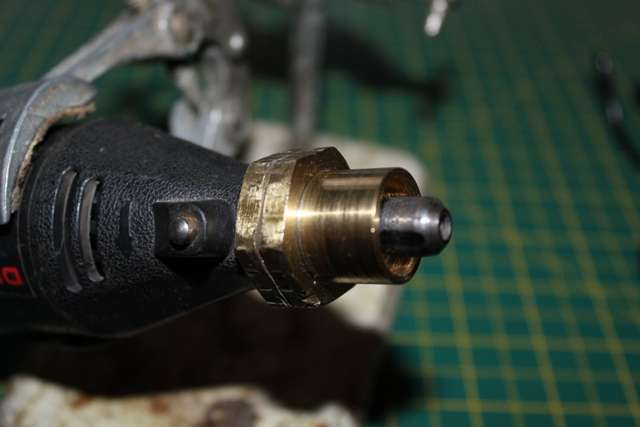

                                Perhaps this will help someone. I have a cheap conical front Dremel look (a bit) alike. To use it in a 43mm collar drill stand, I made this adapter. It also needs a suitable nut to be made up, and due to poor manufacture it was not possible to determine the thread diameter, only the rough TPI. I merely screwcut until I had a good fit, then finished the other dimensions. There is a clearance recess to allow the spindle lock to work. It has proved invaluable to allow Chinese carbide PCB drill bits to be used.

                                  My genuine Dremel was like that, from memory. The plastic thread was an oddball outside diameter so I screwcut the bracket to match dimensions.

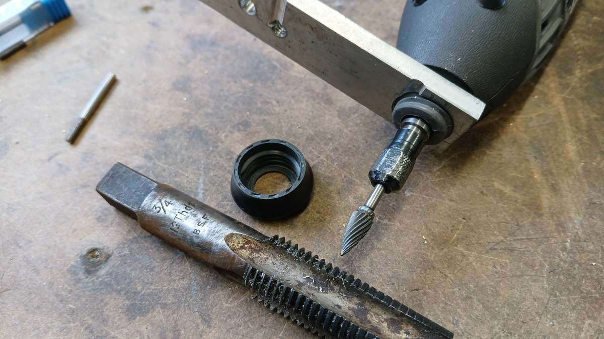

                                    I happened to have the BSF tap and it screwed in OK. Photos somewhere on the forum.

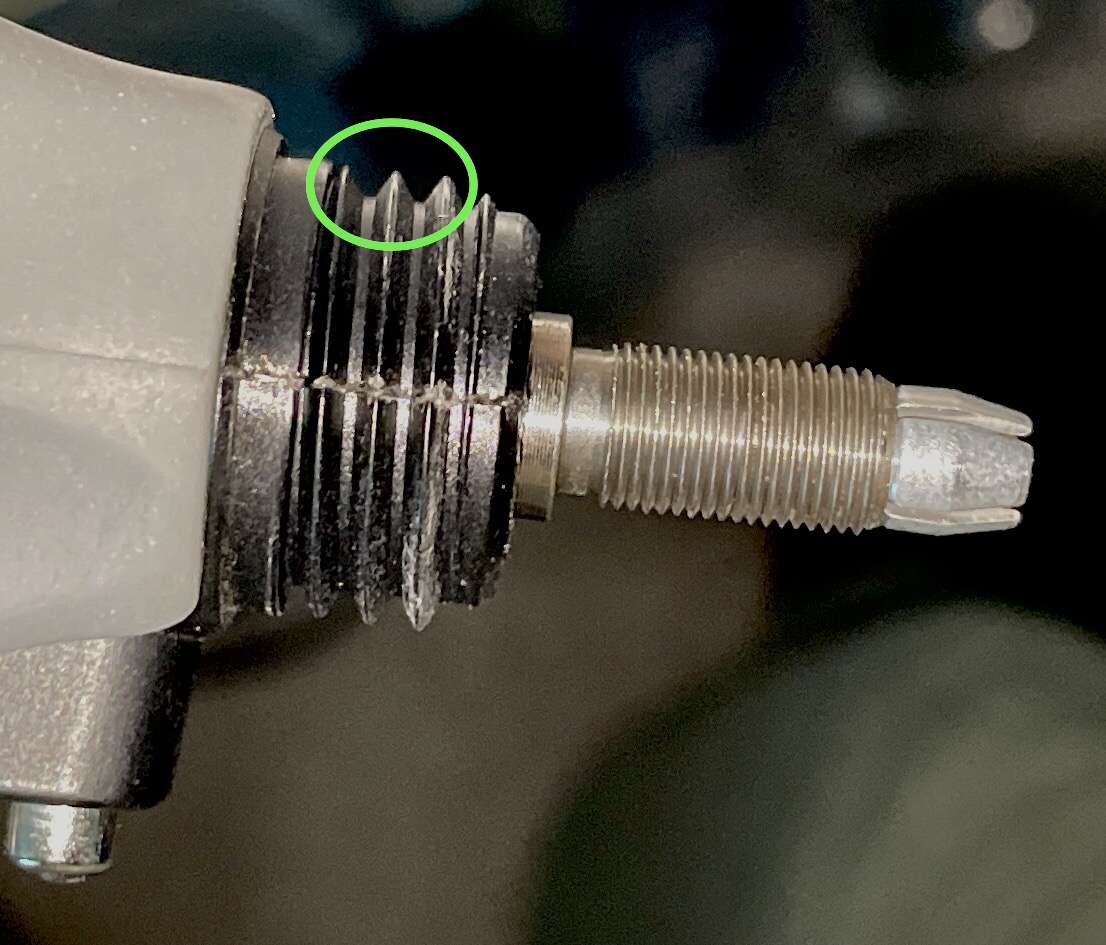

                                      #826245
                                        On Nicholas Farr Said:
                                        Hi, I’ve just had a look at my Dremel Mod. 395 Type 5, and the threads are definitely 60 degrees x 12 TPI.
                                        Regards Nick.

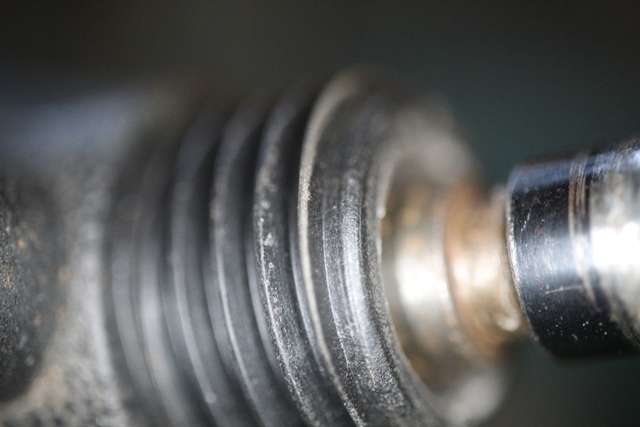

                                        Like Nick, I have a Dremel 395 [probably an earlier version]
                                        I can happily confirm 12tpi and 60° … but the actual thread-form remains in question.
                                        This is just from a snap-shot with the ‘phone but I will try to get something more useful in the coming days
                                        1764078479938

                                          BSF works for me
