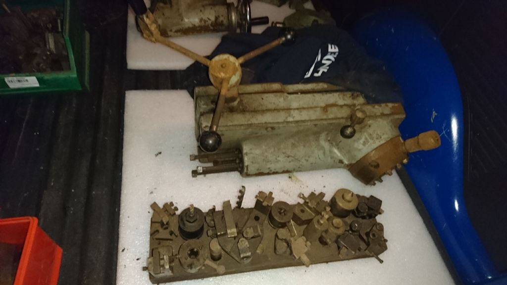

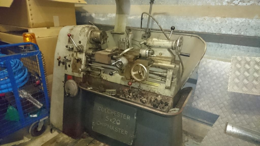

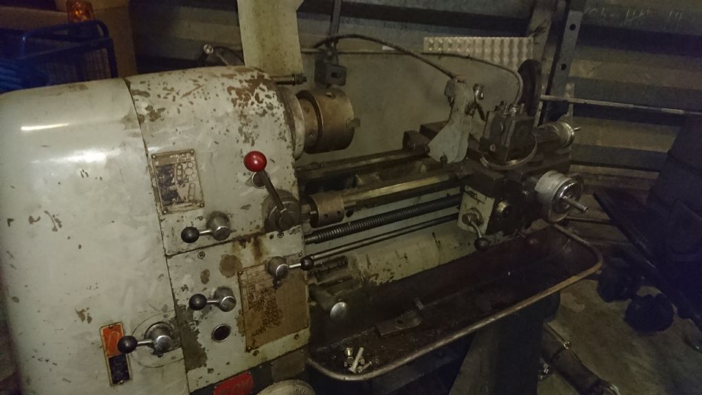

                  This is the lathe in the barn. It was covered in all kinds of grime but felt good on the slides. 3 phase but could not test it but it was a very good friend selling it at a good price so I took it.

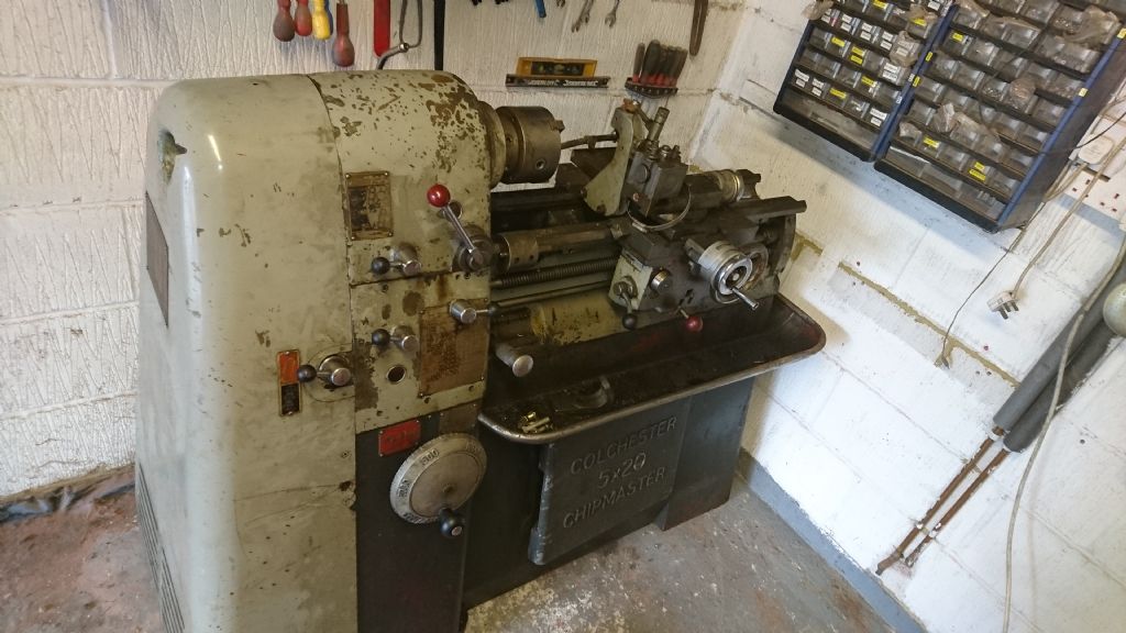

                  Adam
                    @adam
                    Also, all the serial numbers all matched and it came with a LOT of tooling (16 Dickson quick change holders) but only one 3 jaw chuck.dsc_3596.jpg

                    Adam
                      @adam
                      It also came with a capstan attatchment which is in full working order. Just a little……. dirtydsc_3600.jpg

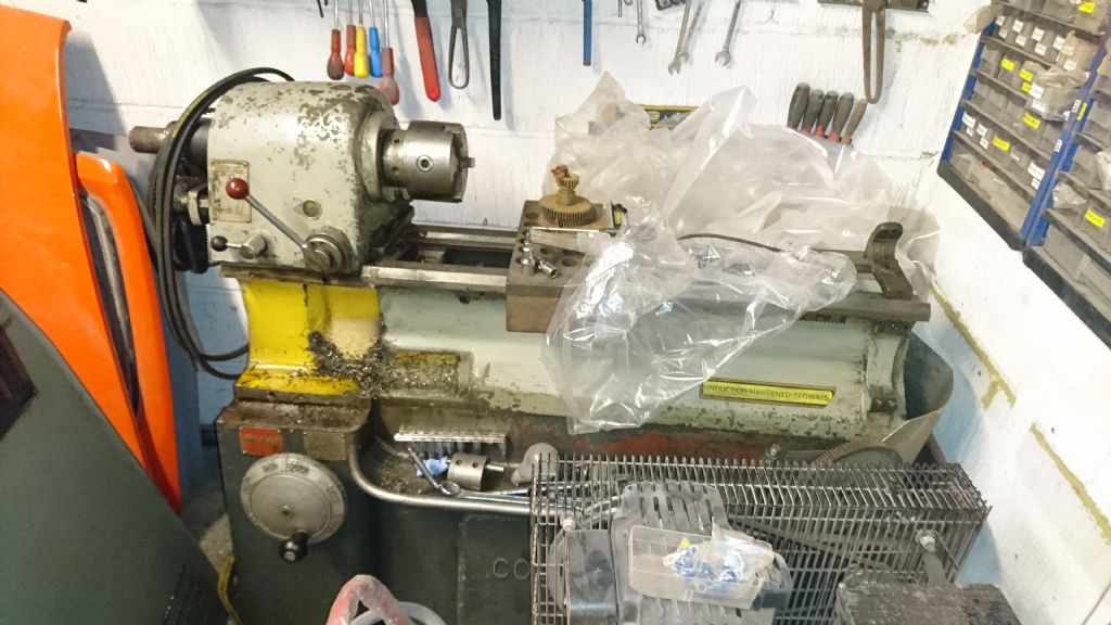

                      Adam
                        @adam
                        I get by with a little help from my friends……. The buddy I got it from included delivery too. And a couple more mates and we got it into my garage with a but machinery jimmy and some elbow grease. Now to disassemble. dsc_3620.jpg

                        Adam
                          @adam

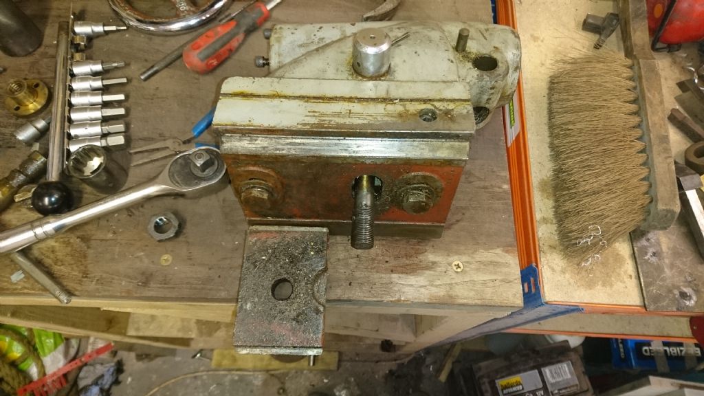

                          I still could not test it so I figured id just disassemble it and see whats what. Its bloody heavy, reassuringly so. Oh yeah it also came with a fixed, and travelling steady. dsc_3621.jpg
                          #370994
                          Adam
                            @adam

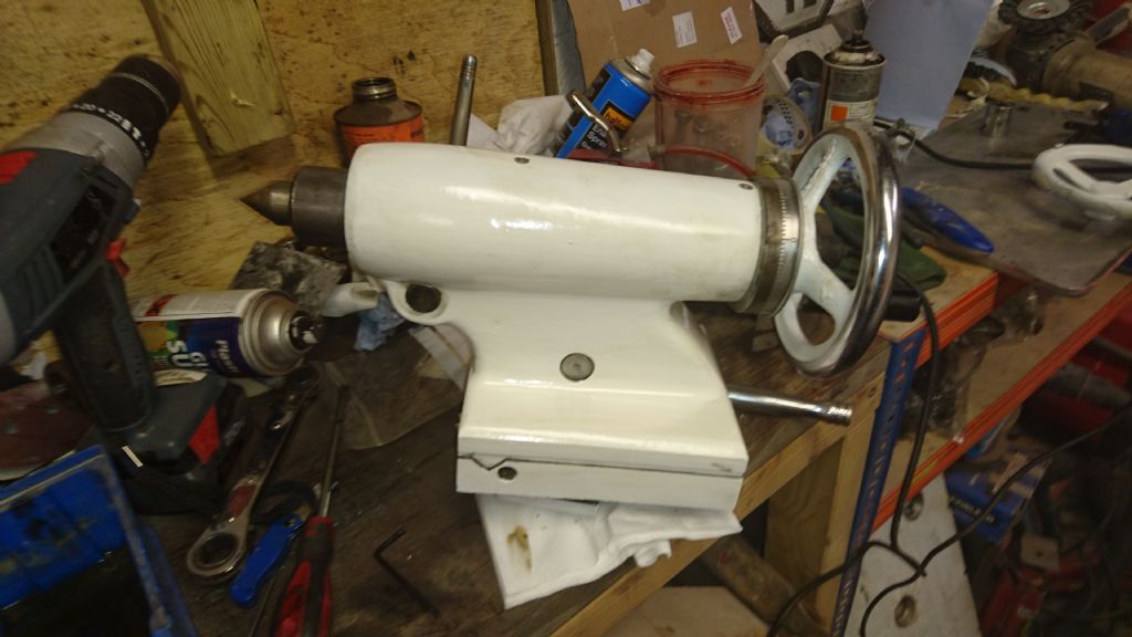

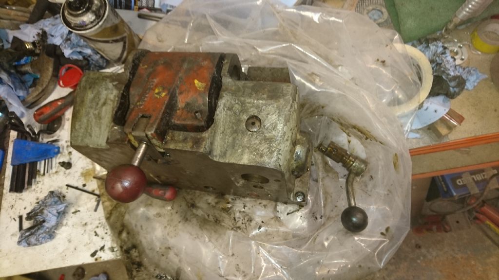

                            I Started by removing the larger components and started with the tailstock.dsc_3629.jpgdsc_3624.jpg

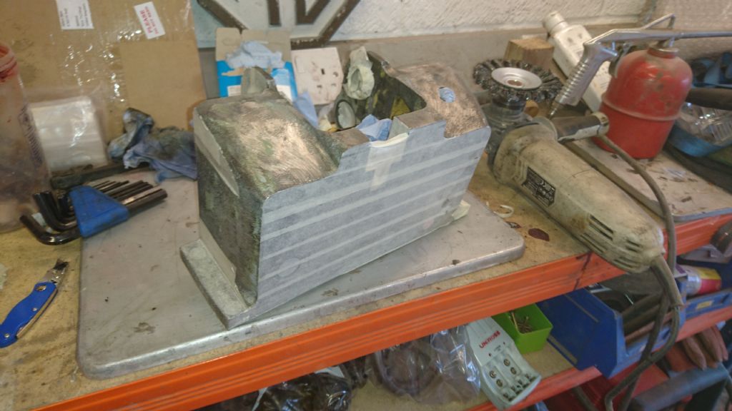

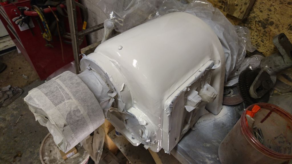

                            Adam

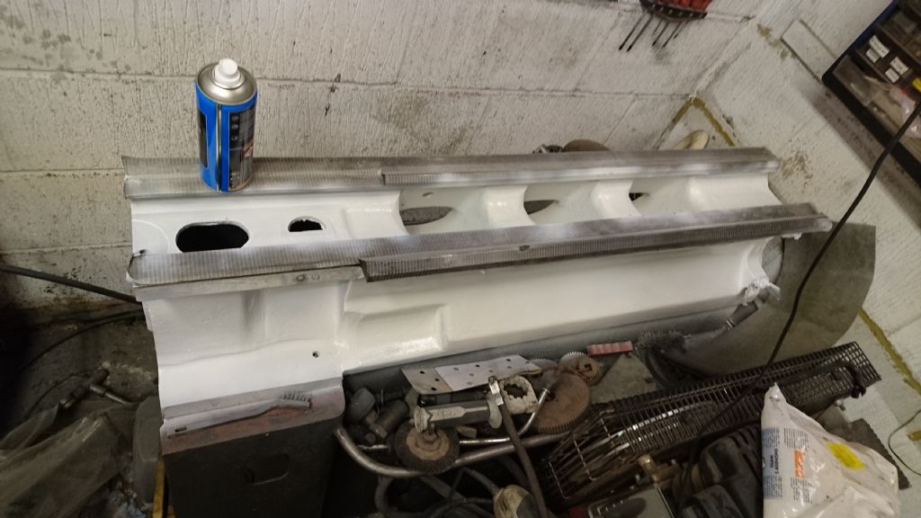

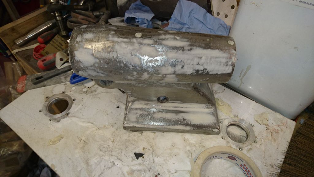

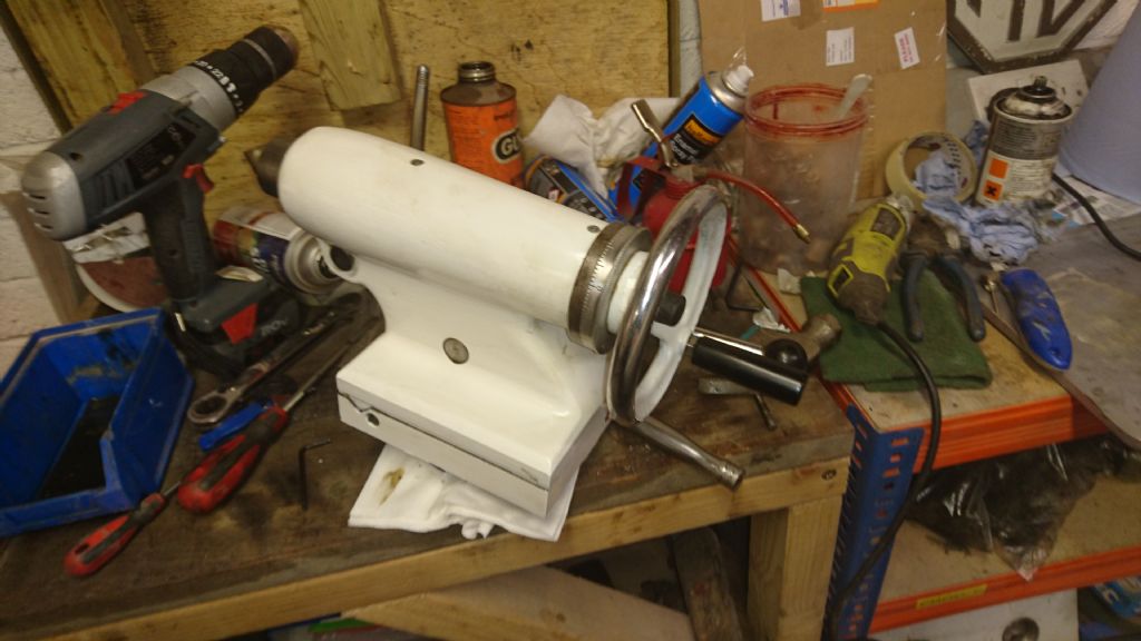

                              @adam

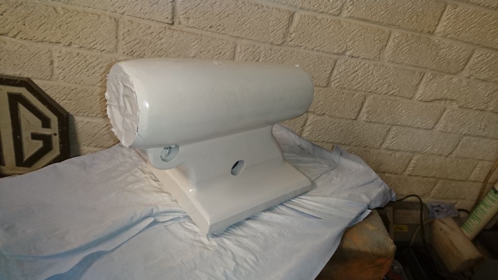

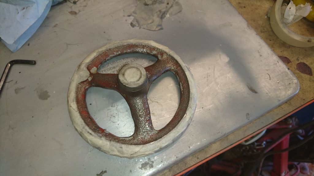

                              I removed all the old paint with a wire wheel on angle grinder then used some filler to fill the larger imperfections. Then (after careful masking) painted white enamel. The handwheel and other components were cleaned on a brass wire wheel in the bench grinder.dsc_3630.jpgdsc_3631.jpgdsc_3643.jpg

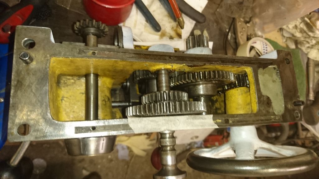

                                Adam
                                  @adam

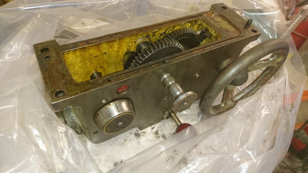

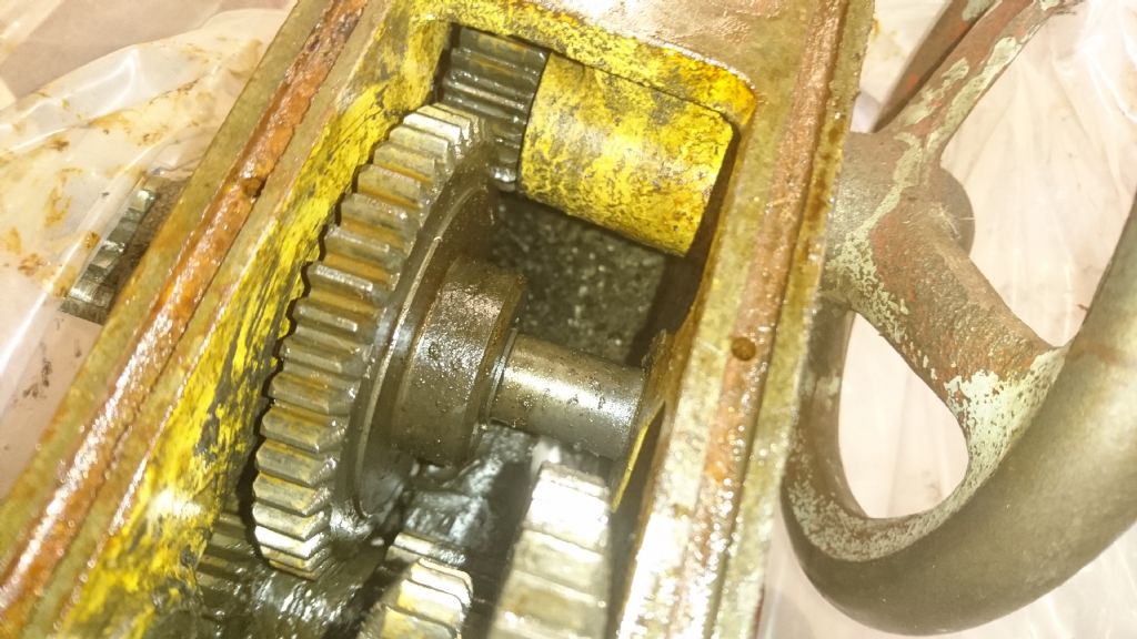

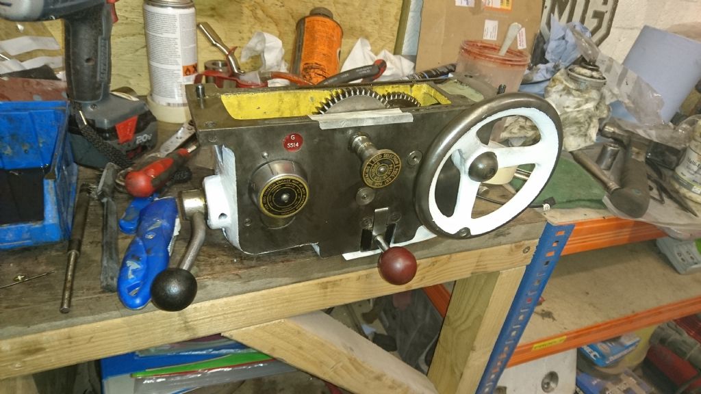

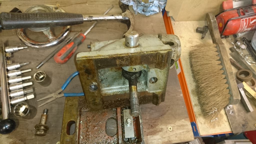

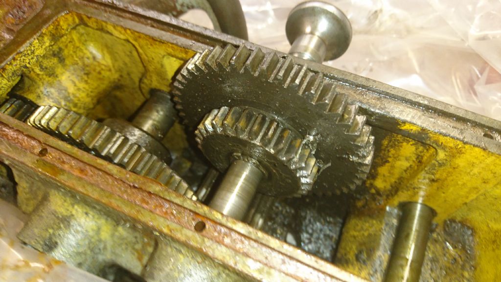

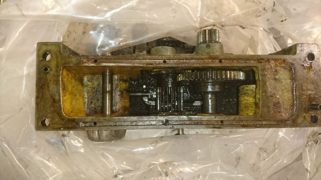

                                  Next came the carriage gearbox (cant remember the proper name). It was stripped to every last component and cleaned in a large ultrasonic bath.
                                  #370999
                                  Adam
                                    @adam

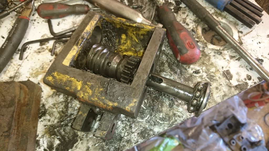

                                    The part where you engage the power feed was a BA***RD to remove. Thanks to someone on here I got some advice. There is a hidden plug that needs to be removed.
                                    #371000
                                    Adam
                                      @adam
                                      Once out I found (much like all the components) it was covered in grease, oil and swarf. This was also thoroughly cleaned in the ultrasonic bath.
                                      #371001
                                      Adam
                                        @adam
                                        All painted and reassembled and greased up. Nothing was repaired or replaced. It all felt tight and no real wear.

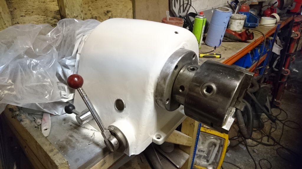

                                            Adam
                                              @adam

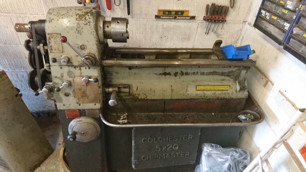

                                              Next was the headstock. Again this felt good and the clutch seemed to work so I did not want to disturb. A lot of maskig and a lick of paint was all that was needed. oh and its seriously heavy!!!

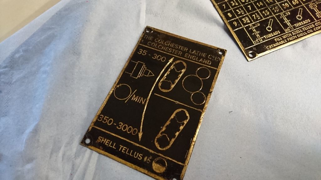

                                                Next came the nameplates. I removed the scum and paint, then polished the brass before painting. Then used a blunt scraper to remove paint from the raised surfaces.Not perfect but a lot better than before.dsc_3717.jpgdsc_3719.jpgdsc_3720.jpg

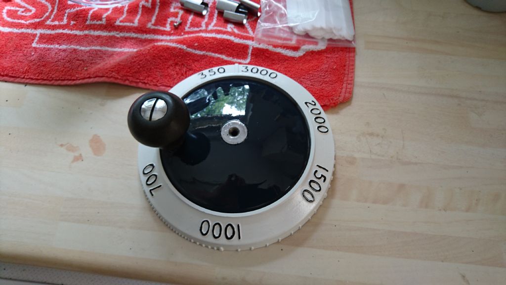

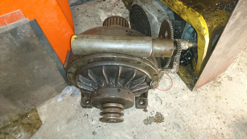

                                                  Then came the variator. Possibly the heaviest component. It was greasy but looked good. I gave it a clean and topped up the oil to the specified level and using the correct Shell oil.dsc_3721.jpg

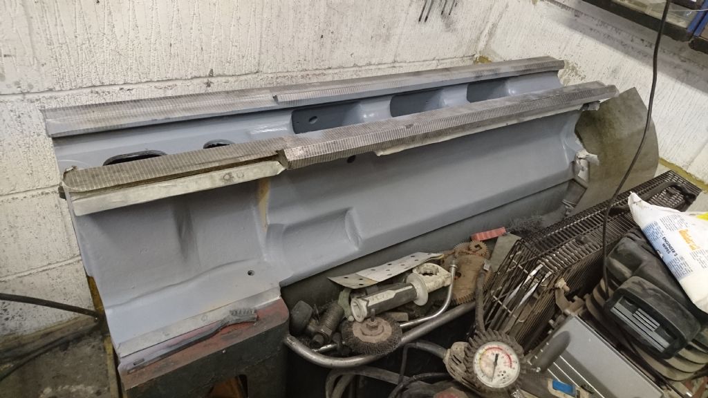

                                                    Then I began on the ways. This was heavy of course but I managed in its set location. dsc_3730.jpgdsc_3733.jpg

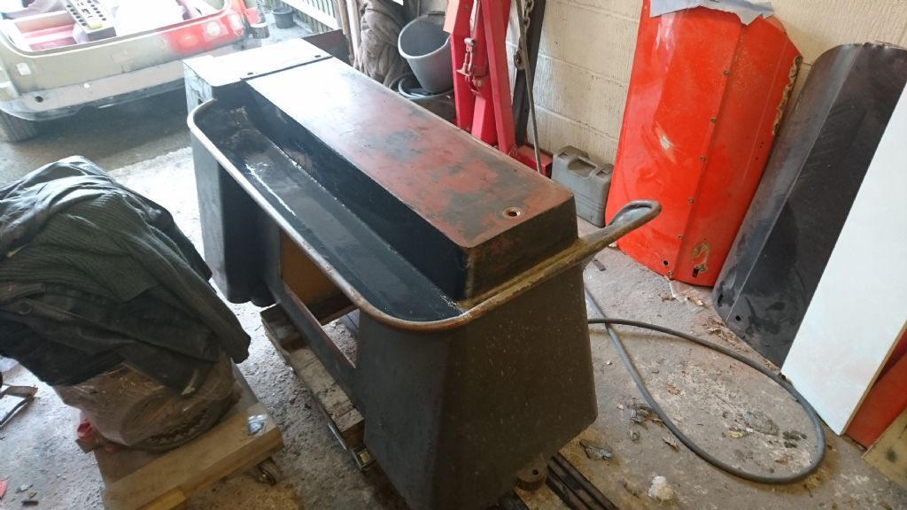

                                                      @adam

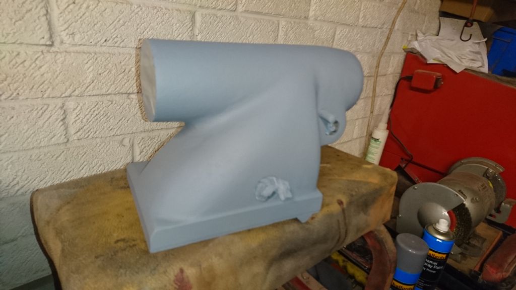

                                                      I then worked on some odds and sods and began work on the stand. A heavy thing and strong.dsc_3736.jpgdsc_3750.jpg
