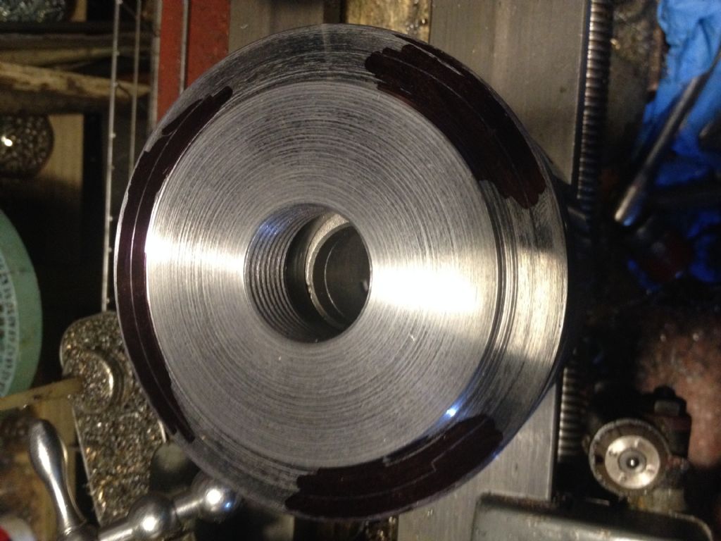

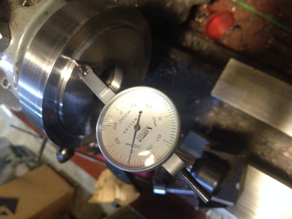

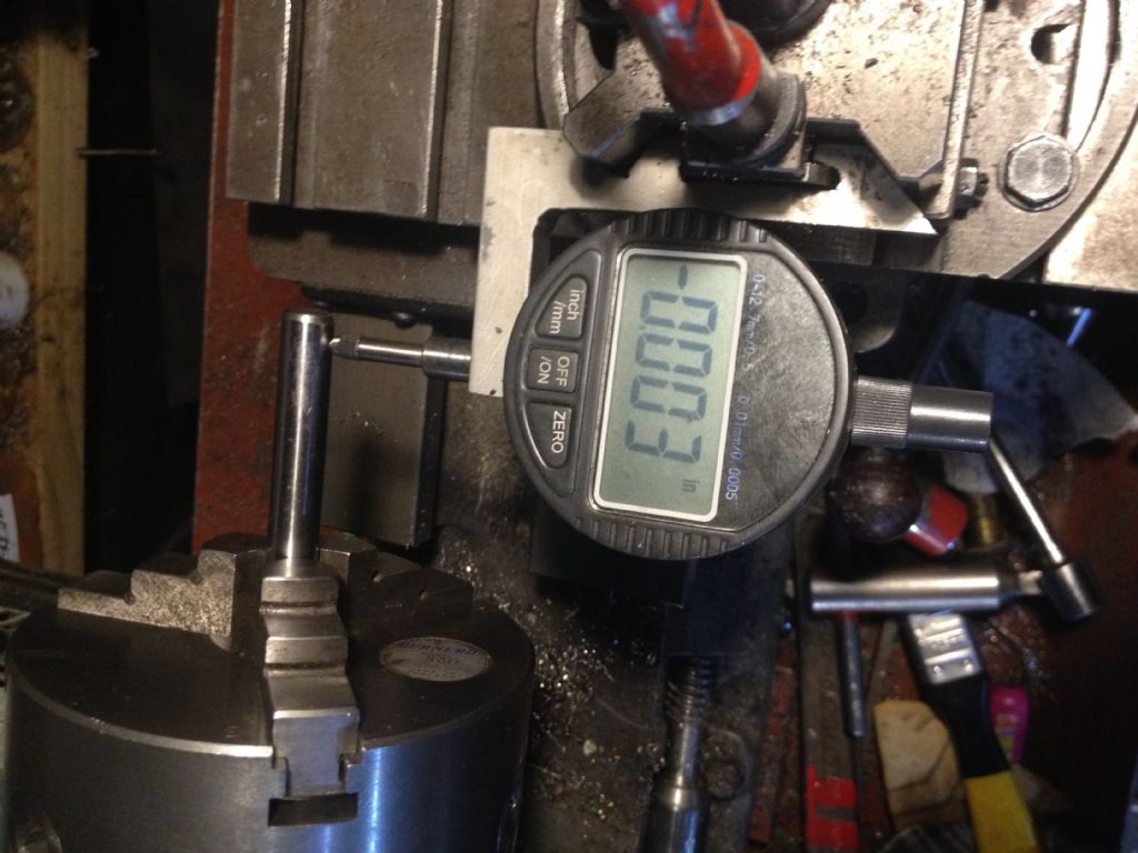

      Well I made a new back plate. Took an awfully long time as I hadn’t planned the operation as well as I should and had lots of set backs. Did it in the 4 jaw, made the register hole first, then cut the thread (leaving it in the chuck the whole time. Took the chuck off so I could test fit on register about 50 times as I was paranoid about making it too loose.
      Result has exceeded all my expectations (which were pretty low). I was a bit worried about getting the holes in the back plate to line up with the chuck, but realised the holes in the original back plate were drilled over size to allow a little movement.
      I've run a dti around the new back plate and get no no real movement which is good.
      I've fitted it to the chuck, and although it's better than it was, it's still not great…

        3 thou is pretty fair for a used 3-jaw.
        #422974
        not done it yet
          @notdoneityet
          As Pete, 3 thous is adequate for most work – all turning when you don’t need to remove, and then replace, the job in the chuck.
