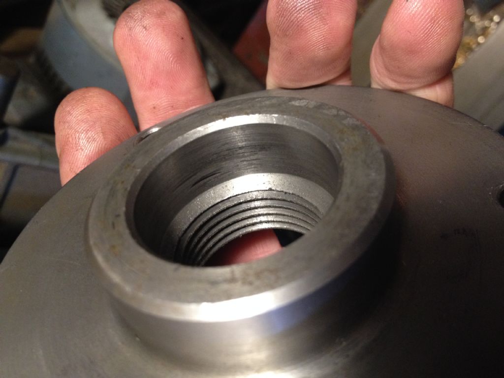

                            I've pulled the back plate off the chuck. It doesn’t want to thread on to the head stock either front or rear first.
                            I was sure it was dirty threads in back plate as the 4 jaw goes on fine, but have tried screwing my face plate on and that is also tight.
                            Weekend was busy so didn’t get much time in the workshop, but have set up the change wheels to 12 tpi and will run an internal thread tool through (turning by hand) this evening. I've tried cleaning thread using a thread gauge, but that didn’t seem to make much difference. I can’t see any obvious swarf in the tread, but there is one point where thread may be a little damaged.
                            the thread on the head stock looks perfect, but as the face plate & 3 jaw are both tight maybe I being deceived.

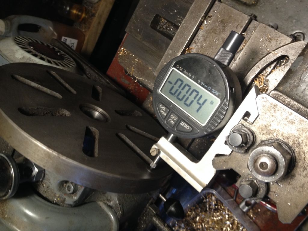

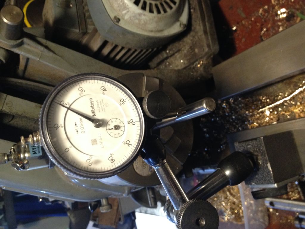

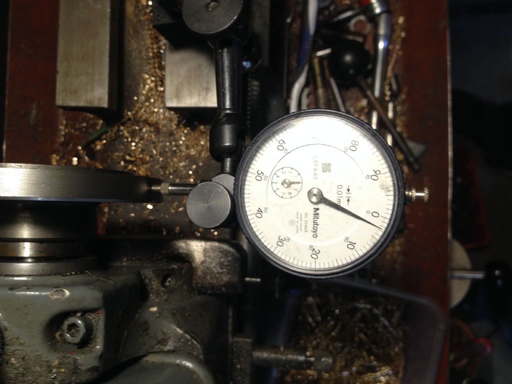

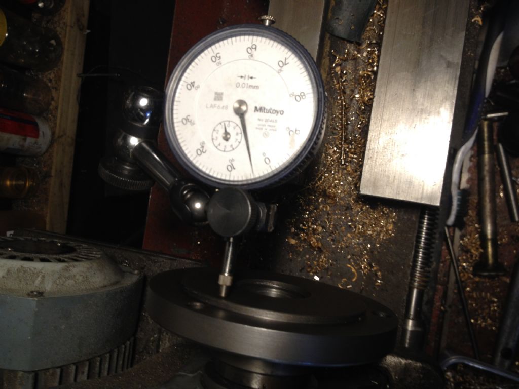

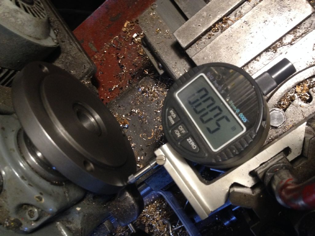

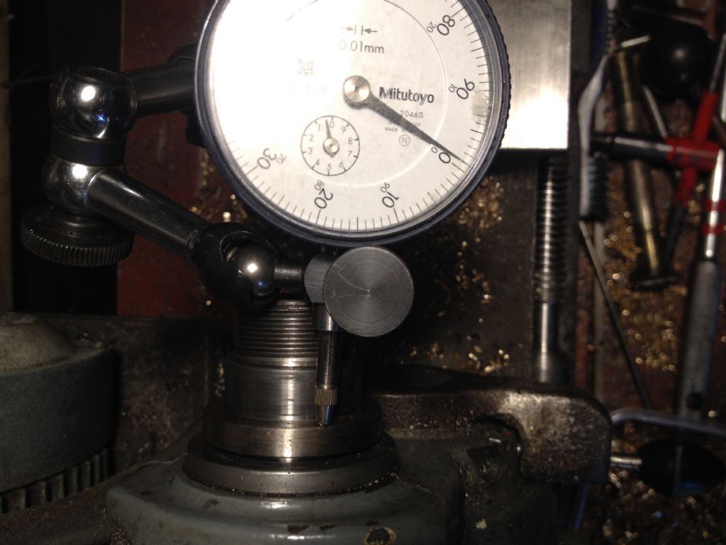

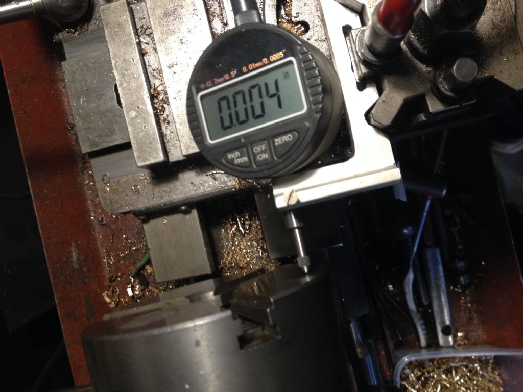

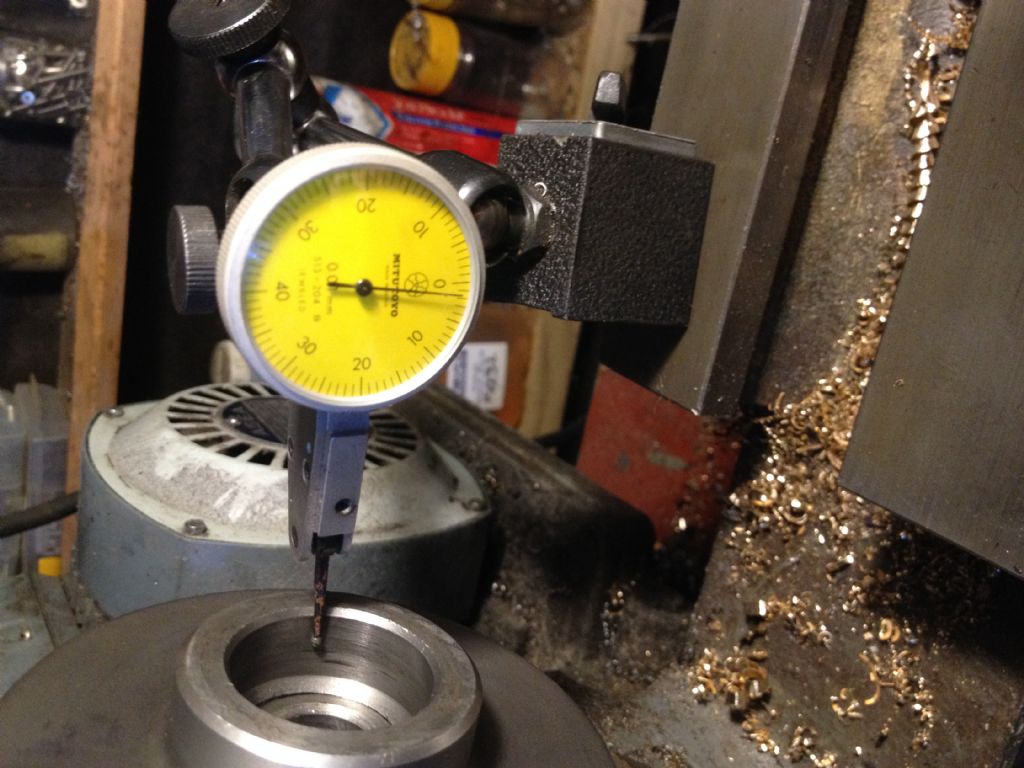

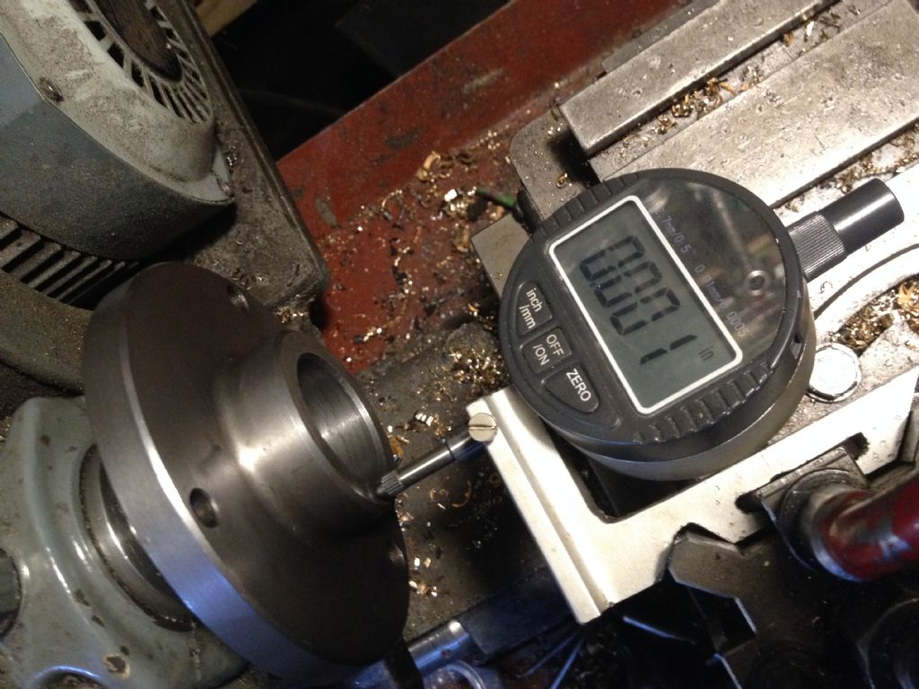

                                I found some time today so had a go at sorting the issues.
                                I was thinking it was the thread on the face plate since the 4 jaw goes on fine, but based on what Mick B1 has said that may not be the case.
                                i gave the head stock & backing plate threads a good clean, and the 3 jaw & face plate both fit better, although tighter than I recall.
                                I used an indicator on the edge & face of the face plate….
                                photos show maximum variation. Edge is true, face is a bit out
                                Indicator on head stock is OK
                                Indicator on backing plate is not so good
                                Indicator on 3 jaw with a 10mm dowel is way out

                                    Grotto, two points in the photo Indicator on the headstock – pic 1 you are checking the OD of the spindle nose and not the register — register is the plain part immediately behind the thread. It probably will give the same reading but the part you have the indicator on will make no difference to the chuck mounting.
                                    Indicator on the back plate – again where you have the clock bearing will not affect the chuck mount, you need to check the outer edge where the mount holes are, again if turned together as one would expect both areas should give the same reading- but ?? The same goes for checking the OD of the back plate the actual register is the narrower part that goes into the chuck body that really matters.
                                    As a matter of interest was the back plate machined on your lathe ? Normal practice would be to machine the backplate on the machine it will be used on thus ensuring true centralisation.
                                    You have not said if prior to this whether your chuck did run true? Or has it always had significant runout? Makes a difference to the solution.
                                    In any event you need to get the tightness of the fit resolved first then if the backplate and or chuck still has significant run out it may be worth considering re-machining the backplate register providing there is enough material to allow this.

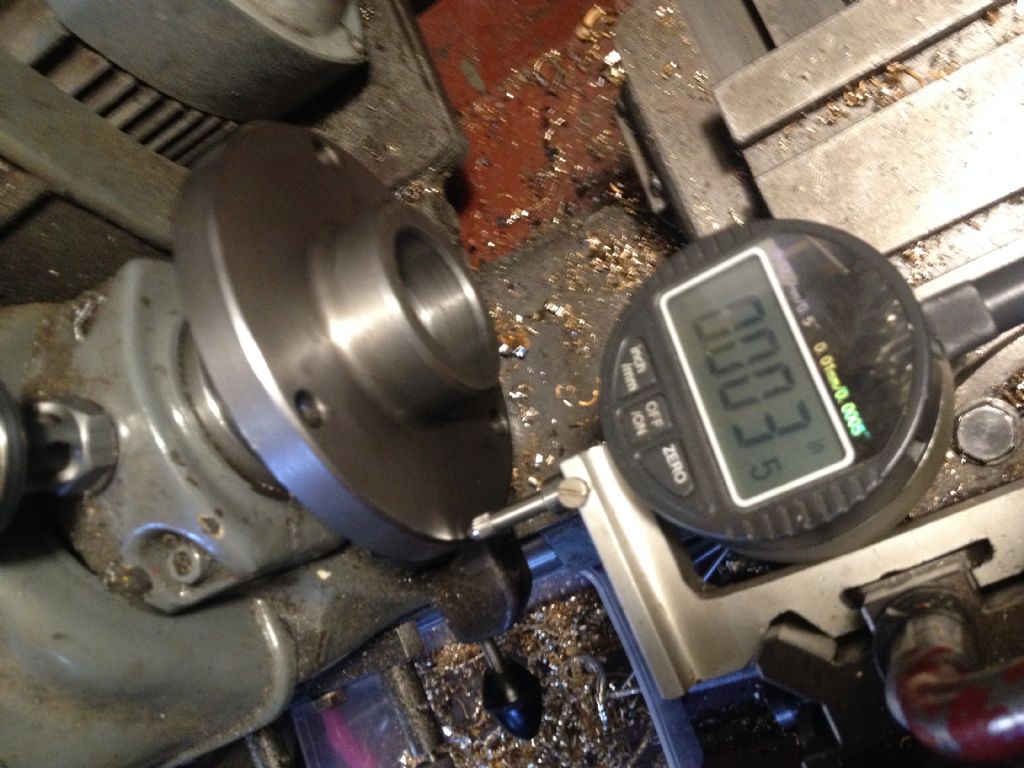

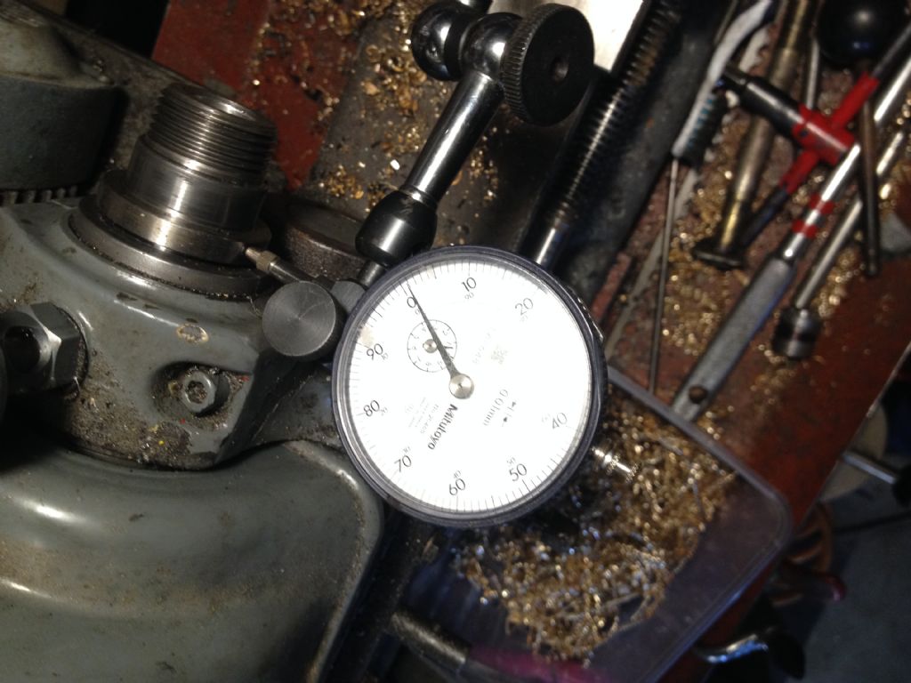

                                              John F – Good point about where the indicator stalk is on the head stock. I did it again against the register and there’s no movement in the gauge.

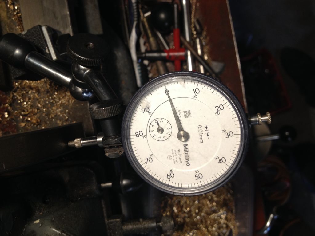

                                              also checked the back plate on the outer edge. Photo shows maximum…
                                              The back plate came with the lathe & chuck. It came from a retired engineer who’d had it in his home workshop. He was real precious about it, wouldn’t let his middle aged sons touch it (they’d both done fitter/turner apprenticeship) in case they damaged it. It looks very well made (better than I could do). It previously ran true, I’m not sure when it went out as I had several months away from the workshop. I was initially think all the round stock I had was oval (I’m a real beginner).
                                              Howard – the 4 jaw screws on fine, it’s only the 3 jaw & face plate which are tight.
                                              I put the backing plate on back wards, and tried the indicator on that…

                                                Here’s a photo of back plate thread…

                                                  The fact that you wre able to do that, apparently without effort [otherwise you would presumably have mentioned it] seems to confirm that the thread is as it should be … That is one of the reasons why I suggested doing that first.
                                                  You have now eliminated the thread from the list of suspects; without modifying it.
                                                  I think it's most likely that there is some barely measureable blemish on [or in] the parallel register area of the spindle nose [or the backplate]. Your indicator tests are looking good; but they cannot tell you everything, because the probe is only making point-contact [ish]
                                                  It's probably time to start applying some blue, and checking that register very thoroughly.

                                                    The thread looks good from here, and [as per my previous post] is best left untouched.
                                                    It may be a trick of the light, but … I think there is some scuffing on that parallel register, and that's where you need to focus your attention.
