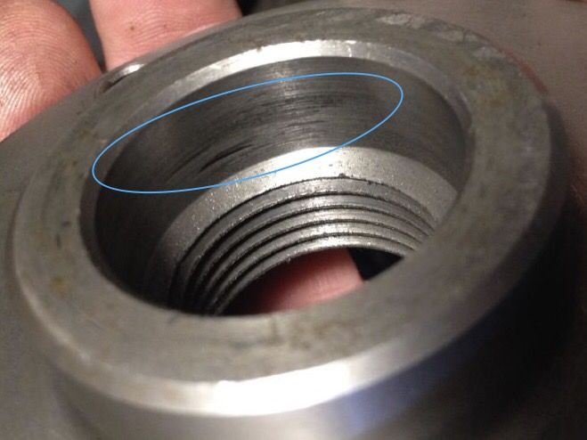

            Posted by Michael Gilligan on 30/07/2019 06:33:16:
            The thread looks good from here, and [as per my previous post] is best left untouched.
            It may be a trick of the light, but … I think there is some scuffing on that parallel register, and that's where you need to focus your attention.
            Am I alone in thinking that the problem area is visible in Grotto's last photo ?
            … I have identified the 'region of interest' in this cropped version:

              Posted by Michael Gilligan on 30/07/2019 22:59:47:
              Nay lad, tha c'd well be right. Possibly a raised lip on the lower edge of the darkest gouge about a pitch or two above the thread?

                Worth adding that in the first set of pictures there are scuff marks on the spindle register that might correspond. Difficult to know how serious they might be without copping a feel…

                    You're right about implying an event. I don't think those marks inside the backplate register could've arisen without one that involved some force beyond simple manual pressure.

                                  There is certainly a mark in the picture, it looks like the backplate was screwed on dry, and I always like just a tiny bit of oil when I change chucks.

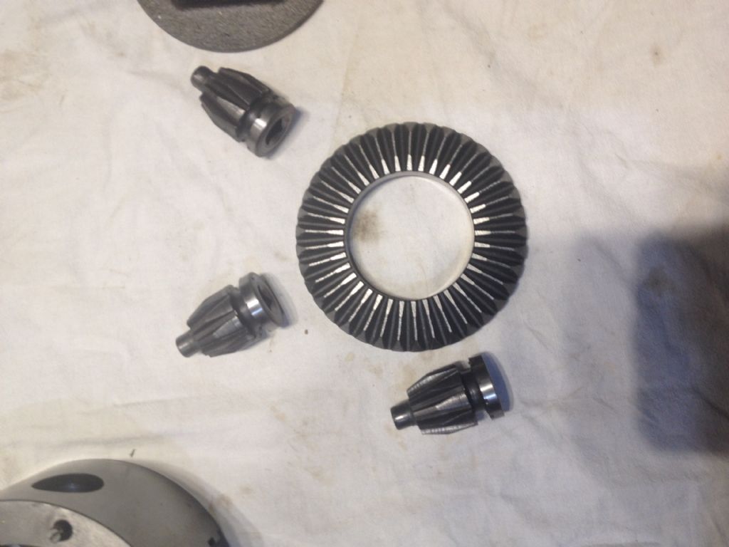

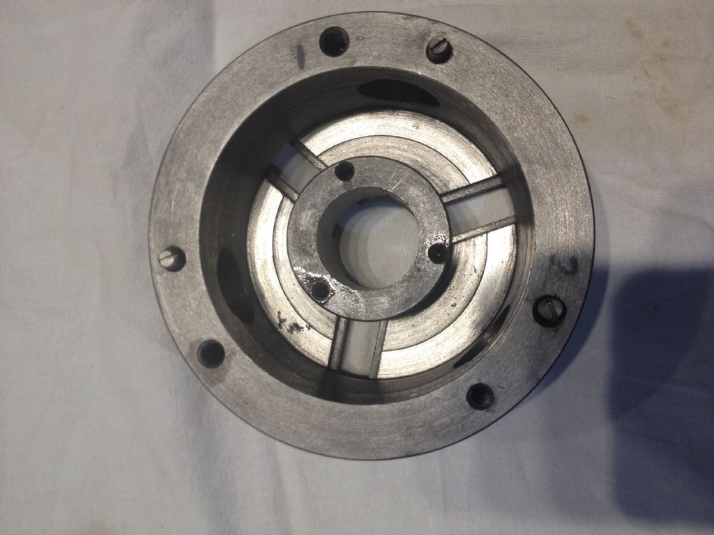

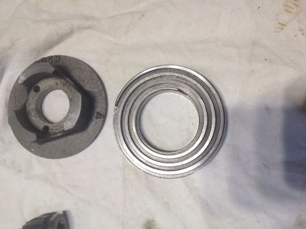

                                    Managed to get some time today, so pulled the chuck apart. No significant swarf, but gave it a good clean and lube and put it back together.
                                    It looks like some swarf has got between the scroll plate & chuck at some stage, but I don’t think this would cause issues.

                                      I’ve checked out the “area of interest” and there may be a minor “groove” but no raised area.
