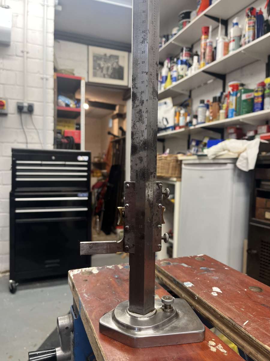

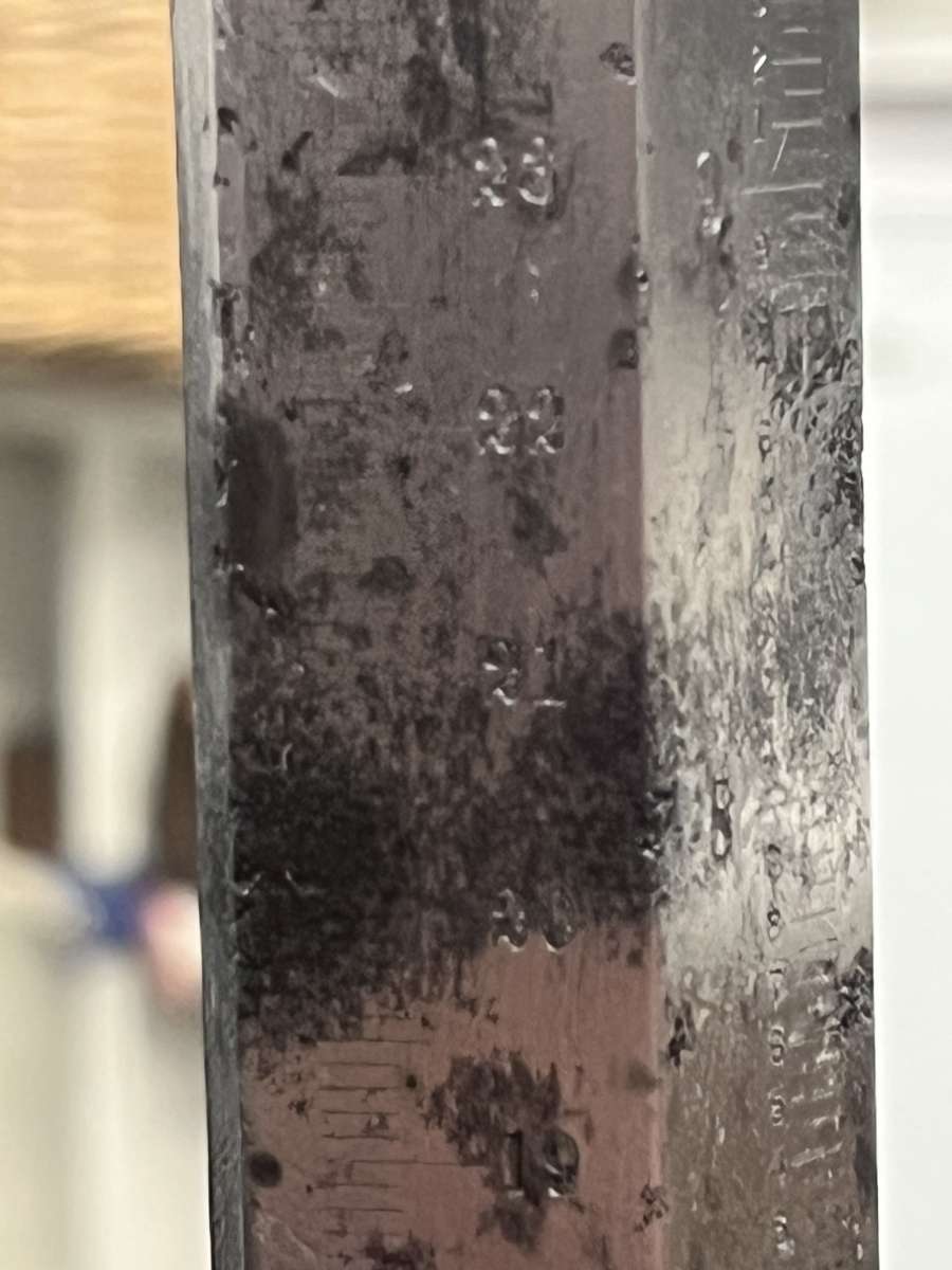

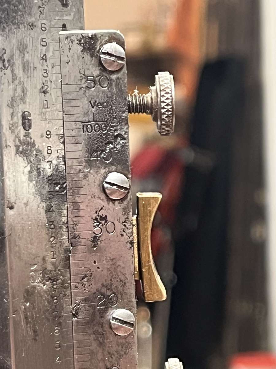

      I have been lucky enough to have been given a Chesterman Vernier Height Gauge, 60’s or 70’s era I would guess. It is still with its original box and most of the gauge has cleaned up well. Unfortunately there are a few areas of corrosion on the scales, I think I can live with this but just wondering if anyone has any suggestions about making the scales a bit clearer in the corroded areas.
      Thanks
      BobIMG_2423IMG_2424IMG_2425

        In my opinion that’s a bit more than corroded!
        #837417
          Probably better to use gauge blocks to set it than hope to do anything with that deep pitting.
          #837419
          cedric 1
            @cedric
            Apply some black paint and let it dry. Then lightly sand off the paint with wet rub paper and a wooden block. At least the lines will be a little easier to see.
            You might have to use a wire wheel in a Dremel to clear paint out of the pits,

                It might be possible to apply some rust remover gel to well degreased parts if Cedrics method does not work.

                    There is an imperial scale on one side and metric on the other, luckily the corrosion doesn’t line up so with a bit of arithmetic I can always used one scale or the other!

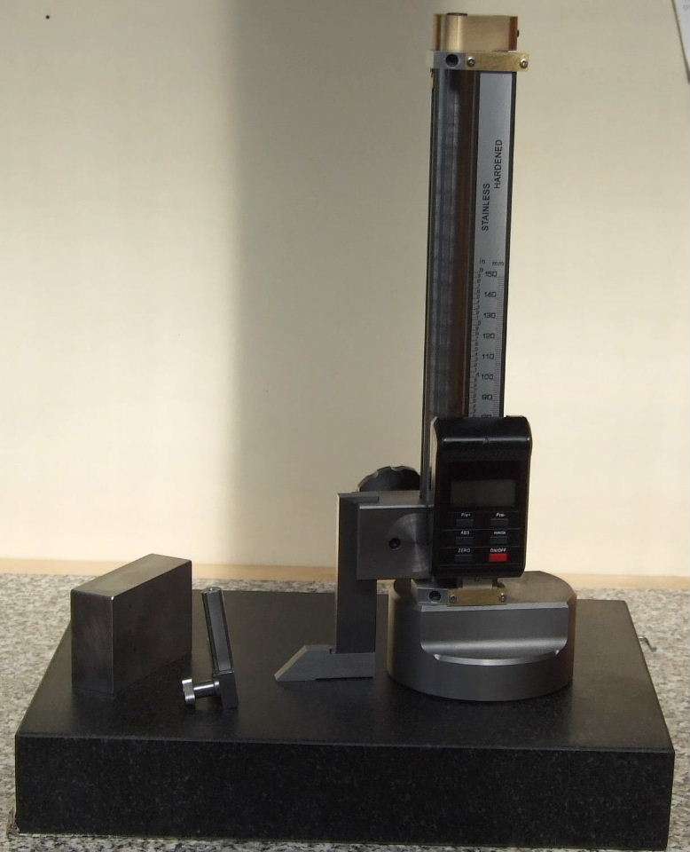

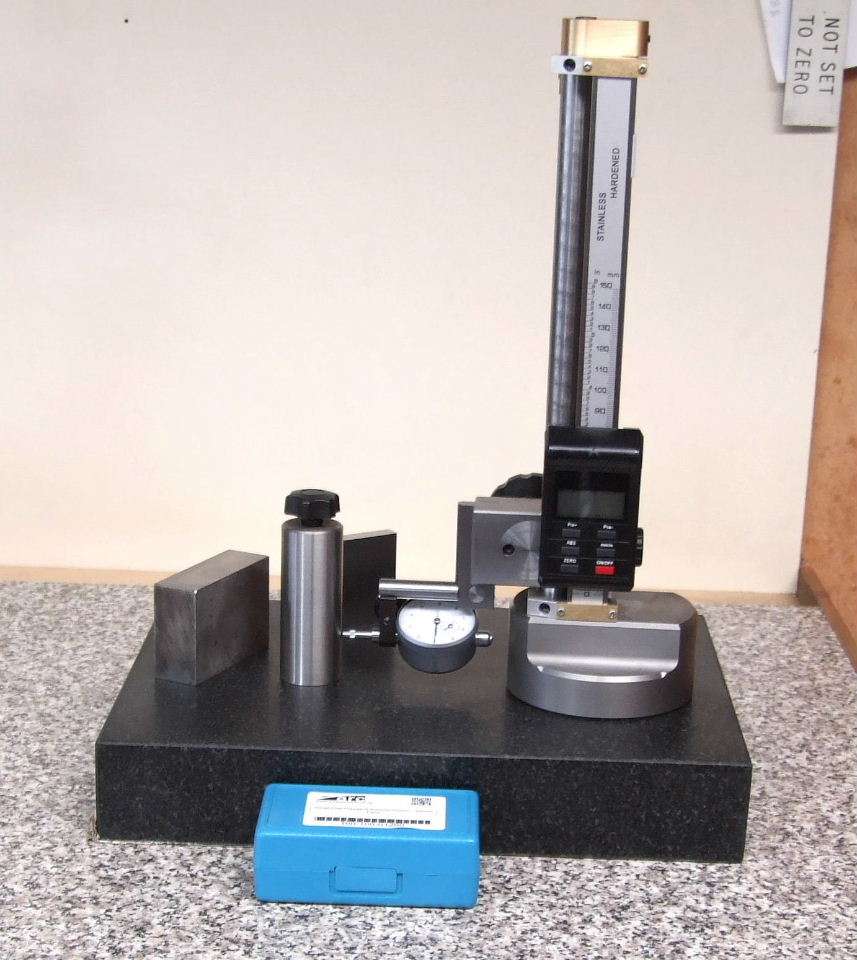

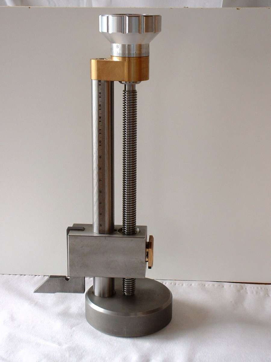

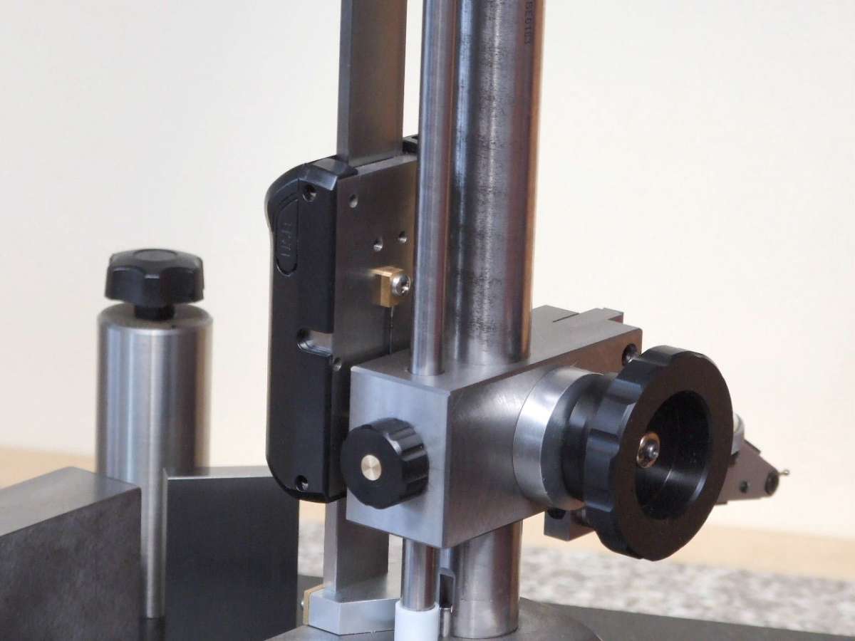

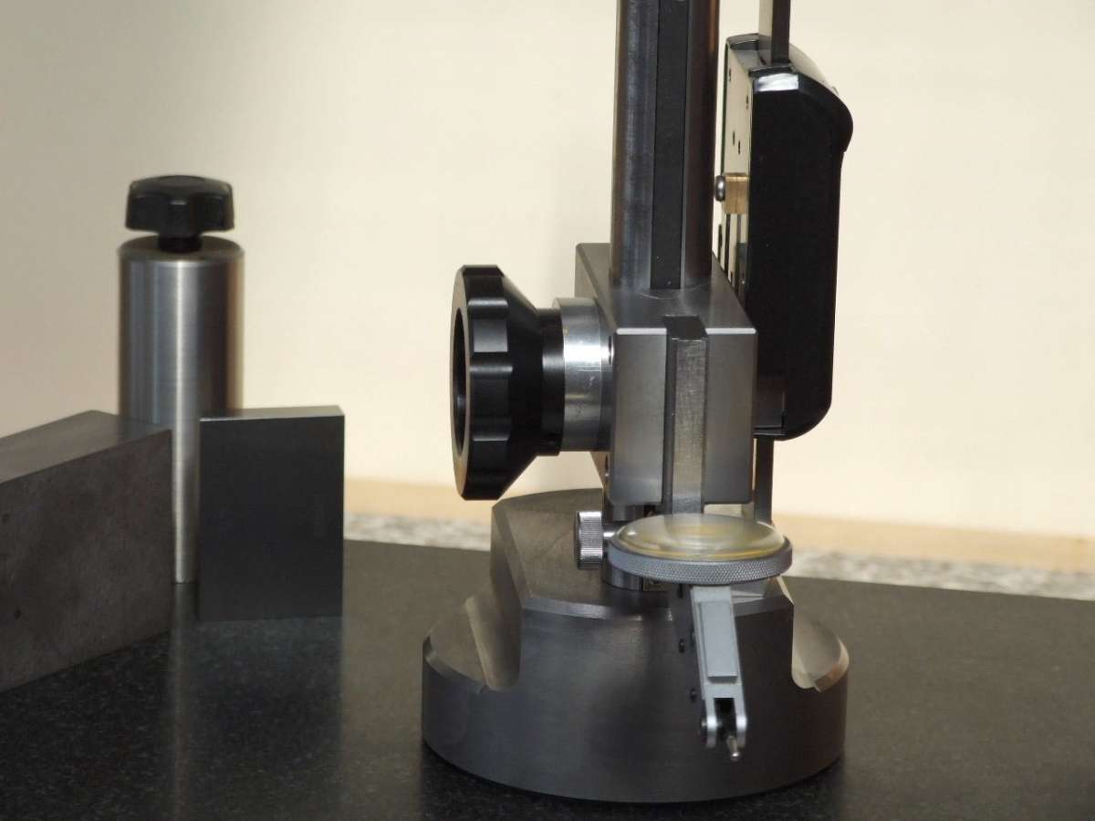

                      My tool of choice when marking out was always the “Microball” height gauge, 0-300, 0-600, or if you prefer 0-12″, 0-24″. With the blade of the height gauge built into the gauge. It is possible to take direct measurements off the surface table and micrometer accuracy. They were hard to beat for ease of use.
                      My twist on this design is shown below,
                      Fig 1 View from the users side

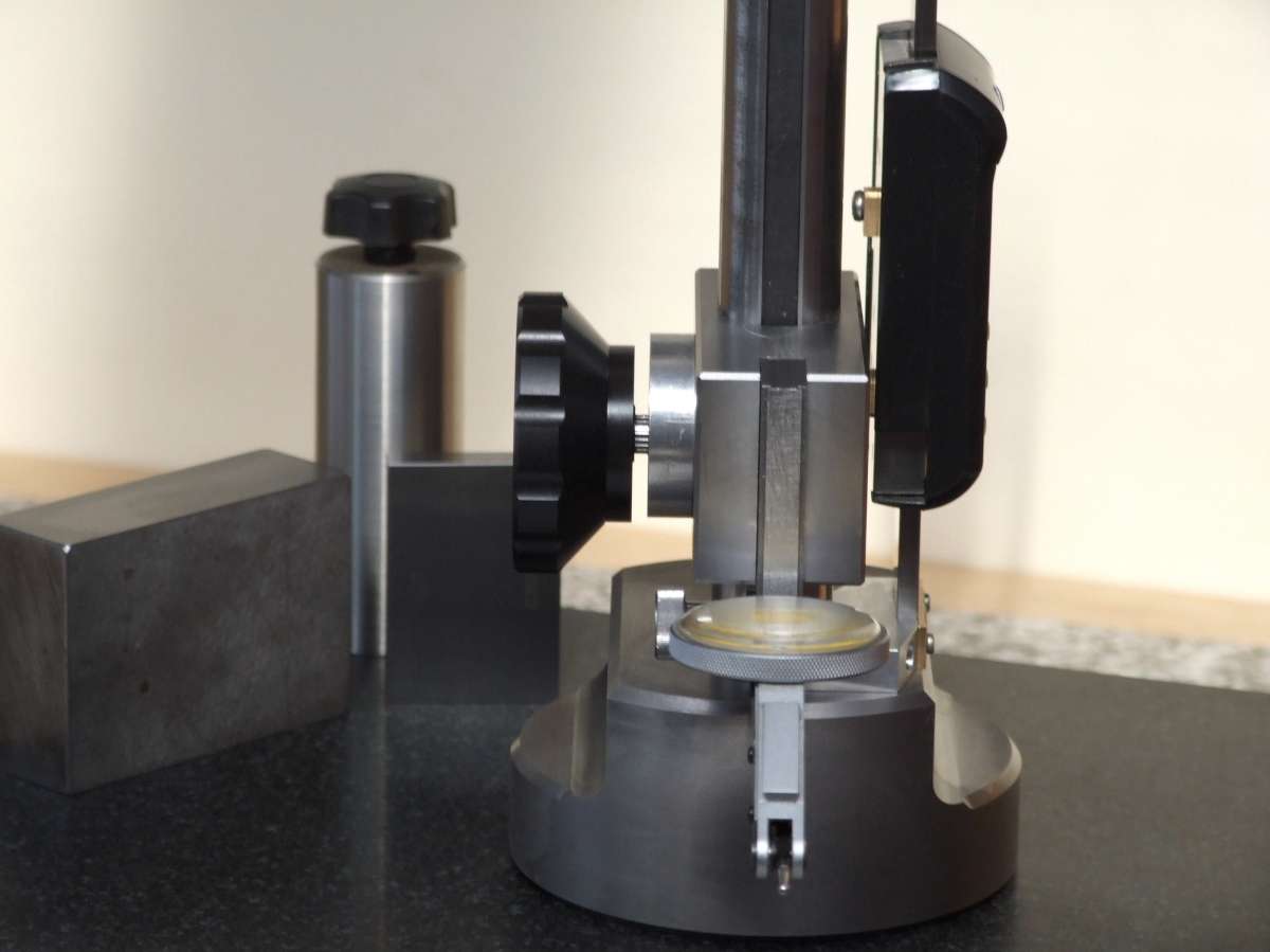

                      Or a more up to date version,
                      Scriber in place
                      Perpendicularity Check
                      Direct Drive Knob position
                      Reduction Drive 4 to 1
                      This last gauge was built to check perpendicularity as well and is fitted with a two speed drive. (handwheel in & handwheel out)
                      Regards
                      Gray,
                      #837450
                      Graham Meek
                        @grahammeek88282
                        How would I add a digital read out to it?
                        Sorry Bob,
                        Your post came in while I was typing. Digital scales like those fitted to a Digital Callipers can be had in various lengths. A couple of simple brackets to hold the scale could be made to grip the Chesterman vertical scale. The drive to the attachment needs to be kept simple to avoid putting any side load on the Slider
                        This is how I did my unit.
                        Slider to Read-out Connection
                        You will probably find the vertical style of scale like I used does not go above 150mm but the larger sizes which are like the conventional digital calliper would work.
                        Regards
                        Gray.

                            The corrosion on this example is quite bad. Maybe, something like citric acid will remove the blackening from the pitting; ,but the pots will remain there. Painting the scales, followed by CAREFUL sanding might leave the graduations still visible.
                            Unless there is wear, there should be no reason to be concerned about the accuracy.
                            It may not look pretty, but it will do what you want, which is the main thing, as long as the graduations are still clearly visible.
