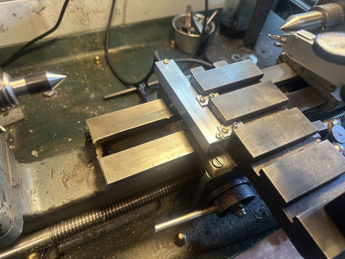

      Hi

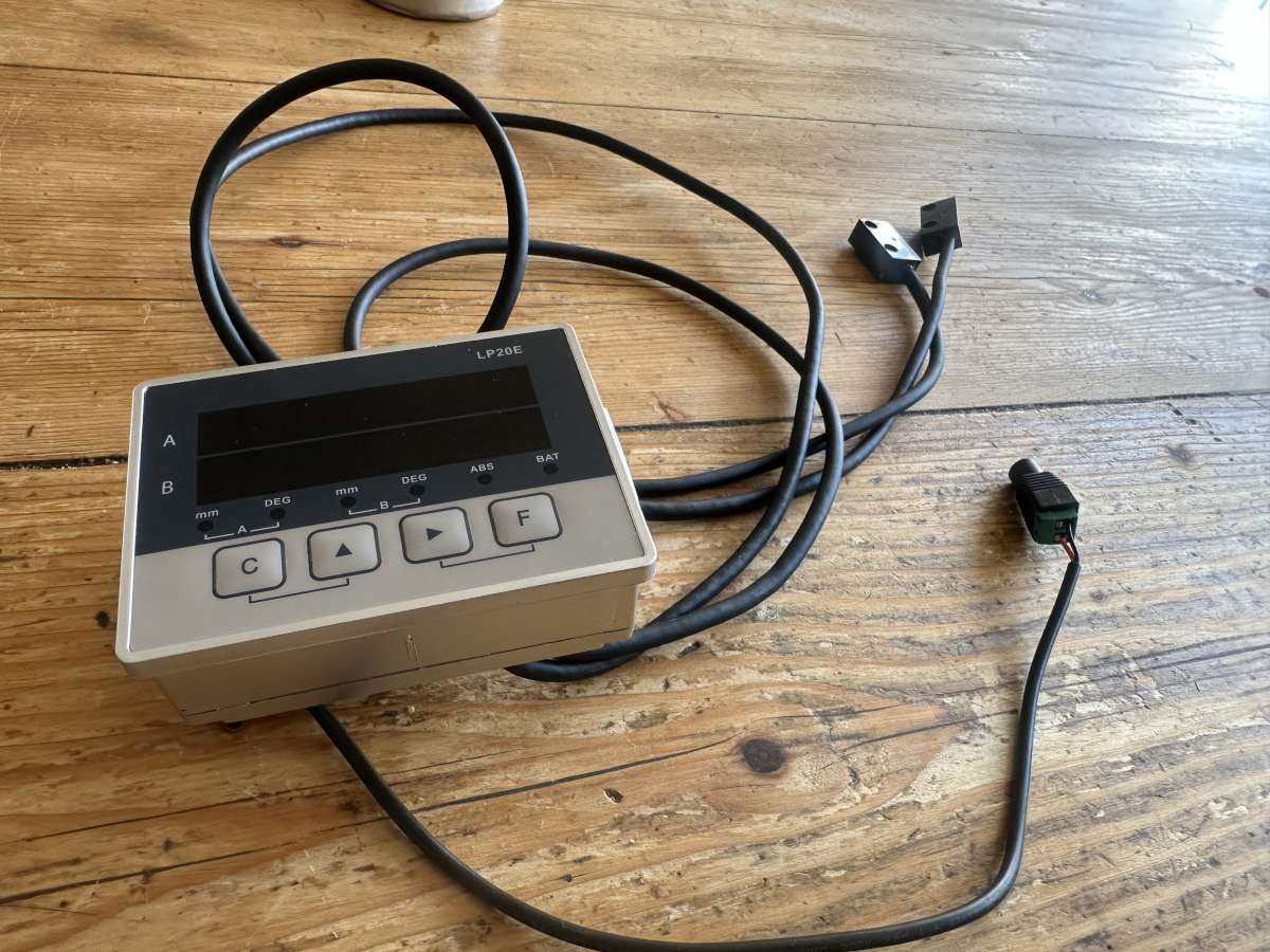

      I recently picked up a very cheap and probably not very cheerful Chinese DRO on AliExpress. I’m aware of its poor quality and limitations etc etc. However I have a little old Zyto lathe, and it has very small and poor scales on its axes – so I thought nothing ventured, nothing gained and it is do cheap that if it doesn’t work then I haven’t lost much. If it works I can make more accurate knobs and bushings etc than I currently do, which would be great.
      The reviews and installation videos I’ve seen usually seem to have problems with the magnetic scale – not that it isn’t accurate (although it isn’t very) but jumping problems, thought to be caused by magnetic interference or magnetic damage to the scale.
      So what I’m hoping to get here is any thoughts or advice.

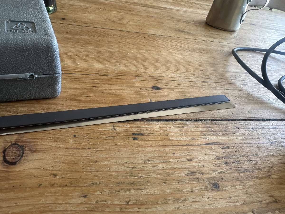

      1) It unexpectedly came with an adhesive-backed metallic strip alongside the expected magnetic scale. (See picture). No mention of this in the “instructions”. I wonder if this is to go beneath the scale to provide some kind of magnetic interference insulation?
      2) For the Z axis I can see how to attach the sensor to the carriage using the far side gib grub screws. Obviously if I want to adjust the gibs I’d need to take it off, but not a big deal. I’d can 3d print a bracket (very easy but it might wobble) or make one out of aluminium (also easy). Pros and cons?
      3) I’m not clear yet how I’ll attach it for the X axis. Let’s get one working for now.
      IMG_5609IMG_5610

        I think the strip is stainless steel and designed to go on top of the magnetic scale to stop it collecting swarf.  The DRO I have came with aluminium U channel and rubber seals which hold the metal strip in place. I would make the mounting bracket from aluminium rather than plastic.

          Probably best not to attach the bracket via the gib screws – honestly it will be a PITA, there are times when you will surely need to ‘snug them up a bit’ in the middle of some critical or unwieldy job, and the other issue will be that securing the bracket will probably upset the gib setting as you do it.
          It is absolutely ‘allowed’ to drill and tap a couple of small holes to allow fixing of measuring devices to a machine.
          If fixing into a casting (which is unlikely to be flat) you can use ali. washers filed to a wedge shape or stand-offs to keep things square.
          If freehand drilling, a steel block accurately drilled-through with the same bit and used as a guide will help keep holes perpendicular.

            Wink – thanks for the tip, I’ve now seen that setup online. Your comment makes sense, I’ll resin print a “track” to put the mag strip in and top off with the stainless strip.
            Diogenes – I would agree, but 1) it’s effectively an antique and I’m loathe to drill random holes in it. And 2) I’m not at all convinced that this DRO will be a permanent fixture. The lathe is about 90 years old. The DRO probably won’t last more than a few years, if it works at all.

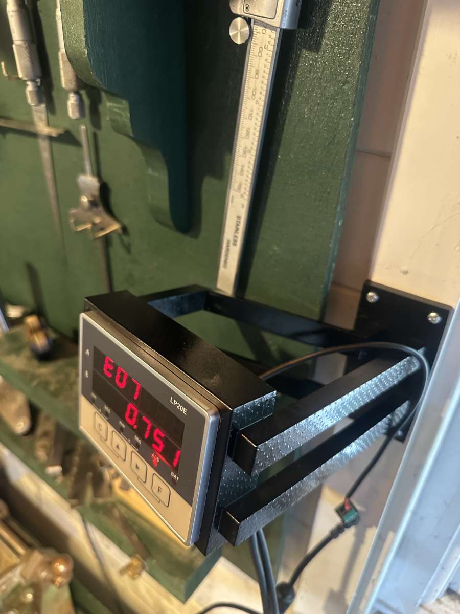

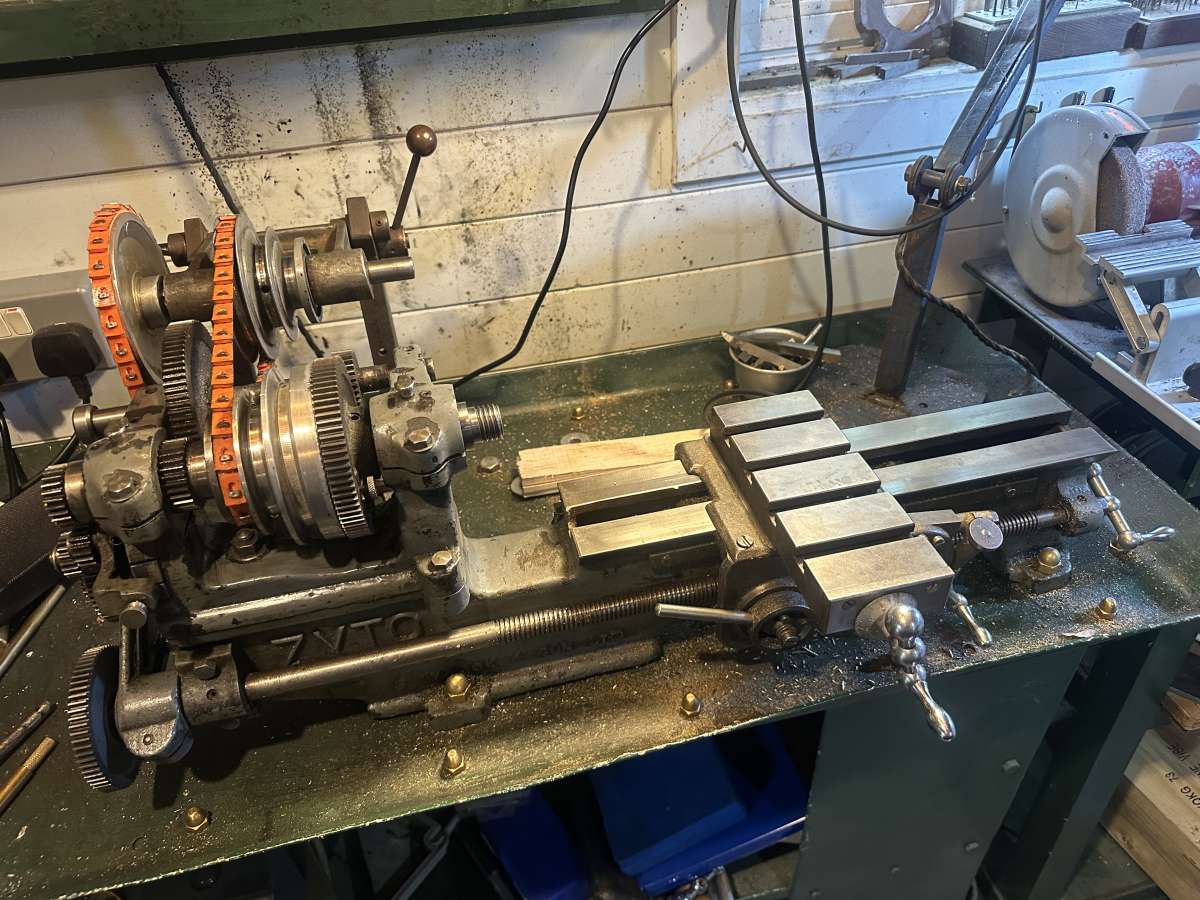

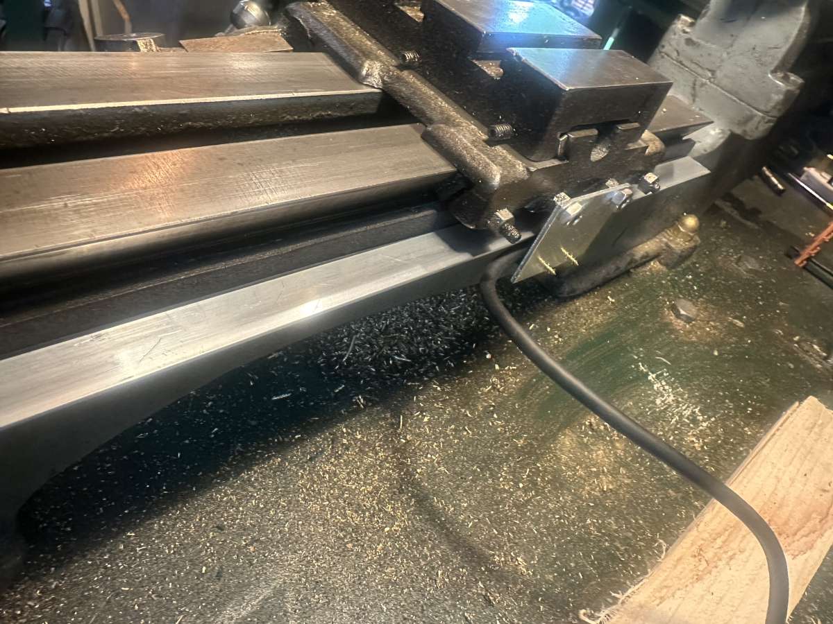

            #811933
            Steve355
              @steve355
              A certain amount of success so far… only done the long axis, but perhaps that’s all I want, the cross-axis is much easier to measure with a micrometer.
              From the front, it can’t be seen at all.
              From the back, it’s attached to the lathe bed with various types of tape, and to the carriage by adding a couple of nuts to some gib screws.
              3d printed bracket at eye height.
              Terrible instructions, not much thought put into UX. But it seems to work.

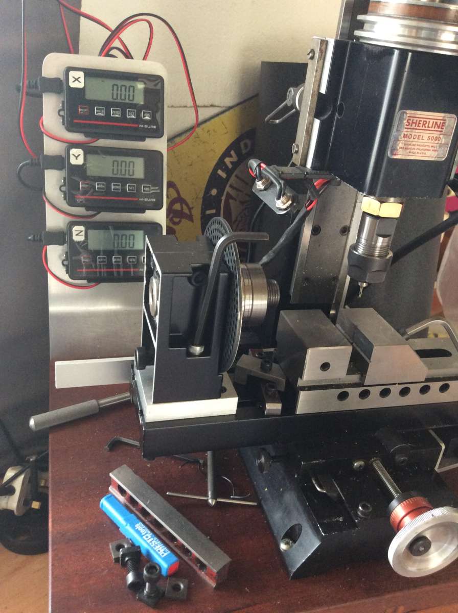

                      I converted my Sherline mill about a year ago using scales and displays from Arc but found batt consumption troublesome so fitted dummy wired 2032s and plugged into a wall wart with 4 usb outlets and so far so good.IMG_3952

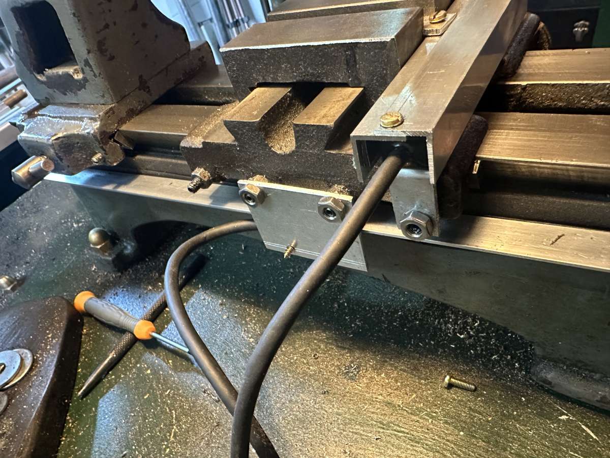

                                        Progress for anyone interested…
                                        I managed to work out a non destructive, fairly neat way to attach the DRO to the cross axis. In particular I was pleased with using little grub screws inside T-slots to secure something to the side.
                                        Looking at the back, you can see the gib screws being hijacked to hold the DRO on without drilling holes. It really isn’t a problem, even if the gibs need adjusting, which is once in a blue moon.
                                        overall it has an accuracy error of about 10%. That sounds appalling, but it is consistent, and seems to be expected, with a compensation value in the DRO menus.
                                        So far, so good. The only thing left to do is to work out a way to permanently fix the long axis. At the moment it’s held on by tape, which actually seems to be working fine, but it can’t really stay like that. The question becomes, do I try to work out a non-destructive way to do it, or do I drill a couple of holes in the back of a lathe.
                                        Anyway, I’m looking forward to using it to do the internal threading on the new back plate as mentioned in the other thread.

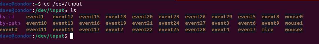

                                          Well I have too many projects already, and am as sick as dog!  But here’s a starter.

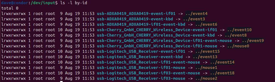

                                          In UNIX (including RasperryPi Linux), almost everything is a file.  That includes the mouse, so somewhere in the system is a ‘file’ that reports mouse movements.  The file can be read by a program in the usual way.
                                          Where’s the file and what is it called?   The mouse is an input device, so look in the directory “/dev/input”
                                          devinput
                                          Those event files are input streams for the keyboard, mouse and other devices.  You can identify which is which by long listing the by-id directory:
                                          Screenshot from 2025-08-19 18-29-57
                                          As can be seen my system has two mice.  The Cherry is the old one and I’ve forgotten to unplug it’s USB wifi receiver.  My current mouse is the Logitech, not sure why but it has two event files, event14 and event18.   I guessed event14 is the one!

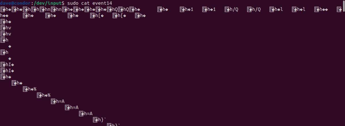

                                          To test it, I read the file with sudo cat /dev/input/event14.  (sudo runs cat with super-user privileges.)
                                          Screenshot From 2025-08-19 18-48-31
                                          Nothing happens until I move the mouse, when a flood of weird characters appear.  That’s because the mouse speaks binary, and the screen display program understands characters – it’s baffled!

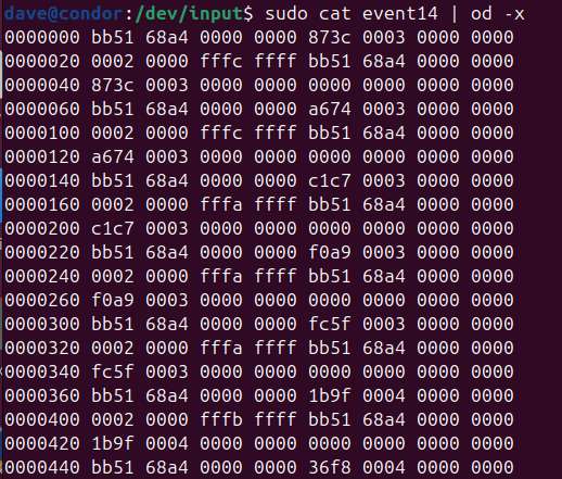

                                          Piping the binary to character utility helps a little with ‘sudo cat event14 | od -x’:
                                          Screenshot from 2025-08-19 18-59-37
                                          Mouse events present as a stream of 192 bit binary data structures that have to be decoded:

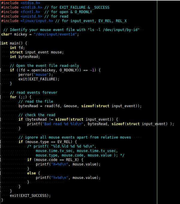

                                            Had some bother last night with the program needed to read mouse movements, mainly because I chose the wrong event file on my laptop.  Here’s the code:
                                            mousec
                                            More code needed to turn it into a DRO, notably setting the zero reference and converting relative mouse movements into absolute values.   Have to be tested too: if the mouse is moved slowly, a +1 or -1 event is issued.  If the mouse is moved rapidly, several increments are combined, so events report larger jumps, such as -4.   Speed and latency may be issues : a DRO that lags behind reality and/or reports changes as a series of large jerks wouldn’t be acceptable.   Performance seems reasonable with my wireless mouse, but:
                                            • the wifi link slows down
                                            • the mouse snoozes to save power when it’s not moved for a while, and takes time to wake up when touched. Performance seems OK, but a wired mouse should be faster – always on.
                                            • my posh mouse can change resolution up to 8000 dots per inch.  Gut feel, low resolution events are probably faster than high, but I don’t know if the speed difference matters.  Experiment needed.
